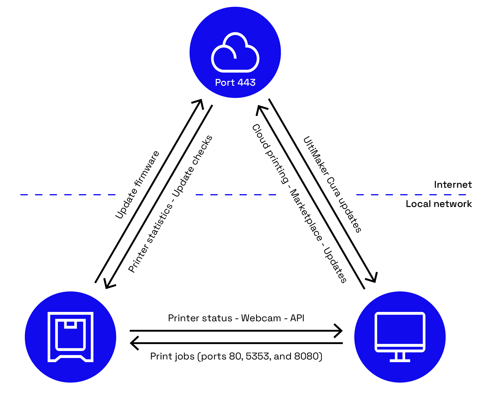

The UltiMaker Digital Factory and the communication with your printer utilize both the internet and the local network. Setting up the network for UltiMaker 3D printers and the Digital Factory may require some additional exceptions and permissions in your environment.
Ports - Which ports should be open?
To benefit from the full features of the UltiMaker Digital Factory, it is important that there is nothing hindering the communication between the cloud, printer, and the device running UltiMaker Cura. The UltiMaker ecosystem uses ports as follows:
Communication with cloud servers
For cloud communication, the following ports need to be open:
  • Port 443 – Encrypted https communication between the cloud server and the printer.
  • NTP port 123 – The printer fetches the correct current timestamp using NTP port 123. The correct current timestamp is needed on the printer to establish a cloud connection.
  • Port 32118 – When signing in from UltiMaker Cura, the application creates its own local web server via http://localhost:32118. This web server handles the authentication that takes place when the user logs in from Cura. This port must not be blocked on the local computer.
  • TCP port 53 on 1.0.0.1 – UltiMaker 2+ Connect only. The UltiMaker 2+ Connect utilizes this port for a communication check.
Communication on the local network
On the local network, ensure that ports 80, 5353, and 8080 are open to allow communication between the UltiMaker printer and UltiMaker Cura. The ports are used as follows:
  • Port 5353 – Printer discovery, allowing UltiMaker Cura to detect local network printers.
  • Port 80 – Printer control.
  • Port 8080 – Camera feed.
  • NTP port 123 – Timestamp.
Note: Port 22 is used for SSH communication with your printer. This port is closed by default on the printer and is only opened when developer mode is enabled.
