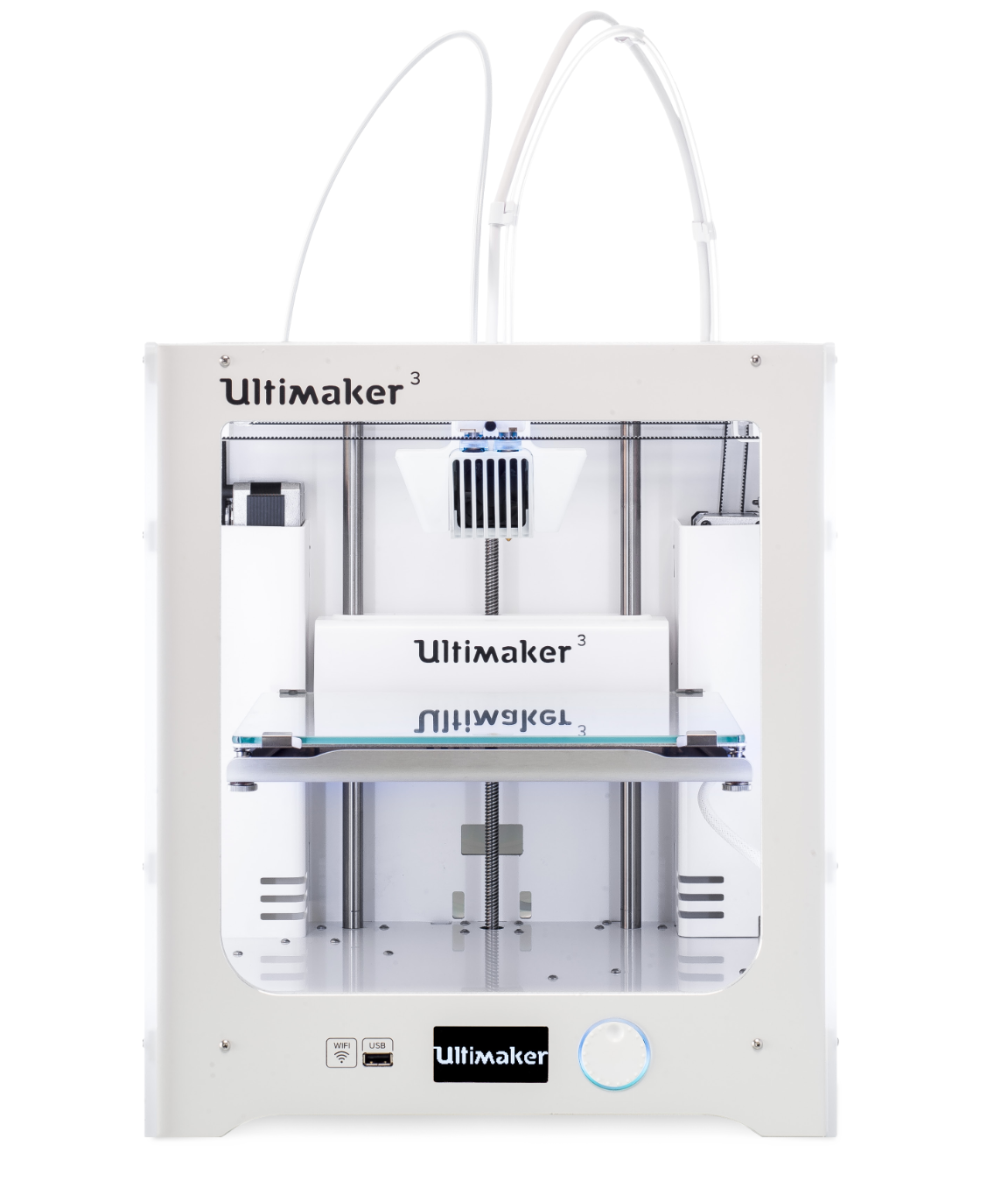

This article describes how to update the firmware on your UltiMaker 3 or UltiMaker 3 Extended. However, please note that no new versions have been released for quite some time. As the UltiMaker 3 series is now fully discontinued and no longer supported, no additional firmware versions will be released.
