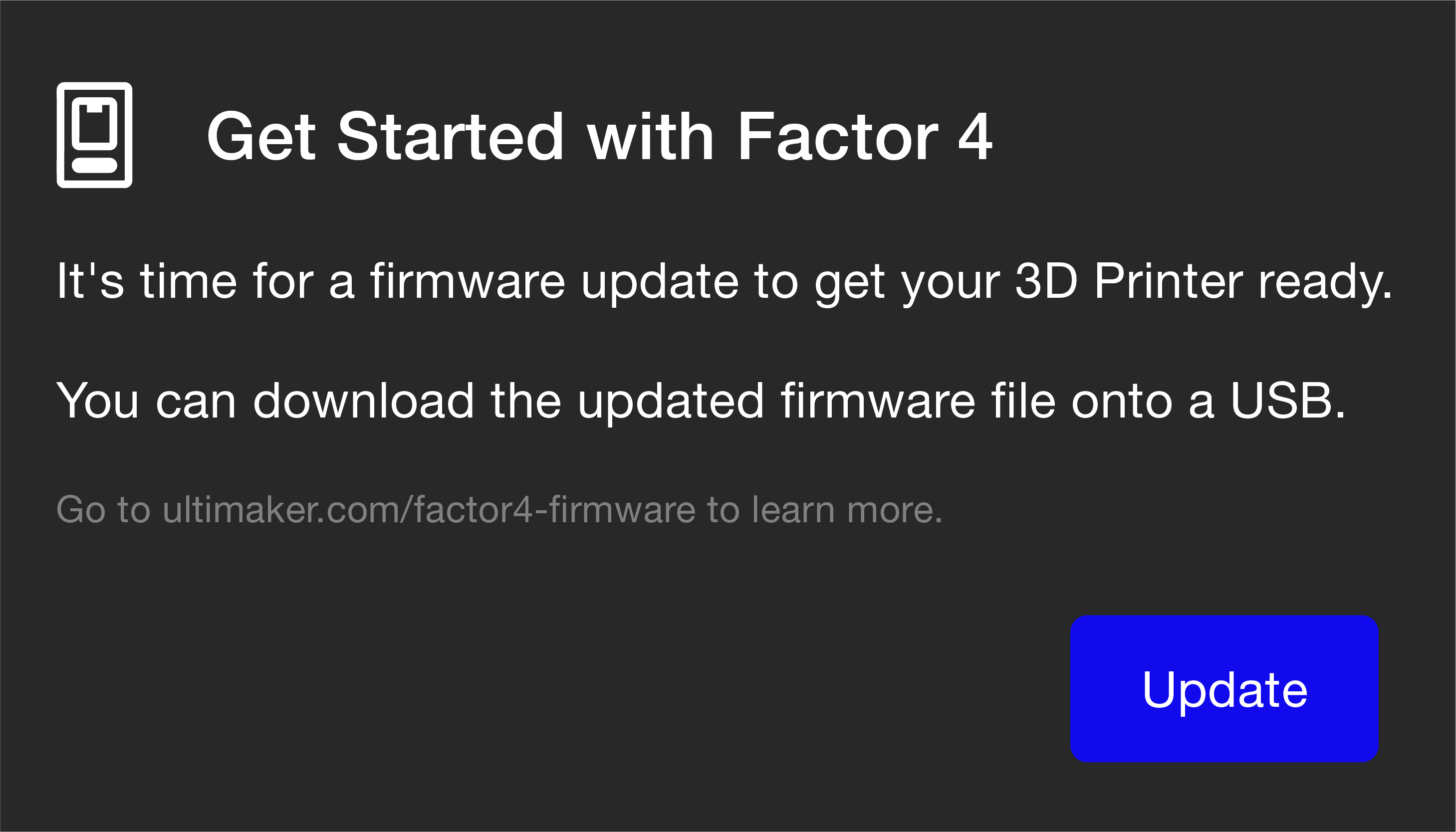

To ensure you have the best first-run experience with your new 3D printer, the firmware must first be updated to the latest version. If you are one of the first UltiMaker Factor 4 owners, you will see the screen below when you turn on the machine for the first time. The link directs you to this page.
Before you can get started with the guided welcome setup, update the printer's firmware via USB. You will need a USB drive (32 GB max.) and the firmware file (.swu). Take the following steps to update:
  1. Download the firmware file via one of the links shown above.
  2. Place the firmware file (.swu) in the root directory of a USB drive.
  3. Insert the USB stick into the USB port of your printer.
  4. On the UltiMaker Factor 4 display (see the screen above), select Update.
  5. In the next screen, select the firmware file to begin the update process.
  6. Wait for the UltiMaker Factor 4 to finish updating the firmware. The printer will restart.
Note: Never remove the USB stick and never power off the printer during the installation.
After installing the supported firmware, the printer will guide you through the welcome setup, and you can then start your first print. Future firmware updates can be installed via the normal processes (either via the network or via USB) as described above.
