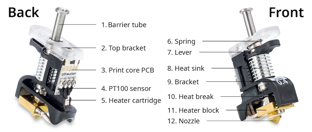

What is a print core?
A print core is a compact hot end, which can be exchanged without any tools. The print cores contain the nozzle, heater block, heater and sensor, and a small EEPROM chip. The filament is heated up inside the print core and extrudes from the nozzle. There are several types of print cores, which may look a little different, but all contain the same kinds of components:
Print core parts
  1. Barrier tube. This part guides the filament from the end of the Bowden tube into the hot end.
  2. Top bracket. You hold this part when inserting or removing the core. It is transparent to show the LED to indicate the core's status.
  3. PCB. This board connects to the PCB inside the print head. The EEPROM chip contains information about the print core type, nozzle size, and printing hours.
  4. PT100. (right) This sensor registers the nozzle temperature.
  5. Heater cartridge. (left) Heats up the nozzle.
  1. Spring. This spring compresses to allow nozzle lifting and exchanging the print core.
  2. Lever. Squeeze this lever upward to compress the spring when removing or inserting the print core.
  3. Heat sink. The ridges help cool the print core, to prevent the heat from traveling too far upward.
  4. Bracket. The 'body' of the core. The type and nozzle size are printed on the front.
  5. Heat break. This thin aluminum part prevents the heat from the nozzle from traveling upward.
  6. Heater block. This part is heated up during printing to the material-specific temperature.
  7. Nozzle. Material extrudes from the nozzle. Different types and sizes are available.

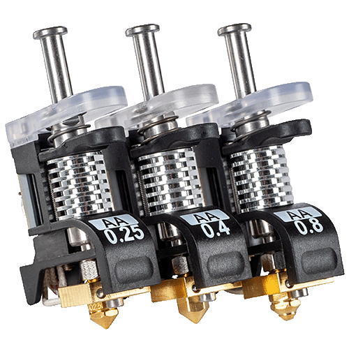

Print core AA
Download product data sheet
  • 0.25 mm
  • 0.4 mm
  • 0.8 mm
  • UltiMaker 3
  • UltiMaker S3
  • UltiMaker S5
  • UltiMaker S6
  • UltiMaker S7
  • UltiMaker S8
  • Factor 4
  • Factor 4 Plus
The AA print core is compatible with all (non-abrasive) UltiMaker build materials, such as PLA, PETG, and ABS, as well as Breakaway support material.

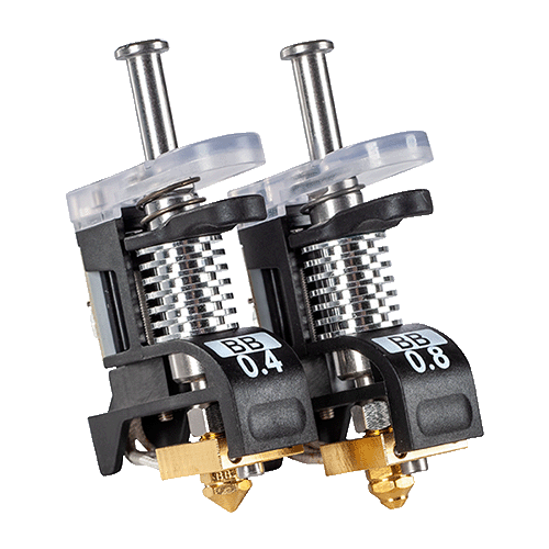

Print core BB
  • 0.4
  • 0.8 mm
  • UltiMaker 3
  • UltiMaker S3
  • UltiMaker S5
  • UltiMaker S6
  • UltiMaker S7
  • UltiMaker S8
  • Factor 4
  • Factor 4 Plus
The BB print core is intended for support materials. It was originally developed for PVA (water-soluble support material), but can also be used for Breakaway support material.

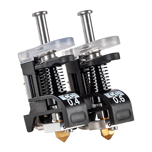

Print core CC
  • 0.4
  • 0.6 mm
  • UltiMaker S3
  • UltiMaker S5
  • UltiMaker S6
  • UltiMaker S7
  • UltiMaker S8
  • Factor 4
  • Factor 4 Plus
The CC print core is designed for use with composite materials, such as UltiMaker PET CF and Nylon CF Slide. Find other compatible third-party materials in the Marketplace.

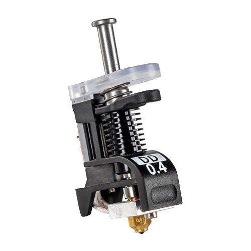

Print core DD
  • 0.4 mm
  • UltiMaker S3
  • UltiMaker S5
  • UltiMaker S6
  • UltiMaker S7
  • UltiMaker S8
  • Factor 4
  • Factor 4 Plus
The DD print core is specifically intended for Ultrafuse® Support Layer material, used in the Metal Expansion Kit.
Note: The DD core is not available in all regions.

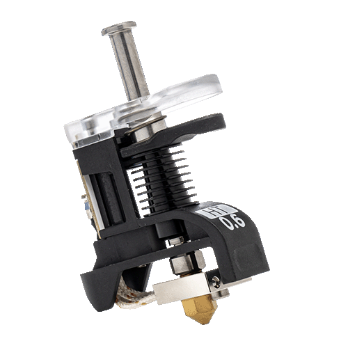

Print core HT
  • 0.6 mm
  • Factor 4
  • Factor 4 Plus
The HT print core is optimized for high-temperature materials, such as UltiMaker PPS-CF.

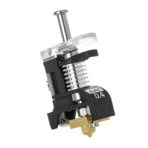

Print core AA+
  • 0.4 mm
  • UltiMaker S6
  • UltiMaker S8
  • Factor 4 Plus
Designed for high-speed, high-flow printing, the AA+ print core increases productivity and ensures reliable, high-accuracy prints across a wide range of materials.

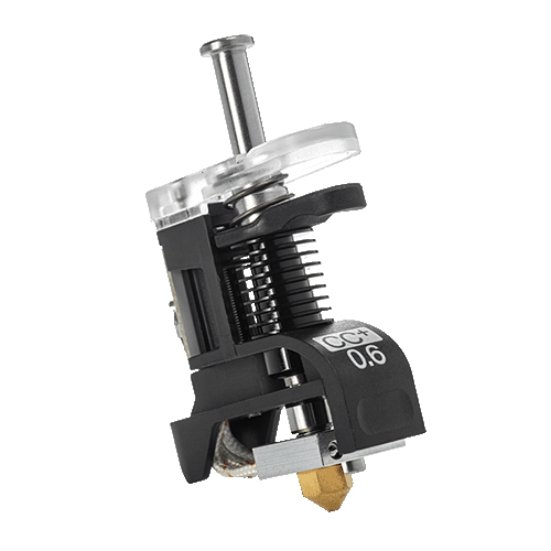

Print core CC+
  • 0.6 mm
  • UltiMaker S6
  • UltiMaker S8
  • Factor 4 Plus
Featuring a wear-resistant, hardened steel nozzle, the CC+ print core is engineered for printing abrasive composite materials at high speeds.
