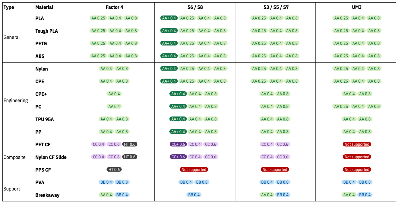

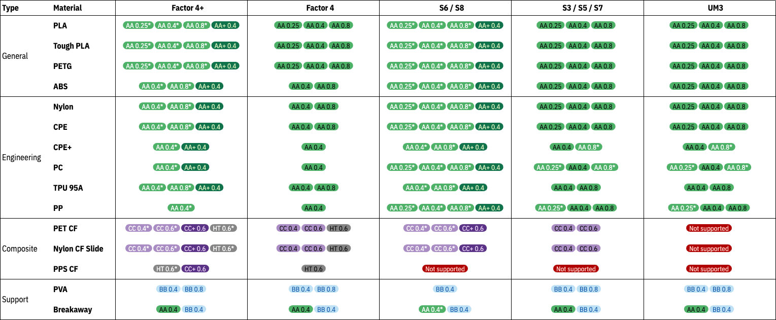

Compatibility table
Note: All listed combinations marked with * only have experimental profiles available. For more information about why certain profiles are experimental, please see this article.
Downloads
Compatibility overview (single table)
Compatibility overview (detailed matrix per printer)
