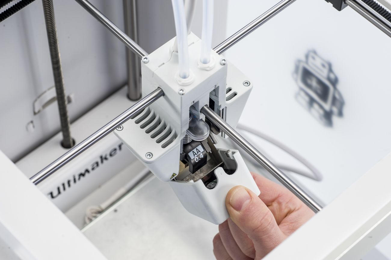

  1. Open the print head fan bracket and press Continue.
  2. The Ultimaker 3 will now automatically detect the print core (AA) that is placed in print head slot 1. Confirm to continue.

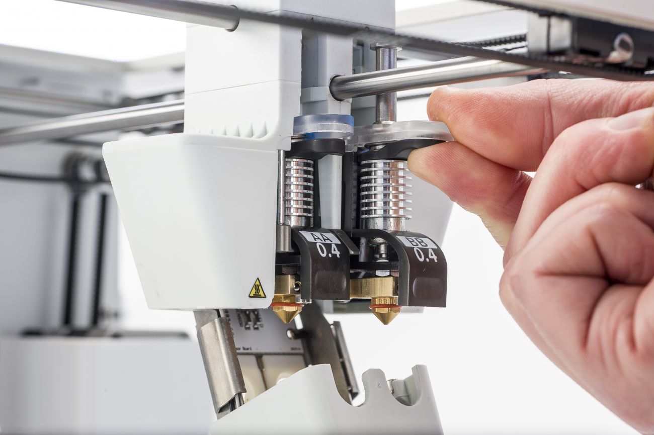

  3. Install the BB print core in print head slot 2 by squeezing the black lever upward and sliding it into the print head.
Note: Never touch the contact points at the back of the print core with your bare hands, as oils and grease can affect the connection.
Tip: Make sure you keep the print core completely vertical while installing it so it will smoothly slide into the print head. If the core does not fully click into place, give it a gentle push.
  1. The UltiMaker 3 should now automatically detect the print core that is placed in print head slot 2. Confirm to continue.
  2. Close the print head fan bracket and confirm to complete this part of the welcome setup.
