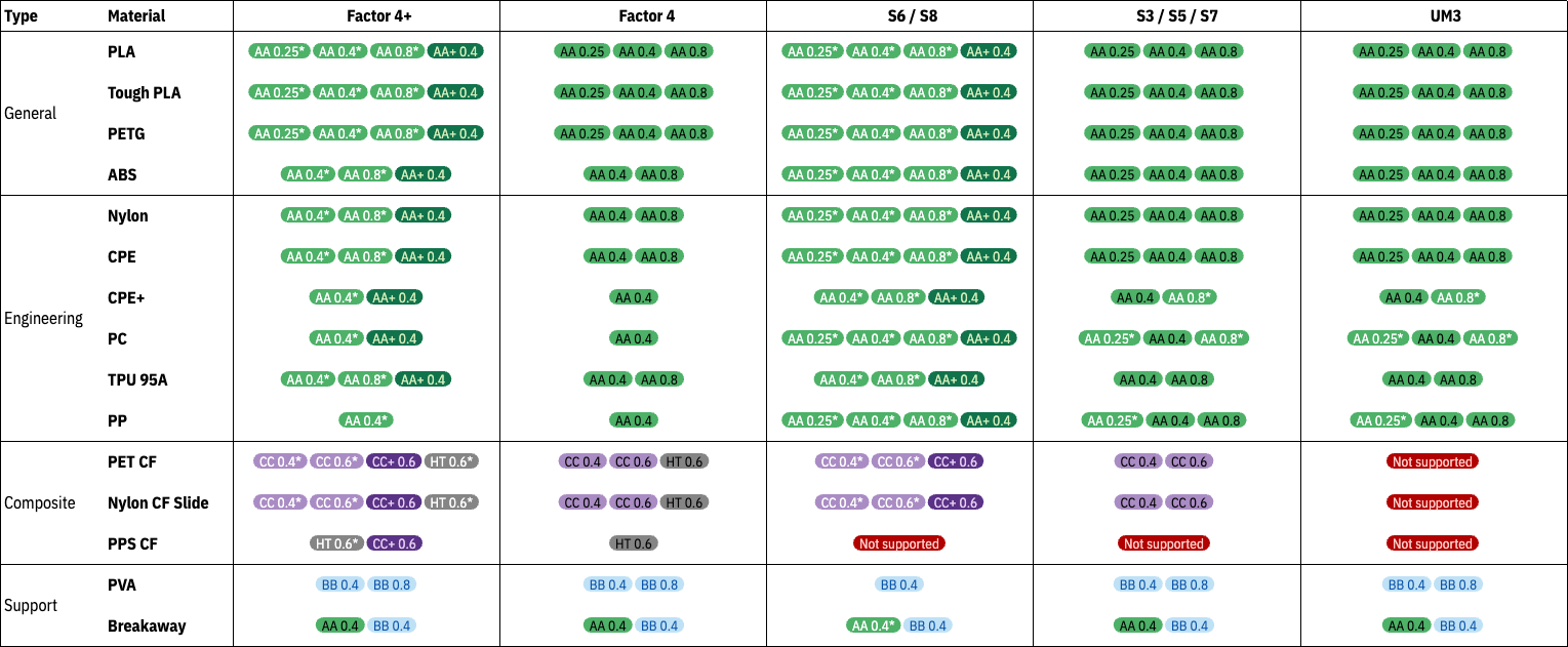

Printer, print core, and material overview
This table shows a comprehensive overview of all UltiMaker materials, their compatibility with the different UltiMaker 3D printers that use print cores, and which nozzle sizes can be used.
Note: All listed combinations marked with * only have experimental profiles available. For more information about why certain profiles are experimental, please see below.
Note: The printer and print core compatibility can change with newer versions of UltiMaker Cura.
Tip: Download the compatibility overview shown above as a quick-reference PDF, or see this detailed matrix PDF.

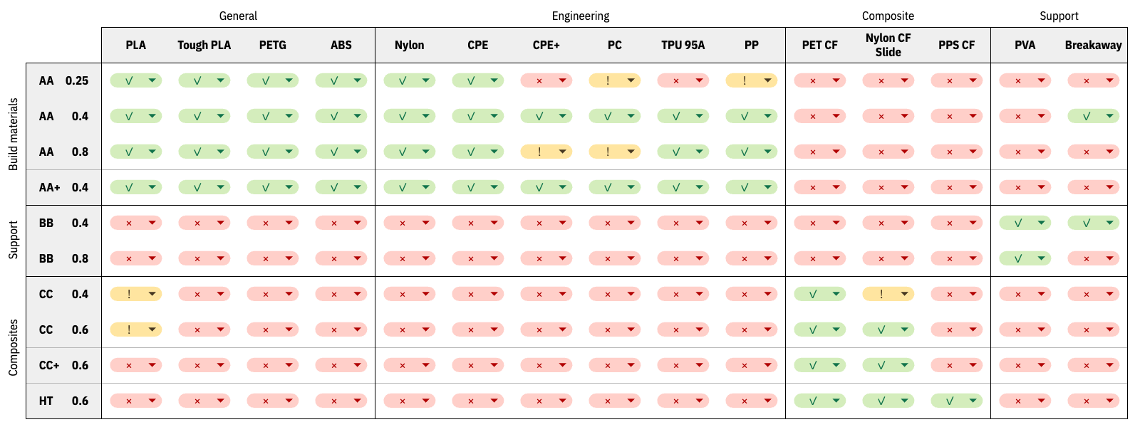

Detailed material and print core compatibility overview
This overview shows specifically for each print core and material which combinations are supported. This also includes experimental configurations.
Note: Not all combinations may be available on all printers; please see the printer compatibility table above.
Tip: The icons in the table reflect the compatibility and support of the combination. Officially supported ( ✓ ), not supported ( × ), or experimental ( ! ).
Notes on experimental combinations:
  • AA 0.25 and PC: This configuration can be selected, but may not work well for all models.
  • AA 0.25 and PP: This configuration may lead to extrusion problems for PP on certain models.
  • AA 0.8 and CPE+: The 0.8 print core can work well for certain models. However, more complicated prints, with tiny features or a large build plate surface, may show increased warpage or oozing.
  • AA 0.8 and PC: The 0.8 print core can work well for certain models. However, more complicated prints, with tiny features or a large build plate surface, may show increased warpage or oozing.
  • CC 0.4 / 0.6 and PLA: Preparing prints for PLA with the CC print cores is possible on S and Factor Series printers. The CC cores are not normally optimized for low-temperature, non-abrasive build materials, but experimental profiles are available.
  • CC 0.4 and Nylon CF Slide: For Nylon CF Slide, this small nozzle size is only recommended for small prints with a high level of detail, since it is prone to partial clogging and under-extrusion. Make sure to frequently clean the print core with a hot and cold pull.
Notes on not supported combinations:
  • Profiles: For the unsupported combinations, no profiles have been developed. In the Print settings panel, you will see a 'Configuration not supported' message instead of selectable profiles.
  • Not recommended: Most of the configurations listed as 'not supported' will not prevent you from slicing in UltiMaker Cura. For these, you will see a yellow exclamation mark icon in the Configuration panel. This includes combinations such as any general-purpose materials (e.g. PLA) with the BB or CC print cores.
  • Not allowed: Certain combinations may not be selected in Cura. For these, damage to the printer or print core is likely. You will see a red cross icon in the Configuration panel, and an 'Unable to slice' message will appear if you try to slice the model with this configuration. This includes combinations such as composite materials with AA and BB print cores, which are not abrasion-resistant.
