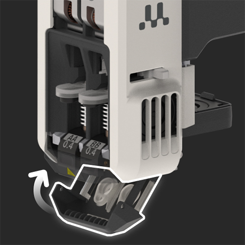

  3. Gently open the print head bracket. Select Confirm when completed.

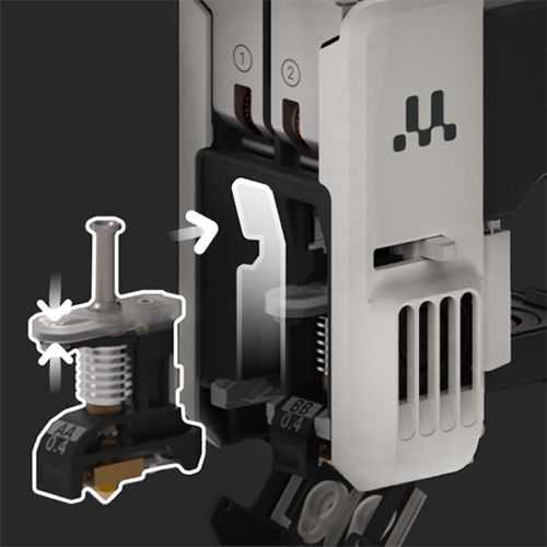

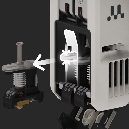

  4. Squeeze the black print core grip upward and slide the print core out of the print head.
Note: Do not touch the contact points on the back side of the print core with your fingers. Always only hold the print core at the front grips.

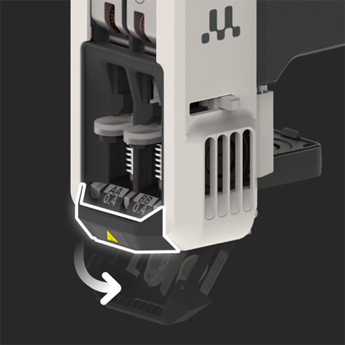

  1. Insert a different print core by squeezing the black grip upward and sliding it into the print head slot until you hear a click. If needed, you can give it a gentle push to ensure it sits in position well.
  2. Close the bracket and select Confirm when completed.
