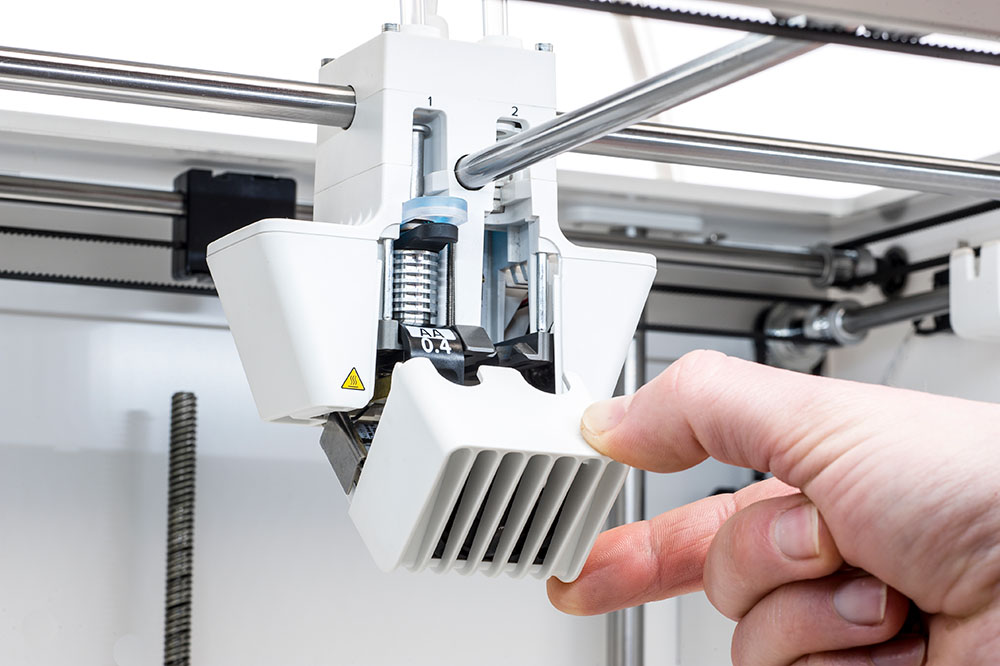

  1. Open the glass door(s) of the printer.
  2. Next, open the print head fan bracket and press Confirm.
  3. Install the second print core (BB 0.4) in print head slot 2 by squeezing the black lever of the print core upwards and sliding it into the print head until you hear a click.
  4. Carefully close the print head fan bracket and Confirm to proceed with the welcome setup.
Caution: Do not touch the contact points on the back of the print core with your fingers.
Tip: Make sure you keep the print core completely vertical while installing it so it will smoothly slide into the print head. If it does not click into place, give it a gentle push.
Note: If you skip this step during the welcome setup, you will not be able to load material into the second extruder. You will also not be able to start a single-extrusion print. S series printers always require two print cores to be installed. Continue to install the second print core via the Configuration menu.
