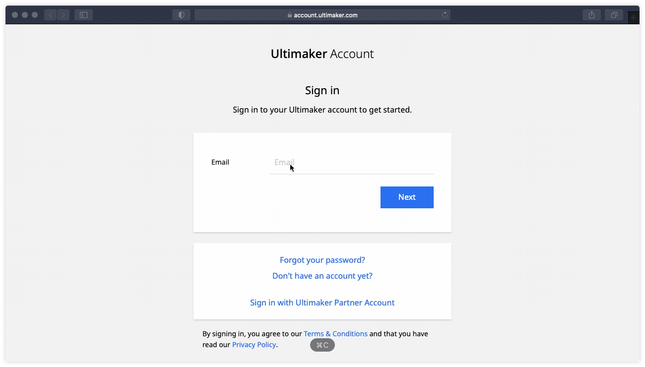

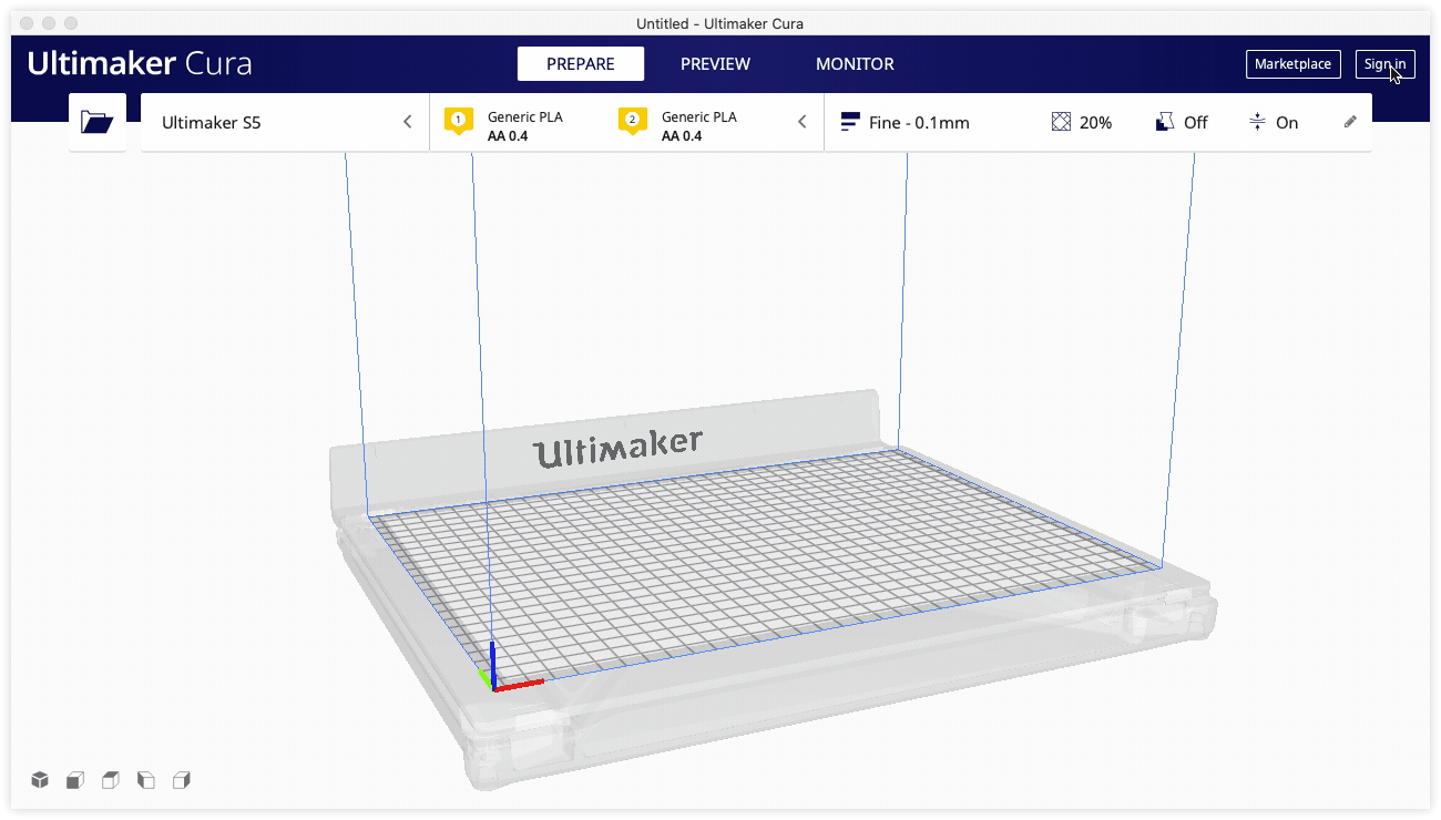

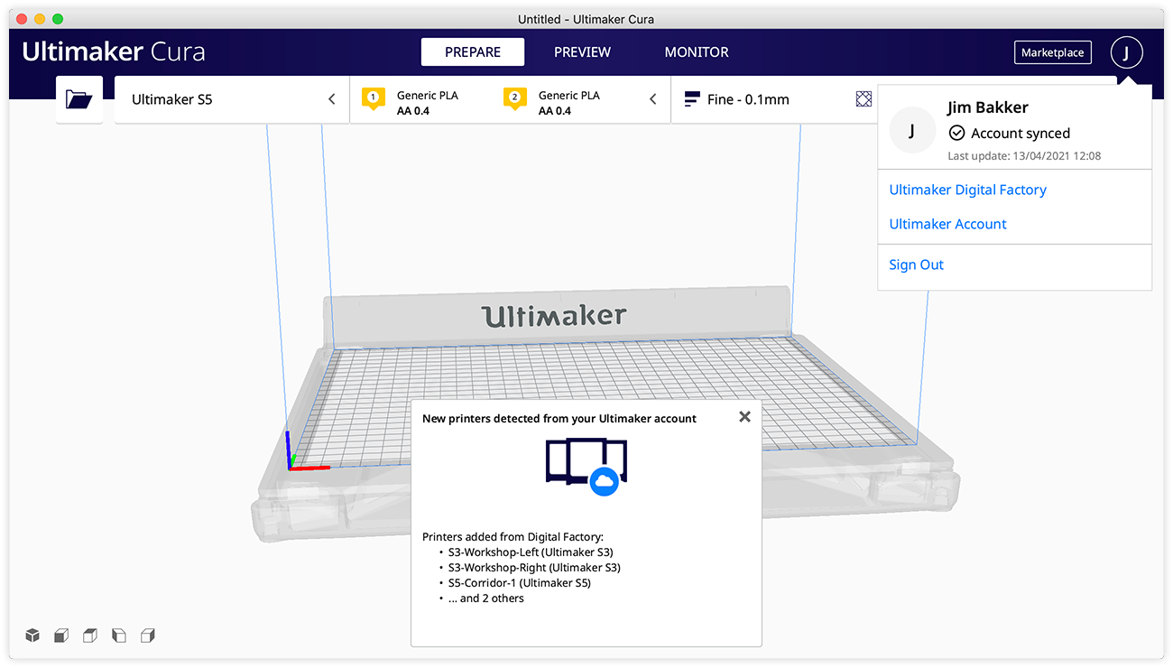

Use the Sign in button on the top right corner of the Cura interface to sign in to your UltiMaker account.
A browser window will appear showing the UltiMaker Account sign-in page. Enter your email address and password to sign in with your Ultimaker account. Don't have an UltiMaker account yet? Create one for free.
You can now go back to Cura. Notice that all your connected UltiMaker printers are now available to you in UltiMaker Cura. If you have not connected any printers to the Digital Factory yet, learn here how.

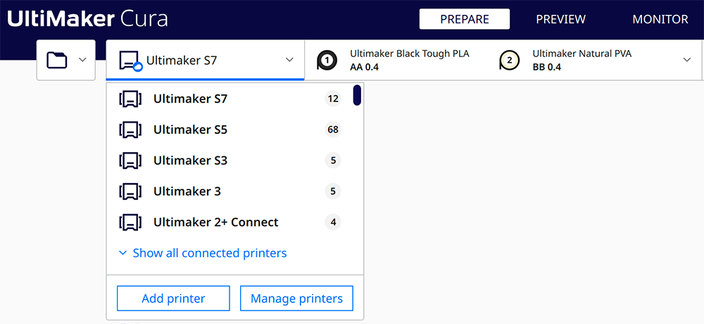

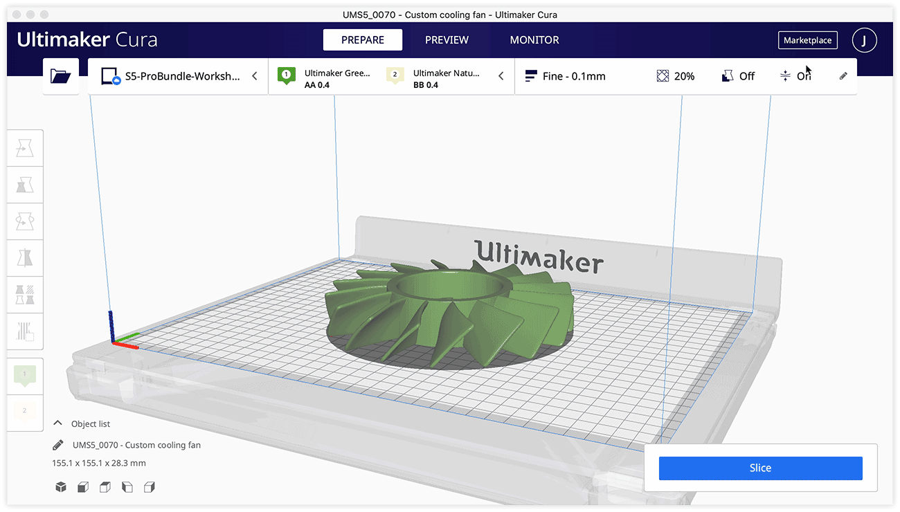

Start by selecting the printer from the Printers panel. Your connected printers will be automatically shown in this list. If you have connected more printers of the same type, they will be shown grouped. Just select the model you want to slice for. You can also click Show all connected printers to expand the groups, and choose a specific printer to limit the number of configurations shown.

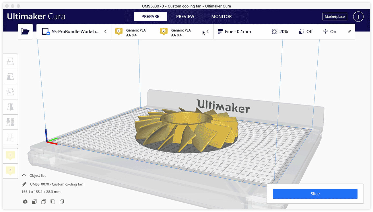

Next, choose your configuration. All available configurations for your selected printer or printer model are shown in the Configuration panel. Choose one of the available ones, or click Custom to set up a new configuration. Note that in this case, you will need to change the material(s) and/or print core (or nozzle) before the print can start.
If you have an UltiMaker S5 or S7 in combination with a Material Station, every available configuration will be shown.
Tip: If you want to print with third-party materials, first install the profile(s) via the UltiMaker Marketplace and sync them with your printer.

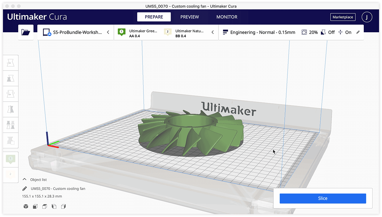

To start preparing your 3D model, choose your preferred printing profile. The availability of preset print profiles depends on your printer and chosen configuration. In the Recommended mode, you can quickly and easily change some settings, such as strength, support, and adhesion. If you want to change other settings for a specific printing strategy, you can do so in the Custom mode.
Tip: For selected materials and print cores on S series printers, you can choose between different intent profiles. These profiles have been optimized for specific applications.
Slice and preview
When you are satisfied with the chosen profile and settings, click the Slice button. This can take a few moments, depending on the size and complexity of the 3D model.
It is always recommended to check the slicing result in the Preview mode to see if the print will come out as expected. This is especially true when working with more complex models or highly specific print strategies. You can learn more about the Preview mode in this article.

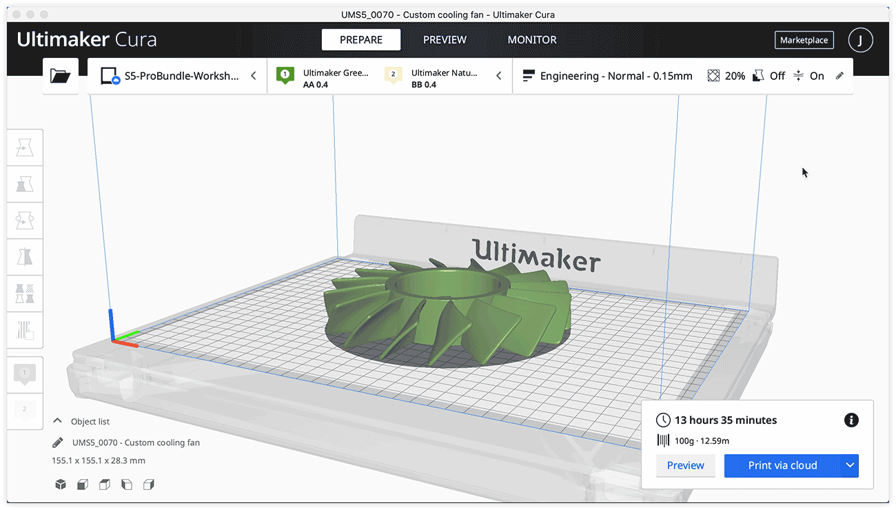

To start your print immediately or send it to a print queue, click the Print via cloud button in the action panel. If necessary, you can change the options for the button by selecting the dropdown arrow. After you select print, you will be shown an overview of the compatible printers. Choose one and click the printer icon to send the print job via the cloud.
Tip: Print jobs prepared for the UltiMaker S5 can also be printed on an UltiMaker S7 and vice versa.
If the printer has a matching configuration and is idle with no other waiting print jobs, the print will start straight away. If the selected printer is currently busy, the new job will be placed in the queue. If the configuration of the printer does not match with the received print job, the printer will await a change of material(s) and/or print core(s) before the job will start.
Alternatively, you can also save the print job and project file to the Digital Library. Here, you can easily collaborate with team members. Learn more about the Digital Library
