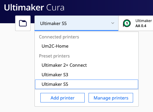

The easiest way to connect your networked 3D printer to UltiMaker Cura is by adding your printer via the Printers panel and selecting Add printer. Cura will show a list of all UltiMaker printers available on the local network. For more information, follow the instructions on how to add a networked printer in this article.

If you have already added an UltiMaker printer with network capabilities from the list of non-networked printers, you can connect it to Cura later. First, connect your printer to Wi-Fi or Ethernet, of course. You can connect to a printer that is already added via Manage printers in the Printers panel in the UltiMaker Cura interface.
The printer management window shows a list of all printers currently available in UltiMaker Cura. Extra options are displayed for the active printer.
Tip: If you want to connect to a different printer than the one that is currently active, click the icon with the three lines and select Activate.

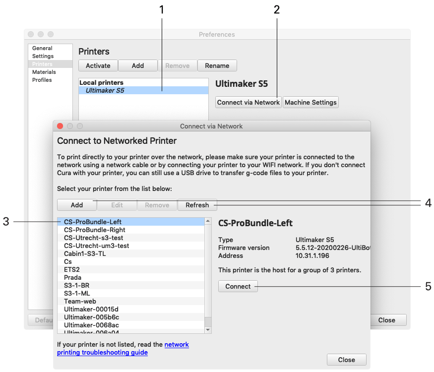

  1. Select the local printer you would like to connect to and ensure it is active (shown in italics).
  2. Select Connect via Network to open the network connection window.
  3. Select your printer from the list of available networked printers. This list is automatically populated with printers available on your local network
  4. If the printer does not show up, try refreshing the list manually. Alternatively, the Add button allows to manually enter the IP-address of the printer to connect to it.
  5. Select Connect to establish the network connection.
Note: The Ultimaker 3 and S series printers can be added locally. This is not available for the UltiMaker 2+ Connect, as this printer requires a cloud connection.
