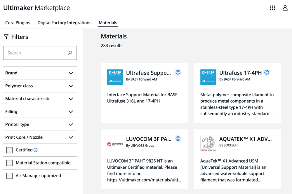

Go to the Marketplace and download your preferred material profile(s).

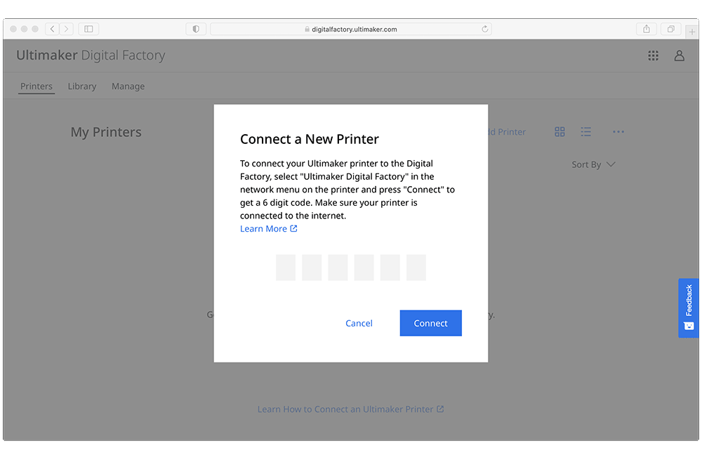

Connect your printer to the UltiMaker Digital Factory. If your printer was already connected, restart UltiMaker Cura.

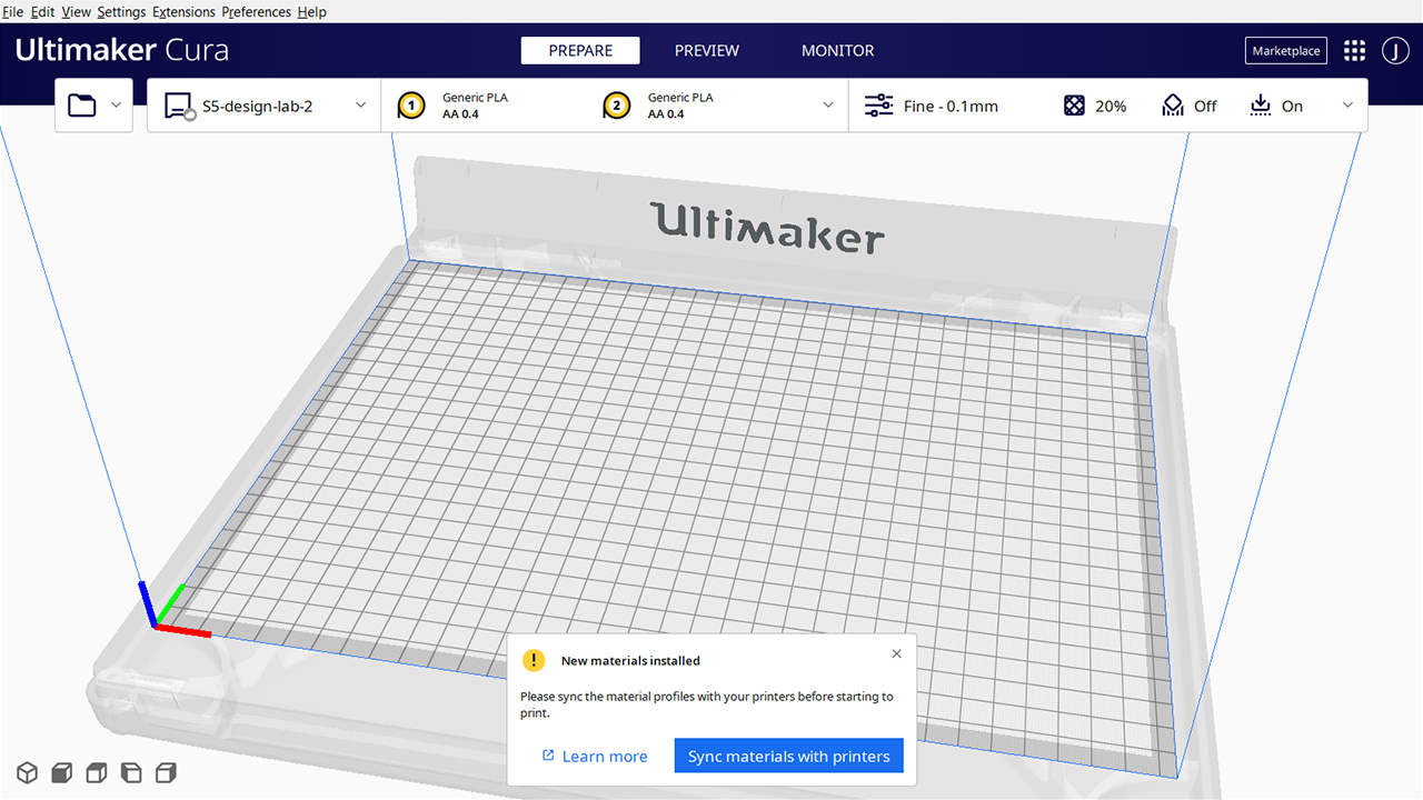

When UltiMaker Cura starts, you will see a pop-up notification about the new materials. Click 'Sync materials with printers'.

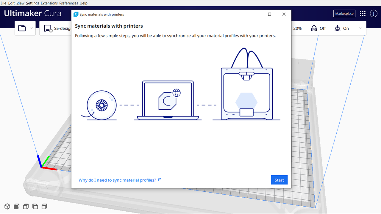

In the next screen, click 'Start' to begin the process.

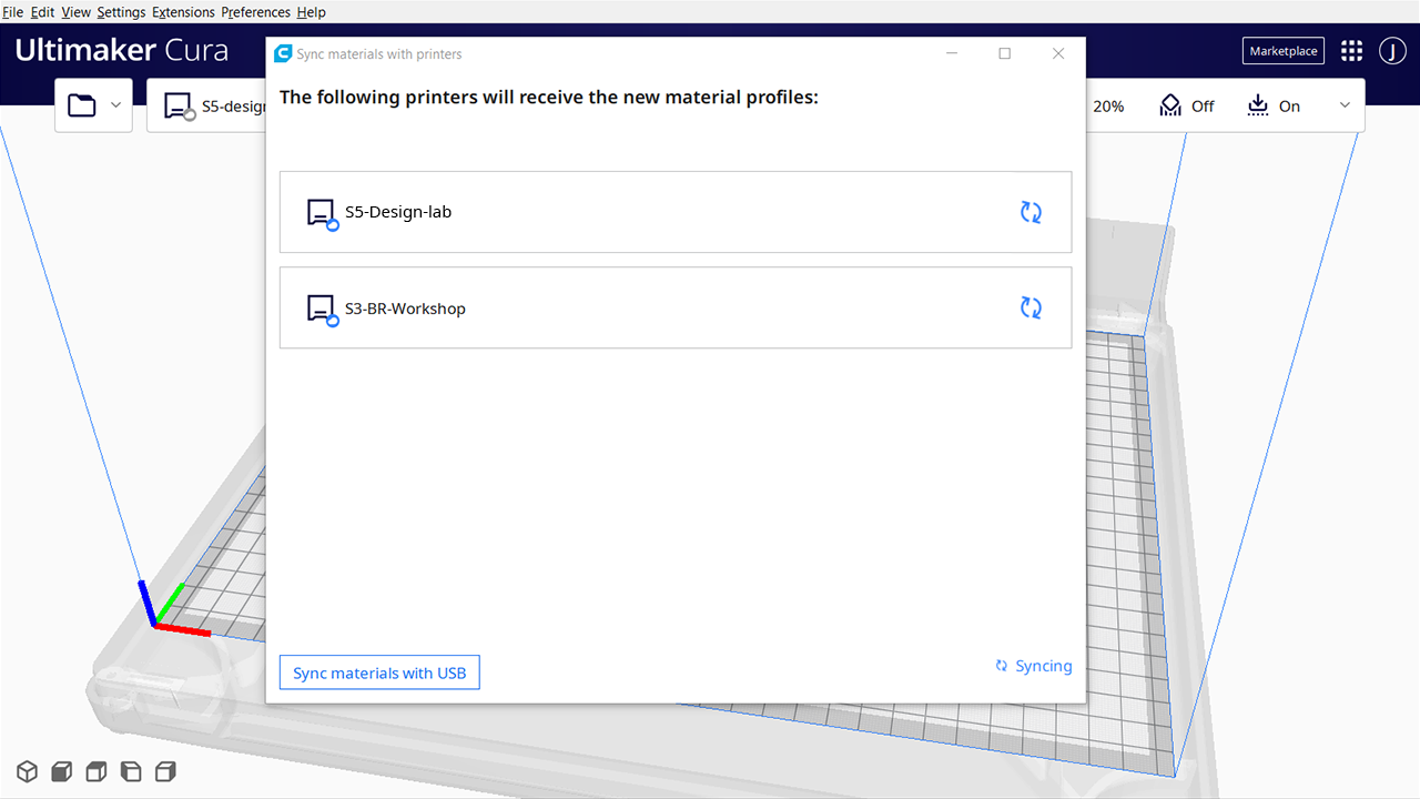

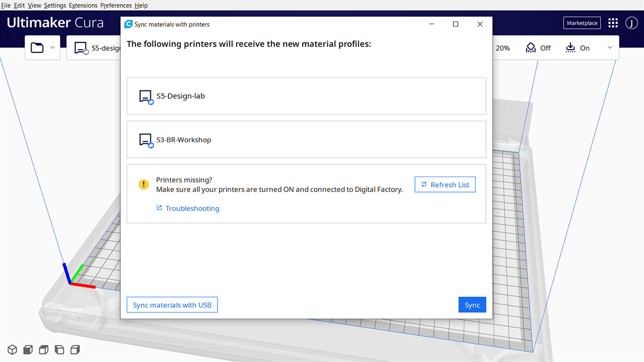

5. Printer overview
6. Syncing
You will now see all your connected printers to the Digital Factory with firmware version 7.0.1 or higher which can receive the material profiles.
Click 'Sync' to send the material profiles to the selected printers.

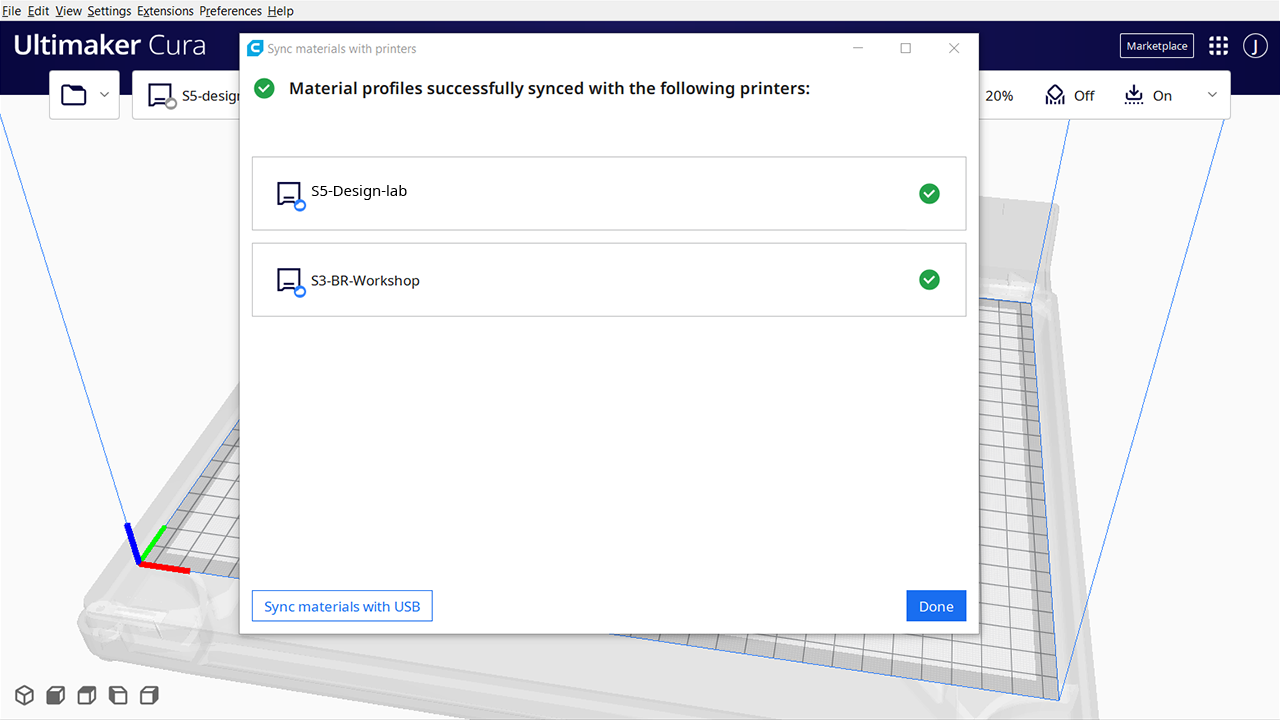

7. Done
When the syncing is finished, click 'Done' to exit the synchronization screen.

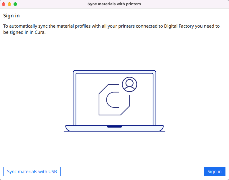

USB synchronization workflow (optional)
If you prefer or rely on synchronizing the materials via USB, follow the steps above to step 5 to show the 'printer overview', then continue with USB synchronization as described below.

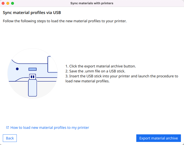

1. Start synchronization wizard2. Sync with USB

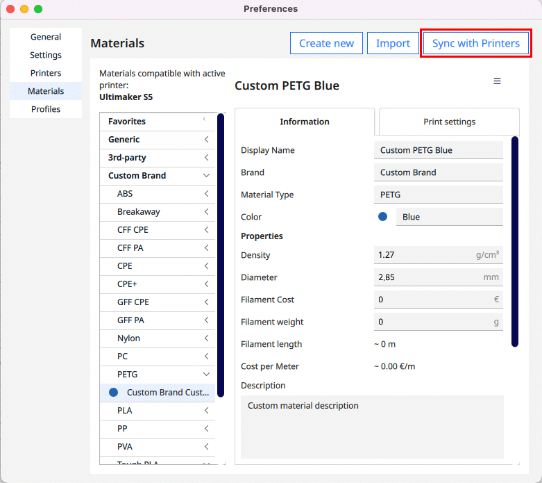

In the Cura 'preferences' > 'materials' menu, select 'sync with printers' in the top right corner. In the next screen, click 'start' to begin.Select 'sync materials with USB'.
3. Export material archive4. Load the materials on your printer
This will create a material archive file. Save it directly on the USB stick (without putting it into sub-folders)On the UltiMaker S-line printers or UltiMaker 2+ Connect, go to 'Maintenance' and 'Import material profiles'. The printer will acknowledge that your materials have been added to your printer.
