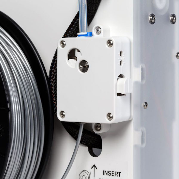

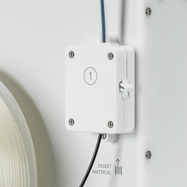

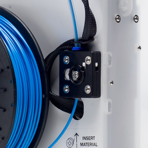

The feeder
The feeder is the part of an UltiMaker 3D printer that 'feeds' or forwards the material from the spool to the print head. The feeder grips the material with a knurled wheel to push it forward. In case of extrusion problems, you may notice the feeder skipping back or grinding the material.
Tip: For in-depth information about troubleshooting problems with the feeder, please visit this page: How to fix feeder issues
UltiMaker 2 series feederUltiMaker 2+ and UltiMaker 3 feederUltiMaker S series and UltiMaker 2+ Connect feeder

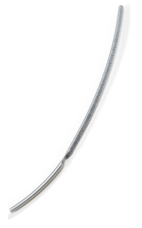

The first thing to check on the feeder is the feeder tension. The feeders of UltiMaker 3D printers have a tension indicator. For UltiMaker materials, this should be set in the middle. If the tension is too low, material can slip inside the feeder. If the tension is too high, material can be ground down and get stuck in the feeder. You can adjust the feeder tension using a 2 mm hex screwdriver in the top of the feeder housing.
Good
Consistent marks on the filament indicate good feeder tension
Too low
No visible marks on the material indicate too low feeder tension
Too high
Flattened material or grinding indicates too high feeder tension
Tip: Learn more about the correct feeder tension and how to adjust this in this article.

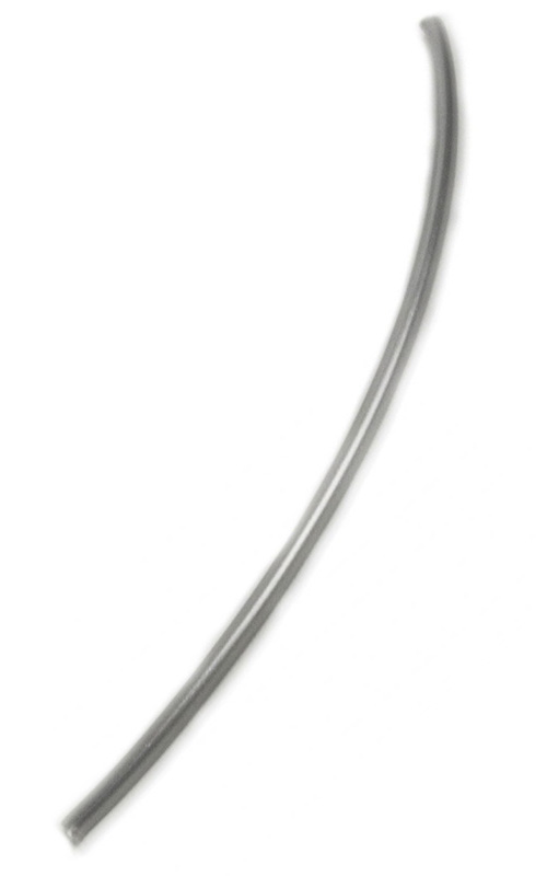

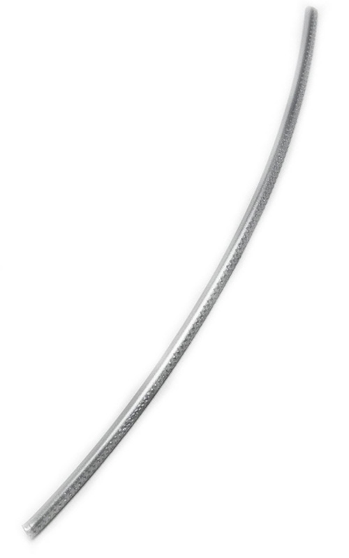

The Bowden tube
The next component in the extrusion train is the Bowden tube. This tube guides the filament from the feeder to the print head. It is important that the material can pass through without too much friction.

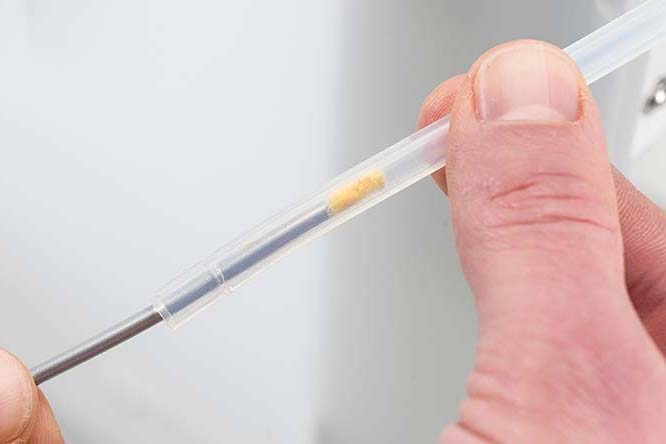

If small particles have accumulated inside the Bowden tube (for example, after you have experienced grinding), this will increase the friction on the material. These particles can end up in the hot end and printed object and can also cause under-extrusion if the friction becomes too high. Clean the Bowden tube according to the instructions on this page:
How to clean the Bowden tube
Additionally, check the inside of the tube for scratches and other signs of damage. If the tube is damaged, it must be replaced. For the best results, it is recommended to check and replace the Bowden tube(s) after about one year of printing.

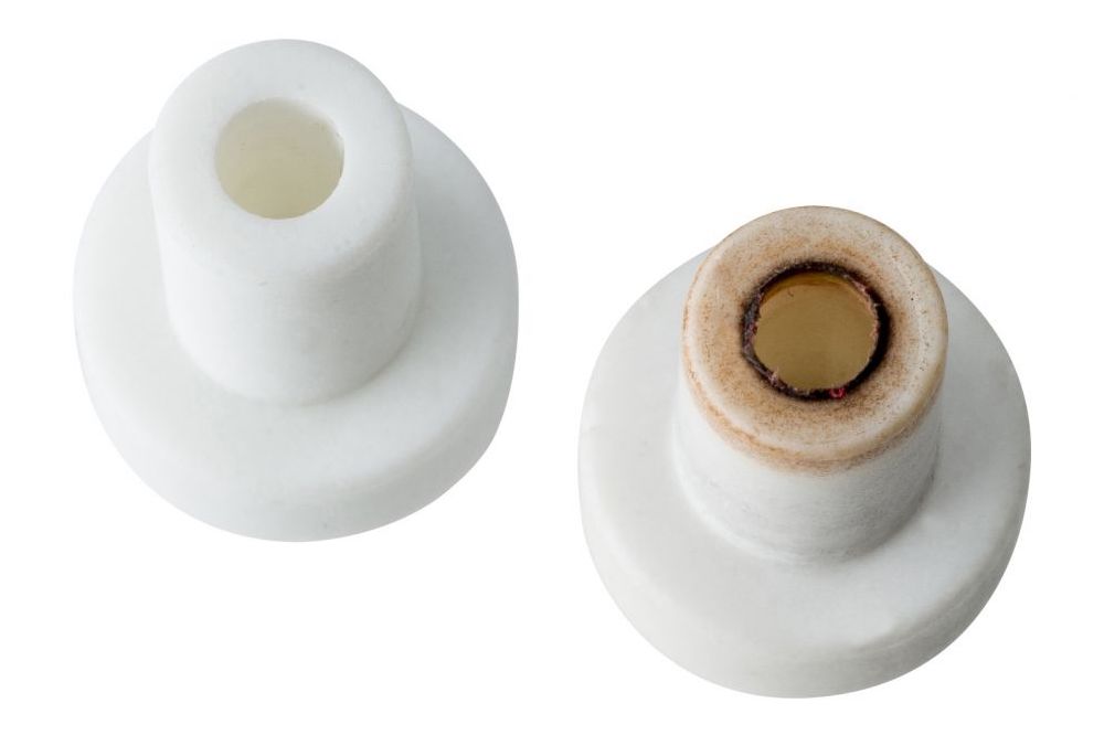

PTFE/TFM coupler
The print heads of the UltiMaker 2 series (including the UltiMaker 2+ and the UltiMaker 2+ Connect) are built up of individual components. Between the 'hot end' and 'cold end' of the print head is a coupler. This white part is made of PTFE or TFM. This part can wear over time due to the pressure in the hot end and the high temperatures from the heater block.
In case of extrusion problems, it is recommended to check this part and replace it when it is damaged, burnt, or deformed. This requires disassembling the print head. Follow the step-by-step instructions on the pages below:
The image above shows a new coupler on the left and a worn-out coupler on the right. Note the burnt and frayed edge on the inside of the coupler.
Note: This does not apply to the UltiMaker 3 or S series printers. These printers use print cores which are built up differently and cannot be disassembled.
