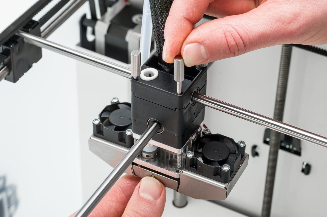

1. Remove the clamp clip2. Remove the Bowden tube
Manually place the print head in the front left corner for easier access. Remove the clamp clip from around the tube coupling collet.Press down on the tube coupling collet while pulling the Bowden tube out of the print head.

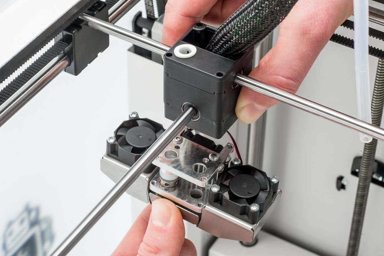

3. Remove the long screws4. Separate the print head
Loosen and remove the four long screws that go through the print head housing. Place some blue tape around the print head housing to keep the parts together (recommended). Gently move down the bottom part of the print head.

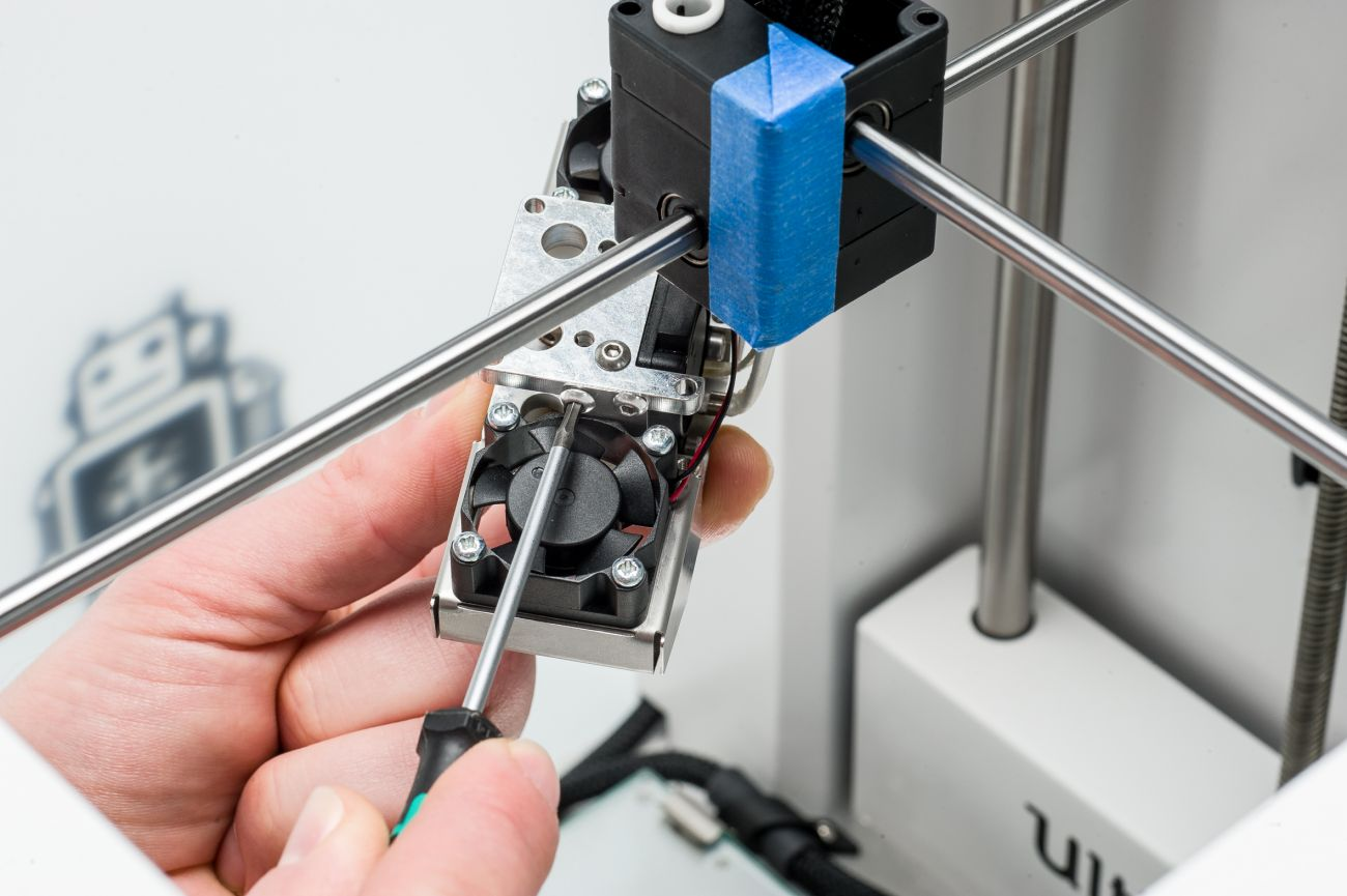

5. Remove the fan bracket6. Remove the aluminum plate
Use the 2 mm hex key or screwdriver to loosen and remove the two small M3x4 bolts on either side of the print head that secure the fan bracket.Use the 2 mm hex key or screwdriver to remove the two M3x10 bolts from the top aluminum plate. Take this plate off the hot end assembly.

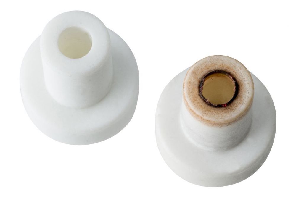

How_to_replace_TFM_coupler_for_Ultimaker2 _Remove_TFM_coupler.jfifWorn-TFM-coupler.jpg
7. Remove spacer and coupler8. Inspect the TFM coupler
Take the metal spacer off the TFM coupler and place it aside. Next, take the TFM coupler out of the hot end isolator. If necessary, use the screwdriver to pry it out.Check the bottom of the coupler. This image shows the difference between a new and a used coupler. If the edge at the bottom looks burnt, frayed, or deformed, replace the coupler with a new one.

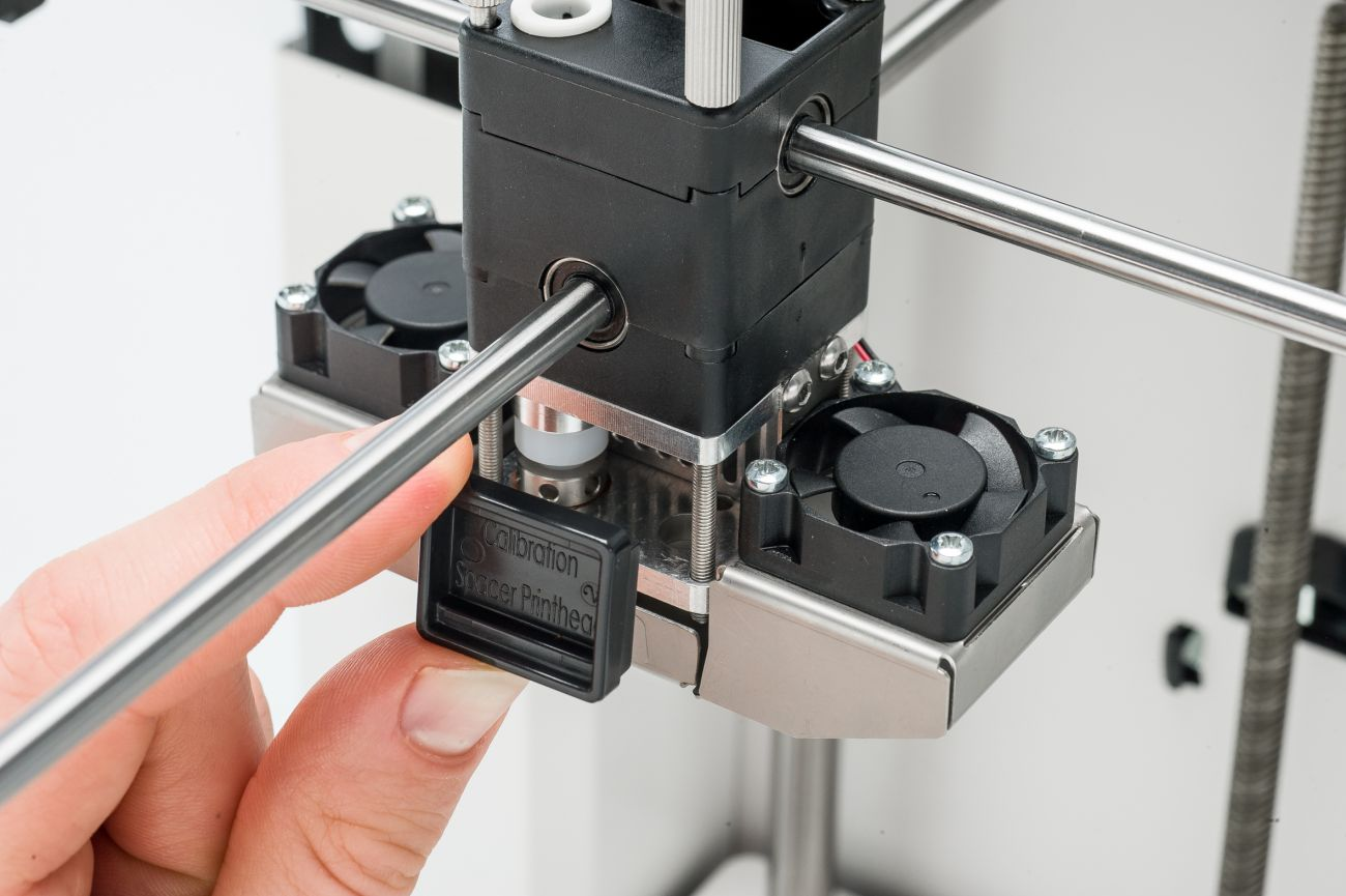

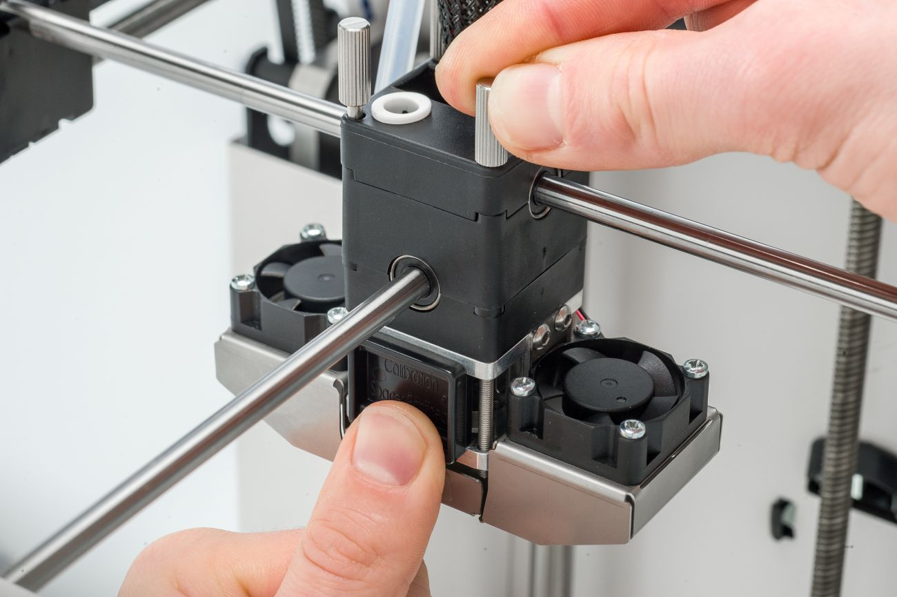

7. Place the print head calibration aid8. Tighten the screws
Place the plastic print head calibration aid between the two aluminum plates of the hot end assembly. Keep it in place during the next step.Tighten the four long screws until the tool fits securely between the two plates, but can still easily be removed. This tool ensures the correct pressure on the hot end parts.

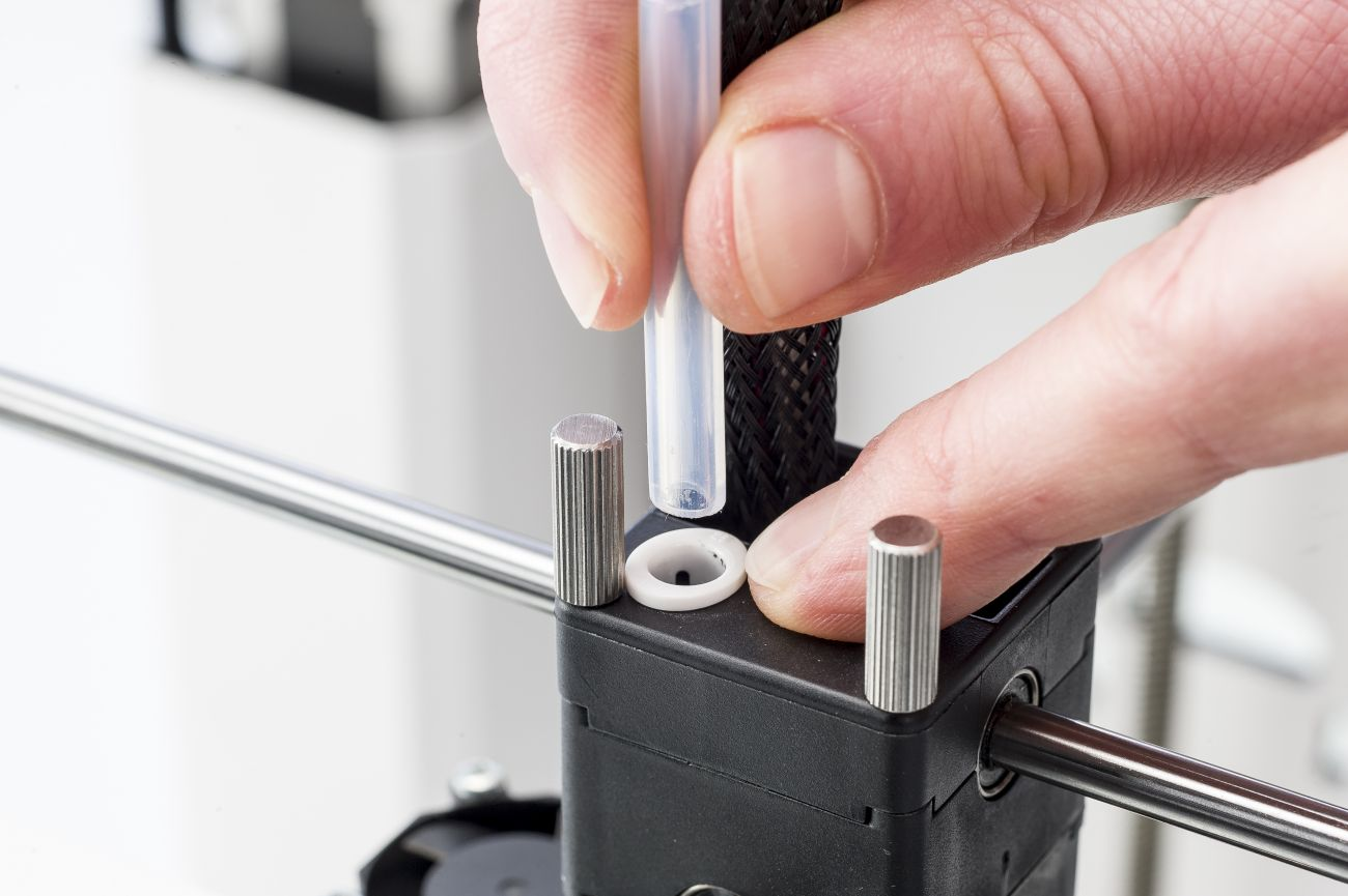

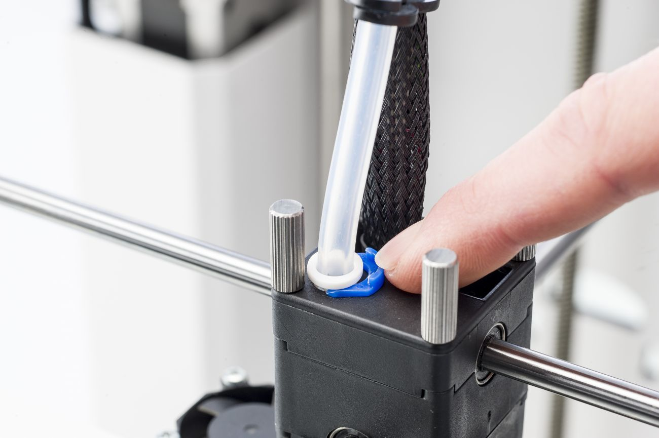

9. Insert the Bowden tube10. Place the clamp clip
Push the Bowden tube fully into the tube coupling collet. Lift up the collet with your fingernail and give the Bowden tube another push so it is fully inserted.Secure the tube in place with a clamp clip.
