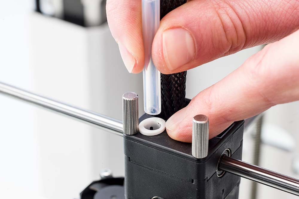

3. Remove the Bowden tube
Remove the clamp clip from the print head. Push down on the white tube coupling collet and pull the Bowden tube up and out of the print head.

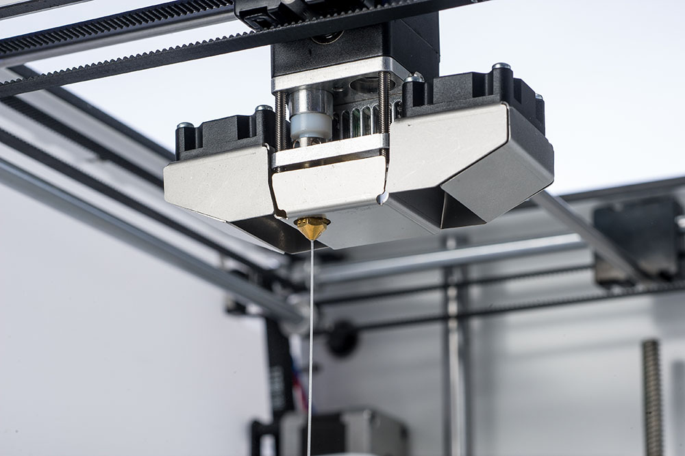

1. Insert the filament
When the nozzle has reached its target temperature, insert the piece of filament into the print head. It is recommended to hold the filament with pliers.
2. Hot pull
Apply some pressure to the filament and immediately pull it out again. This removes the majority of carbonized material.

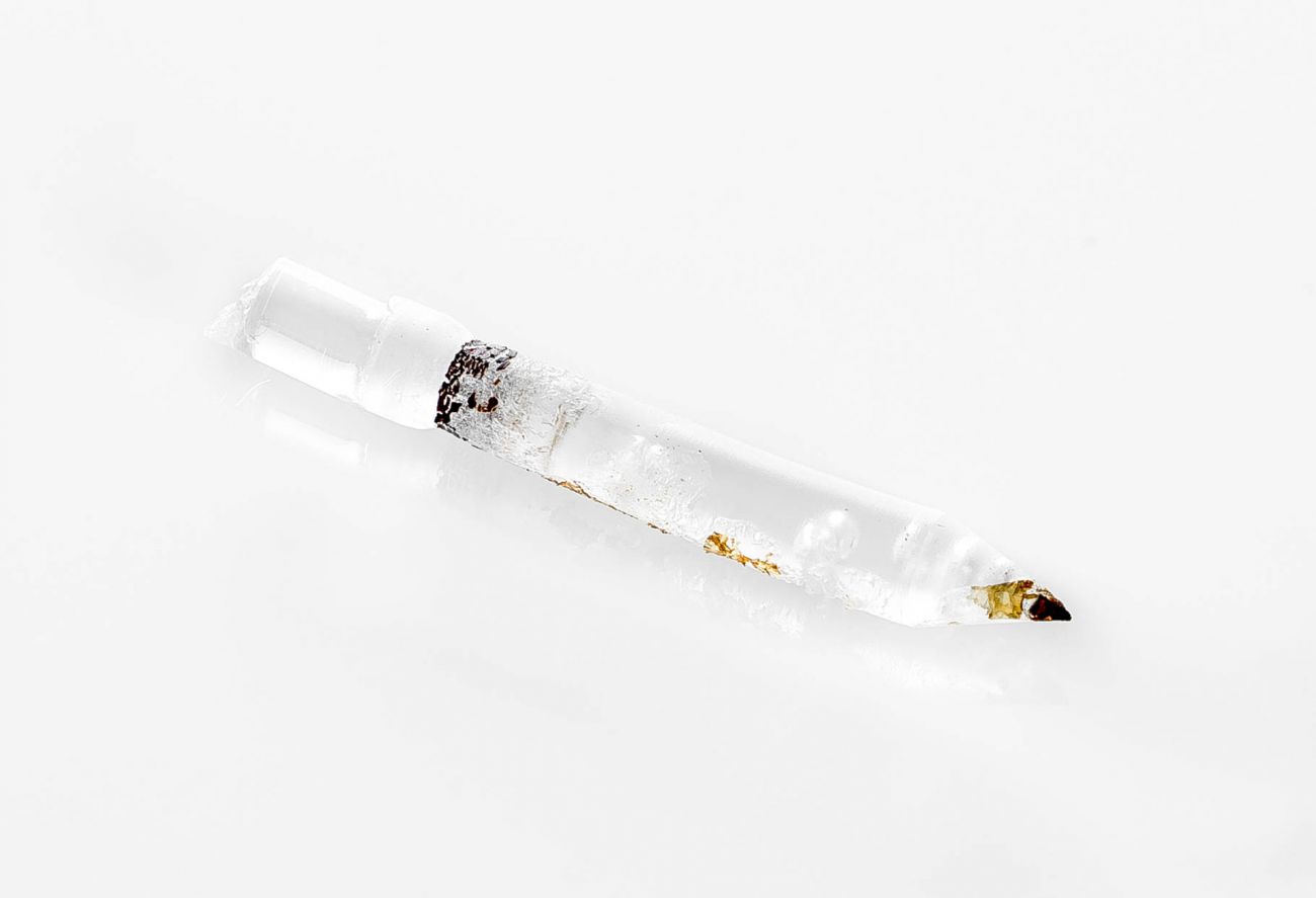

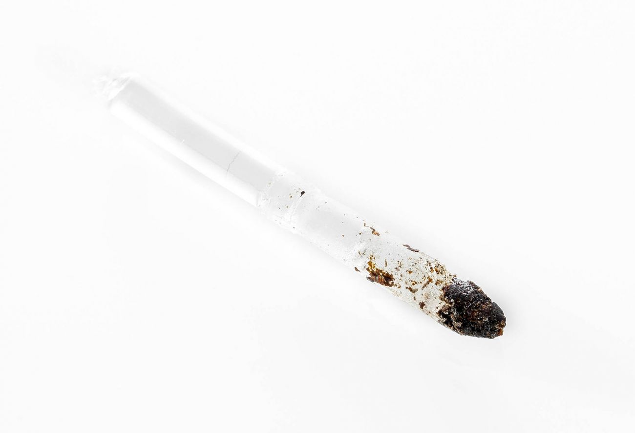

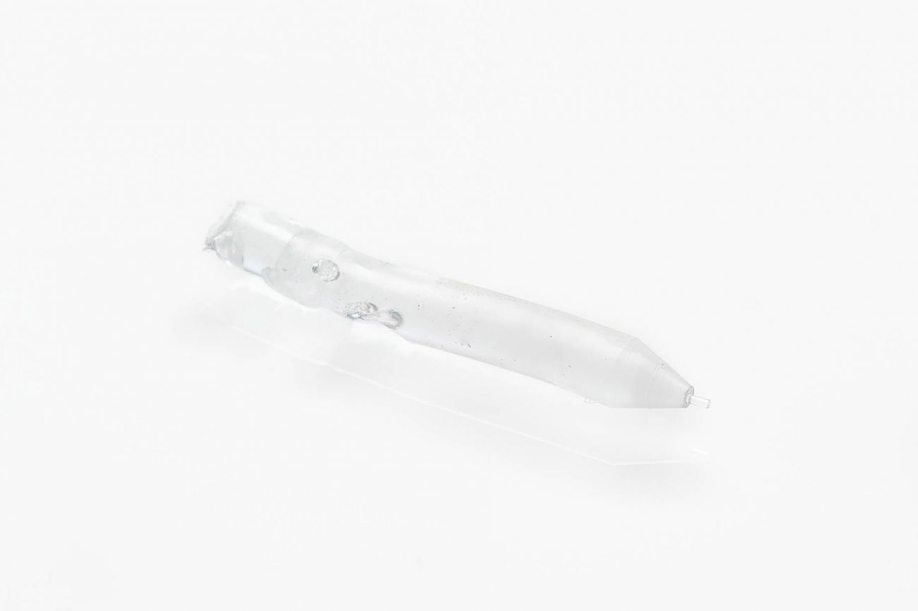

6. Inspect
Check the tip of the filament. It should come out clean and cone-shaped (like the inside of the nozzle). If it is not clean, raise the temperature again and repeat steps 3 - 6. See the examples below.
Too much carbonized material, repeat the cleaning processAlmost clean, perform one more cold pullThe tip of the filament is completely clean, proceed to reassembly

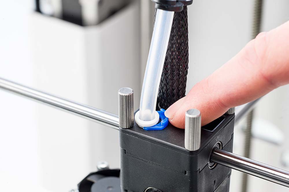

1. Insert the Bowden tube
Push the Bowden tube back into the print head. Make sure it is fully inserted. Secure it with the clamp clip.
