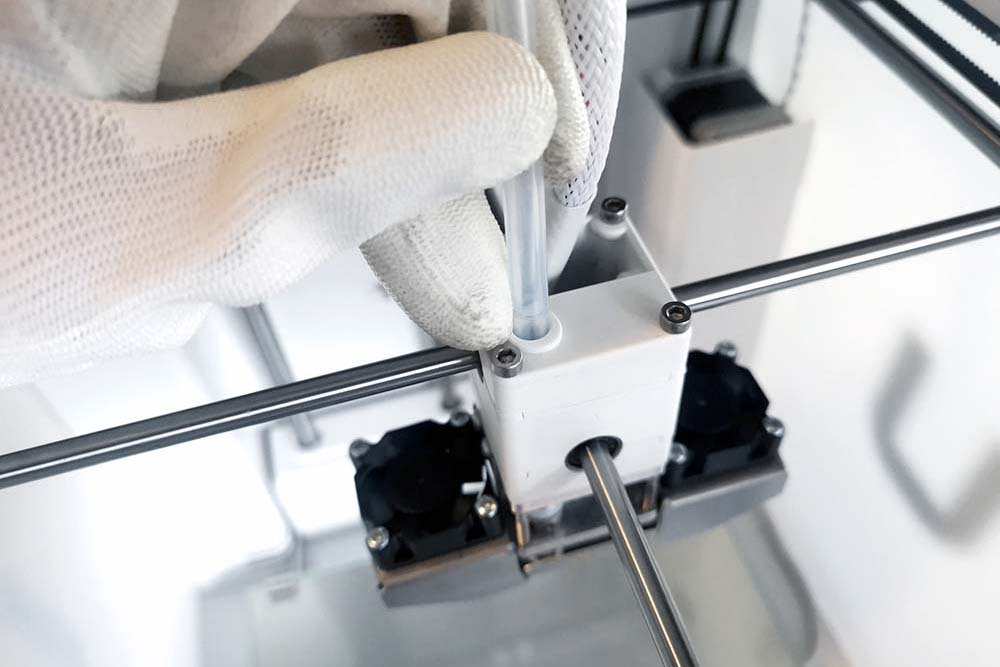

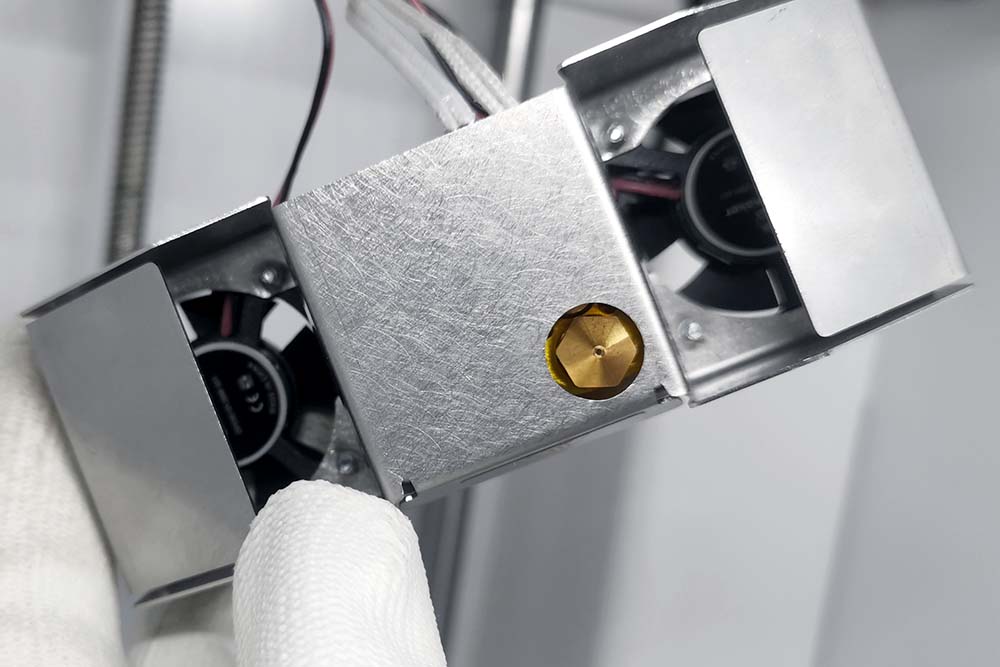

  1. Remove the clamp clip and take the Bowden tube out of the print head.

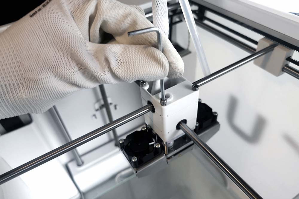

  1. Use the 2.5 mm hex key to remove the four long bolts from the print head.

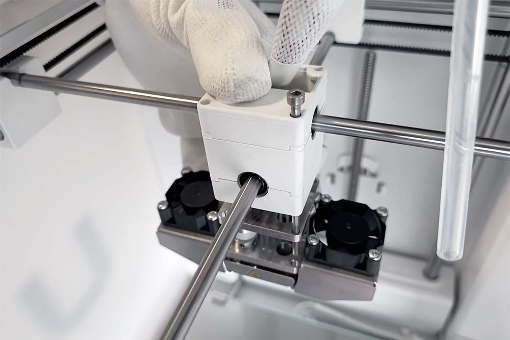

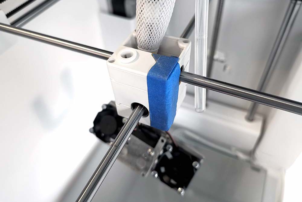

  1. Gently lower the hot end assembly.
Tip: Use some blue tape to keep the print head housing parts together.

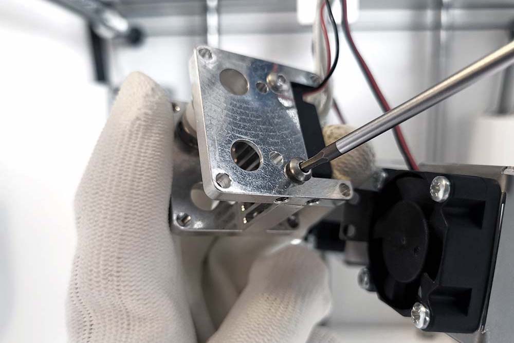

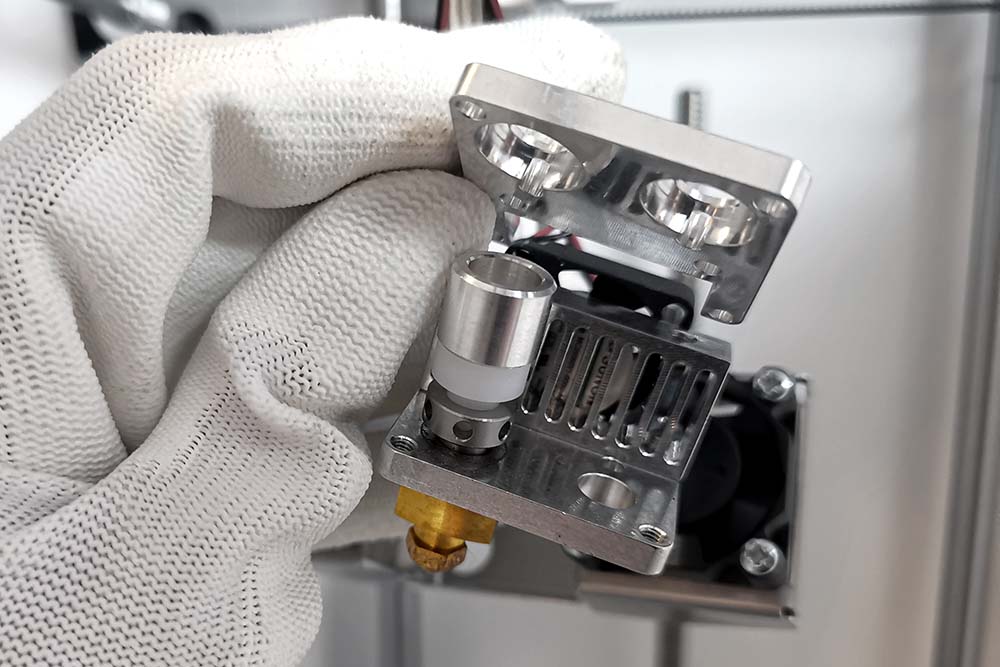

  1. Use the 2.0 hex screwdriver to remove the two small bolts on either side of the hot end assembly to loosen the fan bracket.

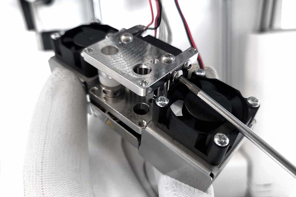

  1. Next, remove the two bolts at the top of the hot end assembly and take off the top plate.

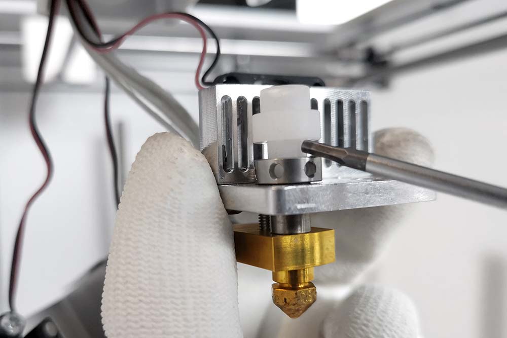

  1. Place the metal spacer aside and you can now pull the TFM coupler out of the hot end isolator.
This image shows the difference between a new and a used coupler. If the edge at the bottom looks burnt, frayed, or deformed, replace the coupler with a new one.
