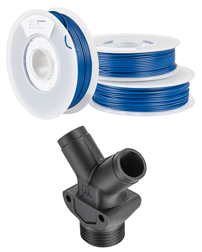

Note: This article contains information about UltiMaker 2.85 mm PET CF material. Similar quality cannot be guaranteed with third-party filaments. This material can be used on Factor and S Series printers, but is not compatible with older-generation UltiMaker printers, Method, Sketch, or Replicator.
UltiMaker PET CF is a carbon fiber-reinforced version of Polyethylene Terephthalate (PET). It has the same reliable printability as PETG, but with enhanced stiffness, chemical resistance, and temperature resistance (up to 180 °C after annealing). It is therefore the go-to composite material for 3D printing in industrial environments for functional prototypes and manufacturing aids.
