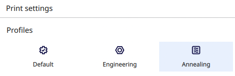

Print preparation
A downside of annealing is that your printed part will shrink slightly. In UltiMaker Cura, this shrinkage can be compensated for by slightly enlarging your part (typical shrinkage for PET CF is - 0.3% in XY and - 0.9% in Z). This is done automatically when choosing the annealing intent profiles.
Make sure to select a support material, as this will prevent sagging of your part during printing and annealing. You can choose to use self-support (PET CF support) or Breakaway support for annealing.
