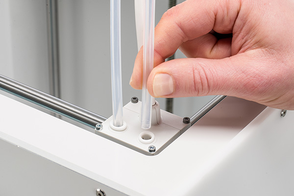

Bowden tubes

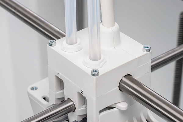

The Bowden tubes must be connected from the feeders to the print head. When installing the tubes, ensure to connect the tube from feeder 1 to the left side of the print head (slot 1), and the Bowden tube from feeder 2 to the right side of the print head (slot 2).
Take the following steps:
  1. Remove the clamp clips from the collets on the print head.
  2. Take the Bowden tube from feeder 1 and insert it into the left collet on the print head.
  3. Insert the Bowden tube from feeder 2 into the right collet on the print head.
  4. Secure the Bowden tubes with the clamp clips.

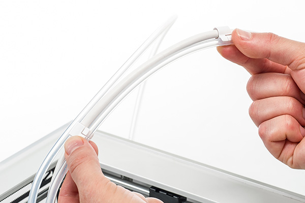

  5. Click the print head cable clips onto Bowden tube 2 (right) and divide them equally.
Note: Only connect the clips to Bowden tube 2, not to both.

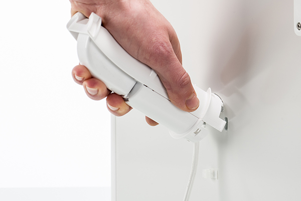

Spool holder

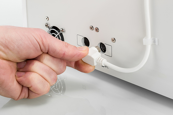

The spool holder has an NFC reader to automatically detect which UltiMaker materials are installed on the printer. The spool holder must be installed in the back panel and connected to the correct socket.
Note: The spool holder is not required in combination with the Material Station.

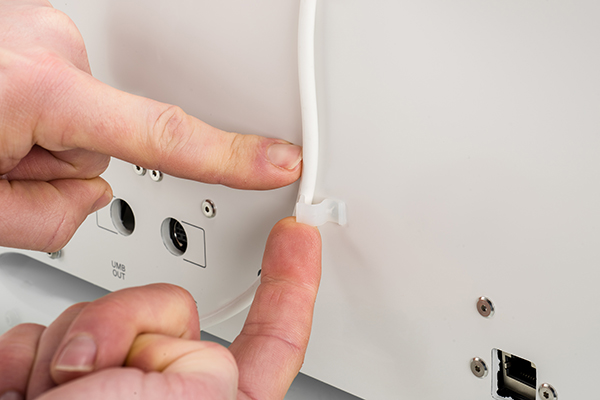

  1. Insert the spool holder into the back panel and push until it snaps into place.
  2. Secure the cable from the spool holder behind the cable clips in the back panel.
  3. Connect the cable to the NFC socket at the back of the printer.
Tip: The filament guide that is part of the spool holder will be installed during material loading in the welcome setup.

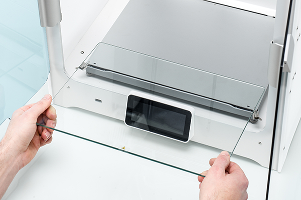

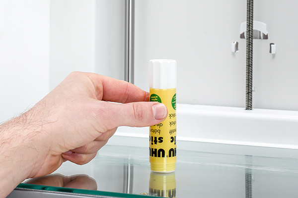

Glass build plate

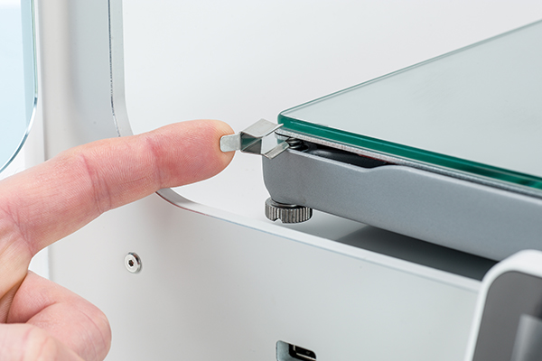

The glass plate is the print surface for the UltiMaker S5. This must be placed onto the build platform (or 'Z-stage') and secured with the build plate clamps.
  1. Open the glass doors.
  2. Open the two build plate clamps at the front of the build plate.
  3. Slide the glass plate onto the build plate until it fits into the clamps at the back.
  4. Close the two build plate clamps at the front to secure the glass build plate.
  5. Close the glass doors.
Tip: Most materials benefit from a thin layer of glue applied to the glass build plate. This improves adhesion and reduces the chance of glass chipping.

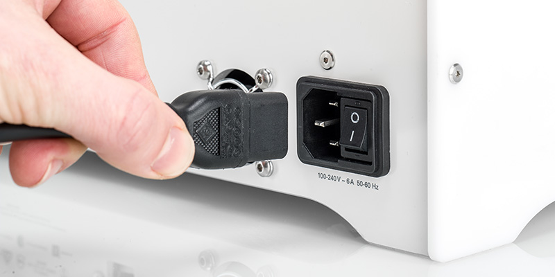

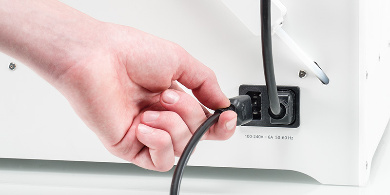

Power cable
Finally, connect the power cable. Firmly insert one end of the cable into the power socket at the back of the printer. Plug the other end into a wall outlet.
Note: If the UltiMaker S5 is installed with a Material Station, connect the power cable to the Material Station instead.
Caution: A mains socket with a protective earth/ground terminal must be used. Make sure that the building installation has dedicated means of overcurrent and short-circuit protection.

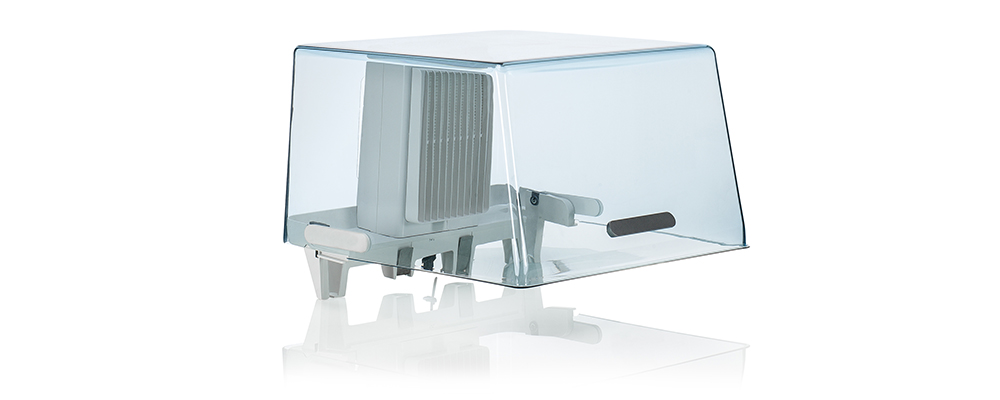

The Air Manager enhances safety by filtering UFPs generated during the printing process and provides a physical barrier from hot and moving components. The Air Manager is delivered as separate components, which can be installed in a few easy steps. Find detailed information about installing the Air Manager in this article:
Installing the Air Manager

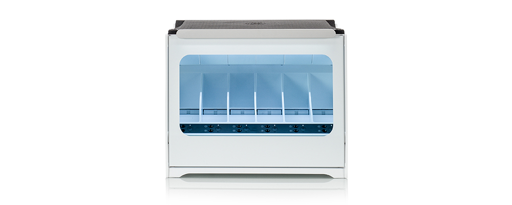

The Material Station enables 24/7 uninterrupted printing by automatically managing up to six spools in a humidity-controlled chamber. Set up the Material Station and connect it to the UltiMaker S6 (and optionally the Air Manager) as described in this article:
Installing the Material Station
Tip: For a step-by-step guide to set up the complete Pro Bundle, you can also visit this page: Installing the Pro Bundle
