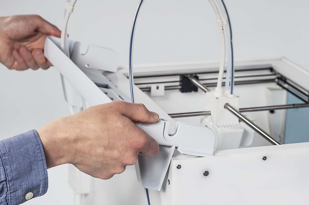

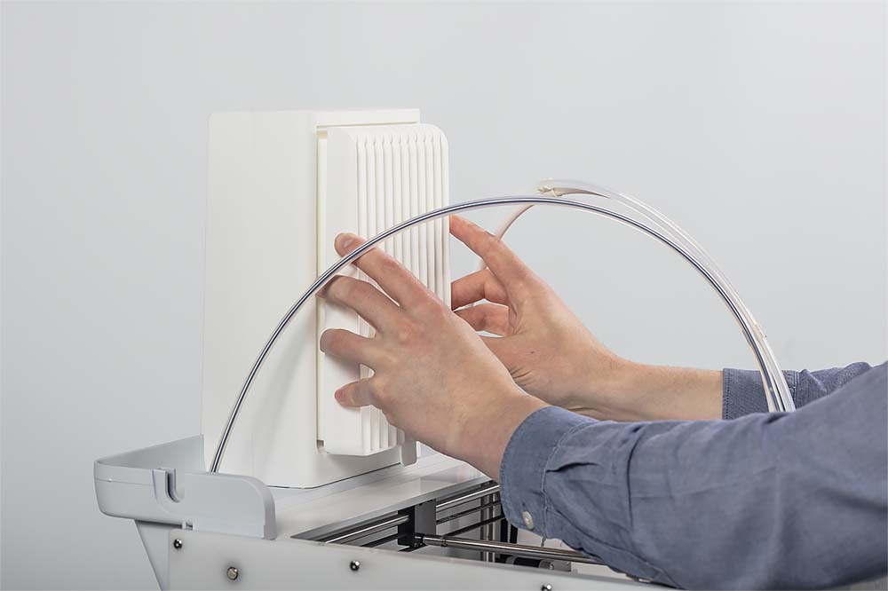

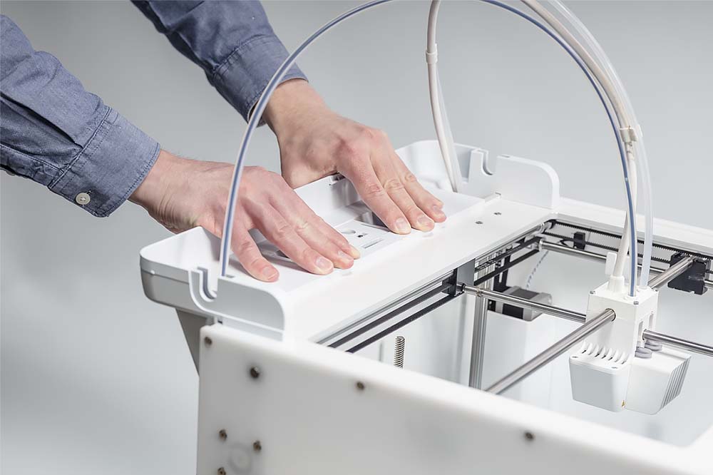

1. Mounting bracket
Align the mounting bracket with the back of the printer.

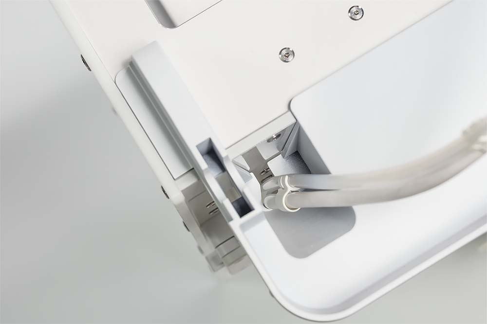

2. Bowden tubes
Guide the Bowden tubes into the mounting bracket slots. Ensure that Bowden tube 2 is placed in front of the print head cable.
3. Fix the mounting bracket
Gently push down on the mounting bracket until it clicks firmly into place.

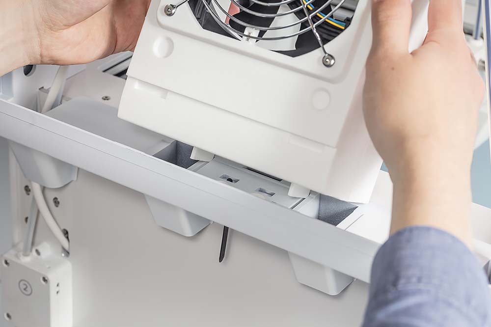

4. Filter housing
Align the bottom of the filter housing with the slots in the mounting bracket and push into place.

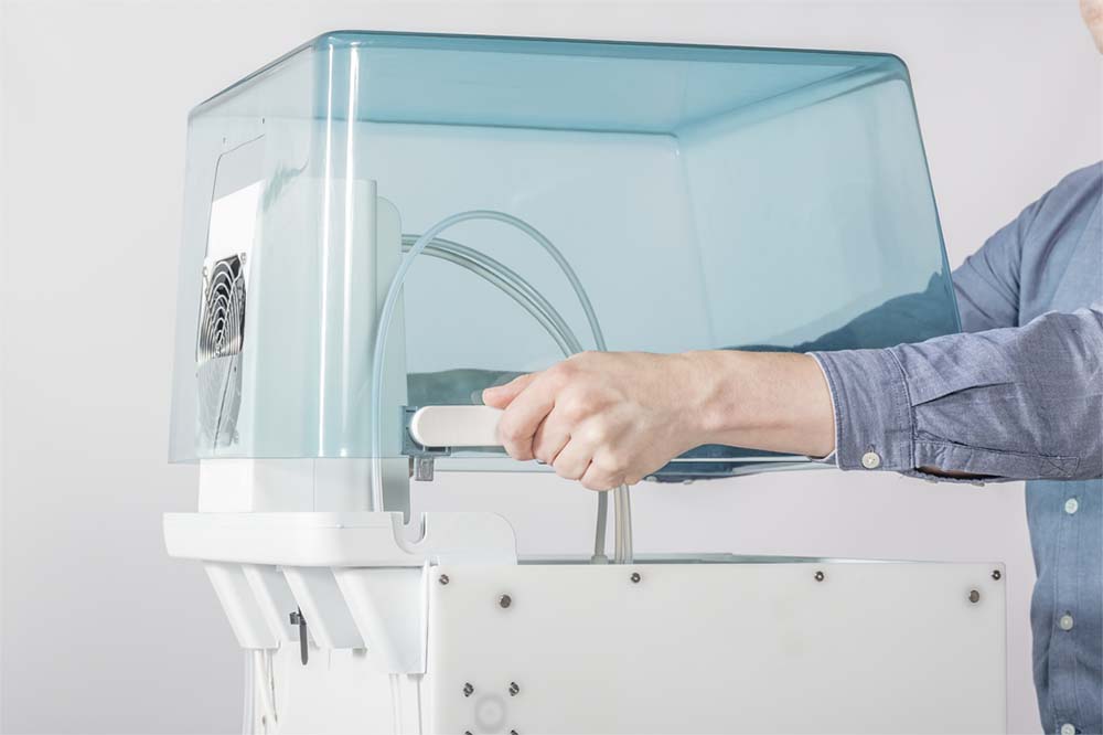

6. Cover
Lift the cover using the handles on each side, and place it over the filter housing.
S5-Air-Manager-QSG-7-Hinges.jpgS5-Air-Manager-QSG-8-Cable.jpgS5-Air-Manager-QSG-9-Strain-relief.jpg
7. Hinges
Align the hinges on the cover with the slots in the mounting bracket and drop the cover into place.

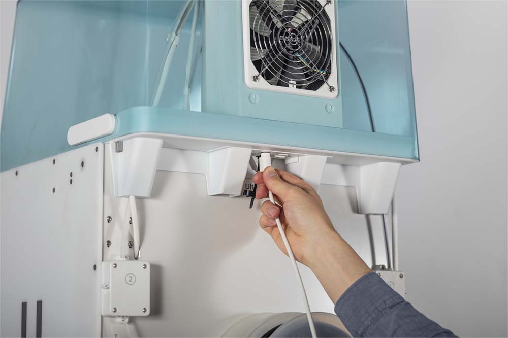

8. Air Manager cable
Connect the Air Manager cable to the port at the back of the Air Manager.

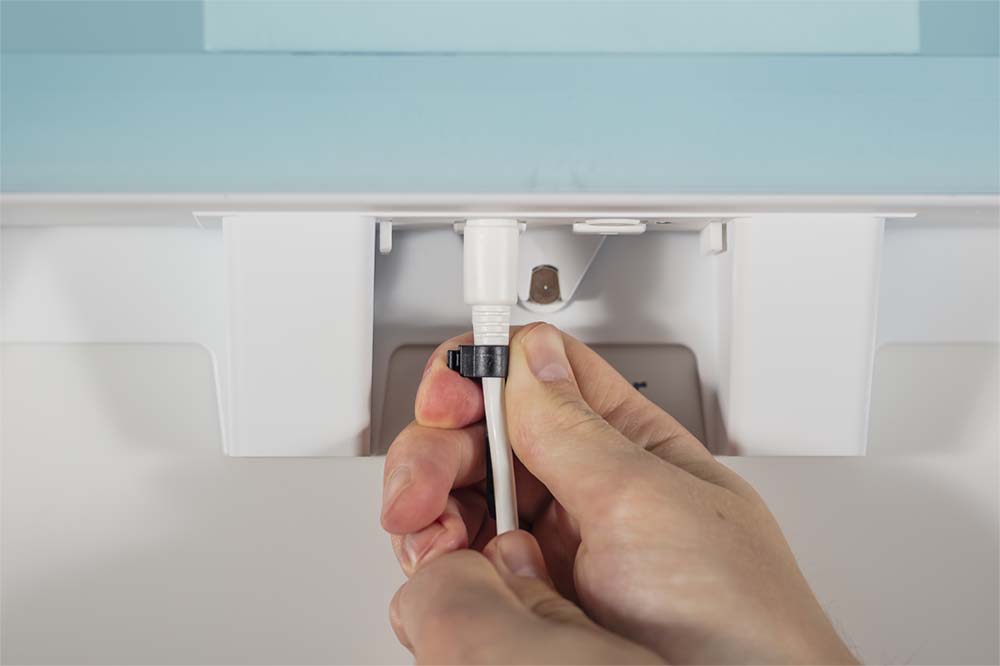

9. Stress relief clip
Place the stress relief clip attached to the mounting bracket around the Air Manager cable and close it.
 S5-Air-Manager-QSG-10-Strain-relief.jpgS5-Air-Manager-QSG-11-Guide-cable.jpgS5-Air-Manager-QSG-12-Connection.jpg

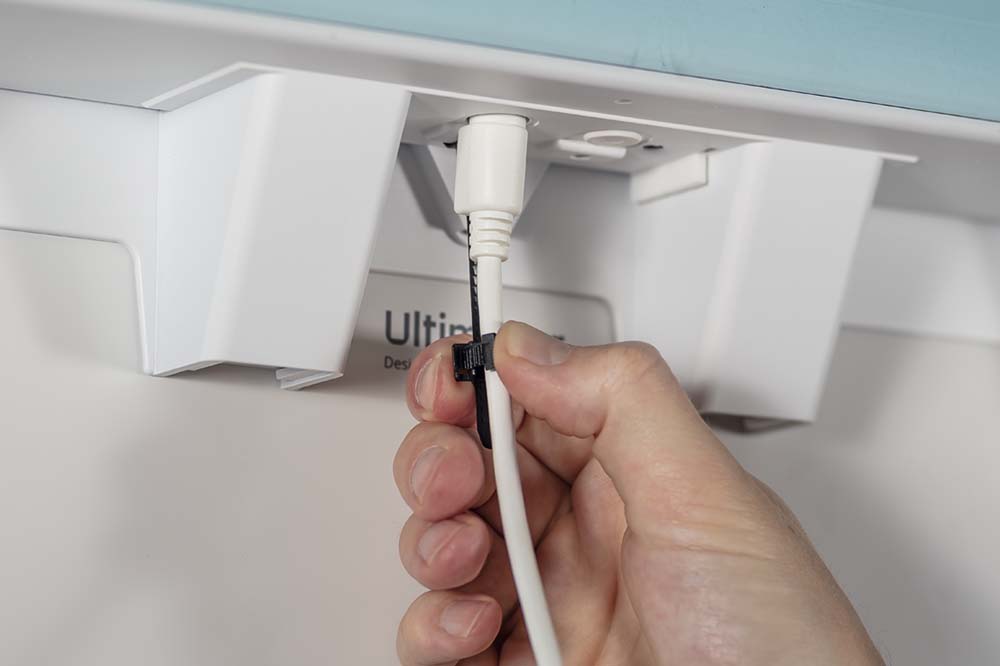

10. Secure stress clip
Slide the stress relief clip upwards until it cannot go further to secure the cable in place.

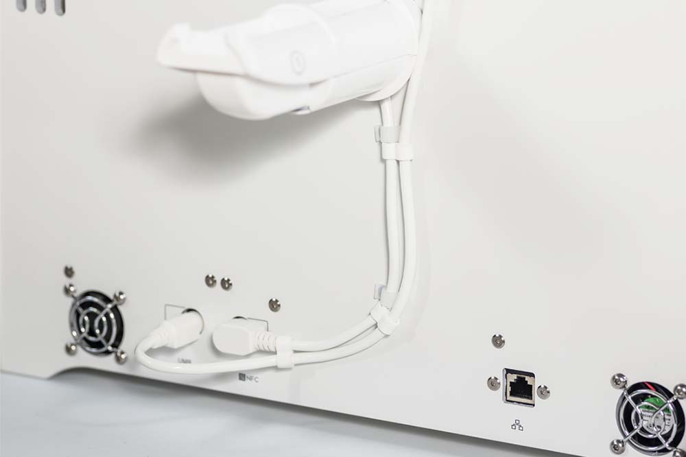

Guide the Air Manager cable on the right side around the spool holder and plug it into the UMB OUT port at the back of the printer.
12. Spool holder cable
Use the cable clips (from the Air Manager accessories) to connect the Air Manager cable to the spool holder cable.
Notes for steps 11 and 12: These do not apply if you also have a Material Station. In that case, the Air Manager cable will be connected to the UMB OUT port of the Material Station instead. The Air Manager cable can be placed in the cable clips in the back panel of the printer (the spool holder is not used), and the separate clips included with the Air Manager are not used. Learn more here.
