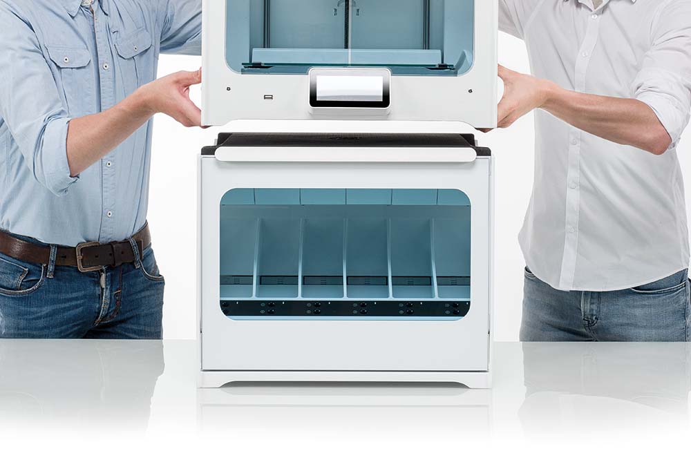

1. Place the printer
Lift up the printer above the Material Station. Align the products and carefully lower the printer.

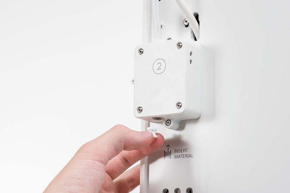

2. Tube coupling collets
Insert a tube coupling collet into the ring at the bottom of each of the printer's feeders.

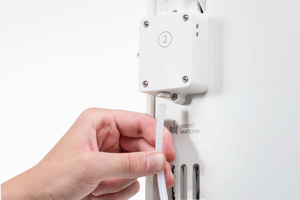

3. Insert Bowden tubes
Insert the left Bowden tube into the left feeder, and the right Bowden tube into the right feeder.

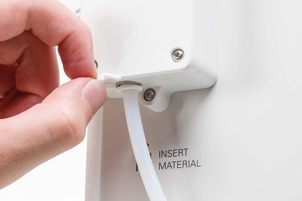

4. Clamp clips
Secure each of the Bowden tubes with a clamp clip.

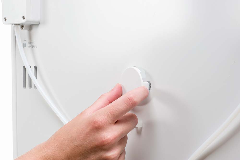

6. Spool holder cap
Place the spool holder cap into the hole for the spool holder in the printer's back panel.

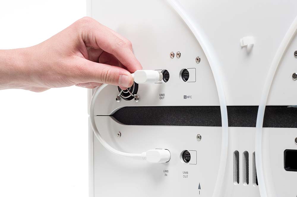

Tip: If the printer has an Air Manager installed, disconnect the Air Manager cable from the printer's UMB OUT port. It will be reconnected to the Material Station.

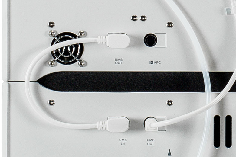

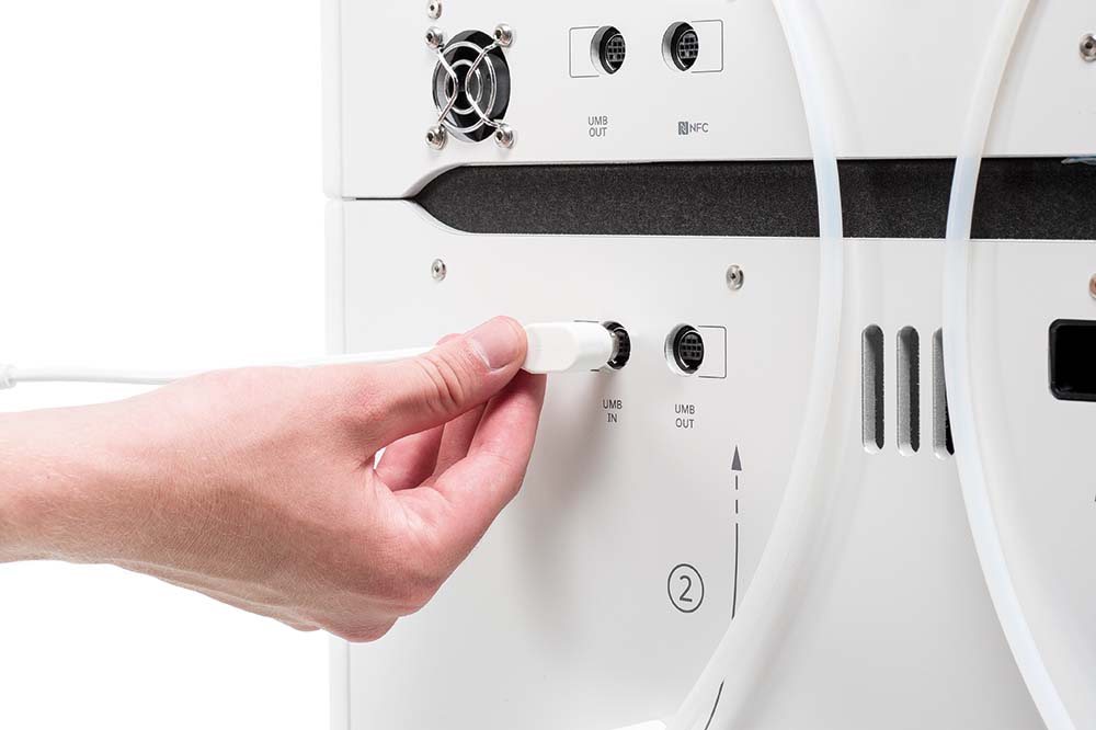

1. UMB IN
Connect the short Material Station (UMB) cable to the UMB IN port at the back of the Material Station.
2. UMB OUT
Plug the other end of the cable into the UMB OUT port at the back of the printer.
3. Air Manager (optional for S5/S6)
Connect the Air Manager cable to the UMB OUT port on the Material Station.

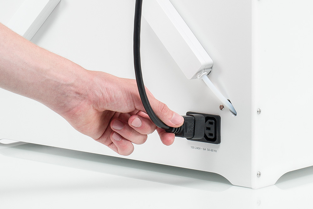

4. Power extension cable
Insert the male end of the power extension cable into the power entry of the printer.

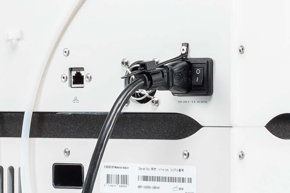

5. Power extension cable
Connect the female end to the right side of the Material Station power entry (as seen from the back).

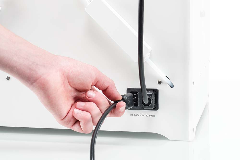

6. Power cable
Connect the power cable that came with the printer to the left side of the Material Station power entry, and the other end to a power outlet.
Caution: A mains socket with a protective earth/ground terminal must be used. Make sure that the building installation has dedicated means of overcurrent and short-circuit protection.
