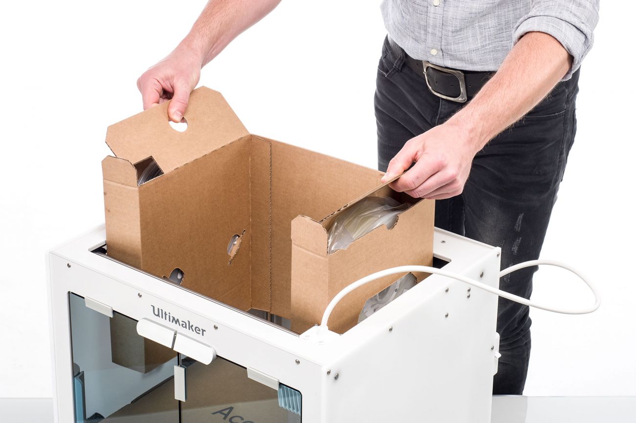

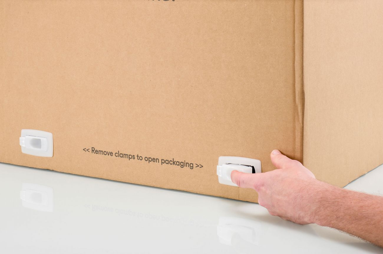

  1. Remove the plastic locking clips from the lower section of the box.
  2. Holding the handles, lift the upper section of the box to reveal the printer.

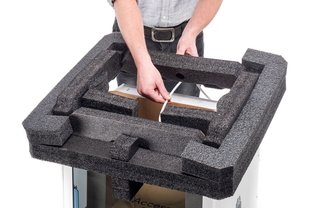

  3. Lift the top foam section away from the printer, pulling the print head cable free.
  4. Remove the cardboard insert with the materials from the top of the printer.

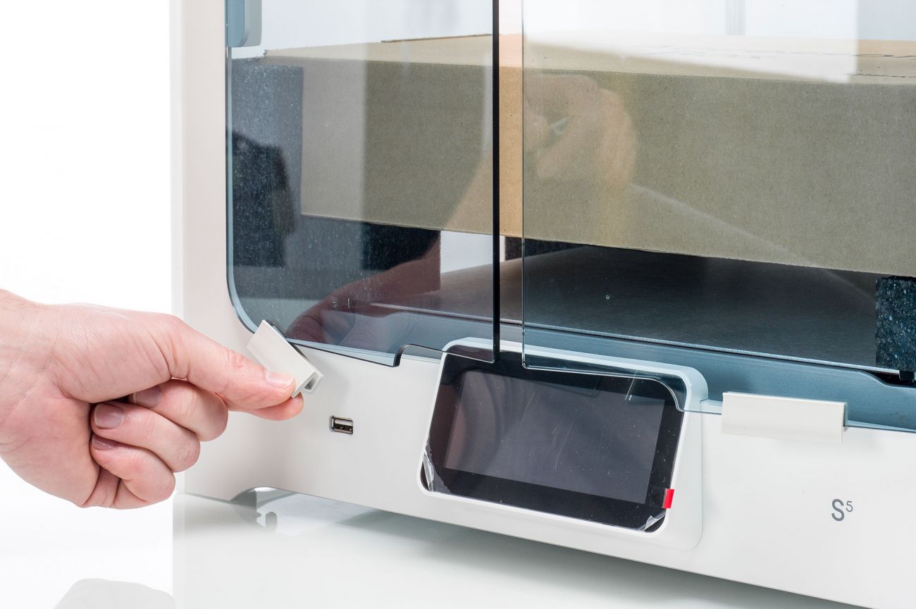

  6. Slide the center seal at the bottom of the glass doors to one side, and then remove all of the remaining seals.
  7. Carefully open the glass doors and take out the accessory box and foam pieces from inside the printer.
  8. Remove the plastic protection from the touchscreen.

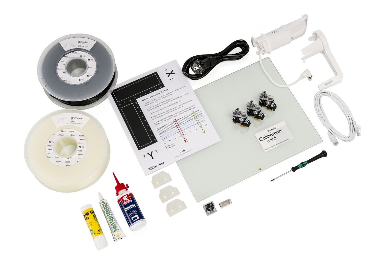

Let's take a look at the items that are included with your UltiMaker S5. The UltiMaker S5 is shipped with several accessories, tools, and consumables. Check if all these items are included before continuing.
AccessoriesConsumablesToolsDocumentation
  • Glass build plate
  • Spool holder with material guide
  • Power cable
  • Ethernet cable
  • USB stick
  • Print core AA 0.4*
  • Print core BB 0.4
  • Nozzle cover (3x)
  • Tough PLA (750 g)
  • PVA (750 g)
  • Glue stick
  • Oil
  • Grease
  • Hex screwdriver 2 mm
  • XY calibration sheet
  • Calibration card
  • Quick start guide
  • Safety and warranty information
Tip: Another print core AA 0.4 is placed in print head slot 1 of the UltiMaker S5.
