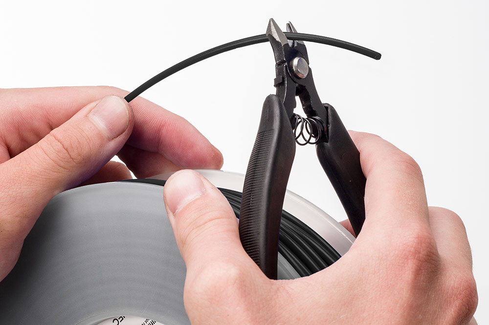

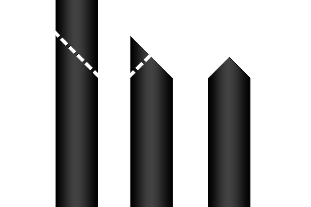

When preparing material for loading into the printer, always cut the end into a short, sharp tip. Use cutting pliers or wire cutters. It is best to do a double cut for a conical tip shape. This ensures that the material can easily enter the feeder and won't get caught on the edges of any components, such as the Bowden tubes.

Remove the packaging from the spool of material. Cut off the end of the filament that is hooked onto the spool. Ensure a nice sharp tip for easy loading. It is also recommended to straighten the end of the filament, so it can easily enter the feeder.

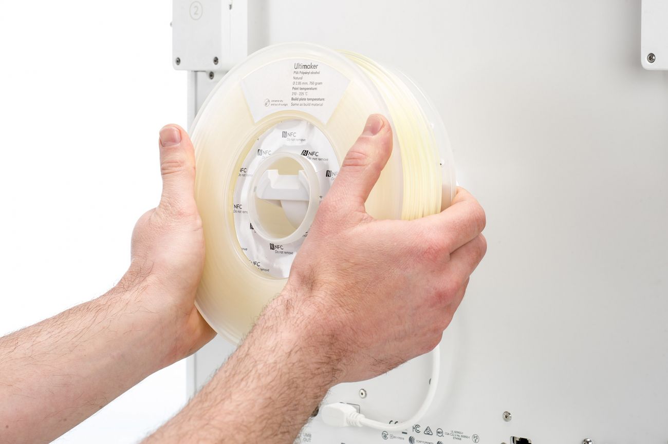

Place the spool on the spool holder at the back of the printer. Ensure that the filament is in a clockwise direction so that it can enter feeder 2 from the bottom.
Wait until the printer has detected the material type. This will only work when using UltiMaker material and if the spool holder cable is connected to the NFC socket at the back of the printer. You can also select the material type manually in the menu.

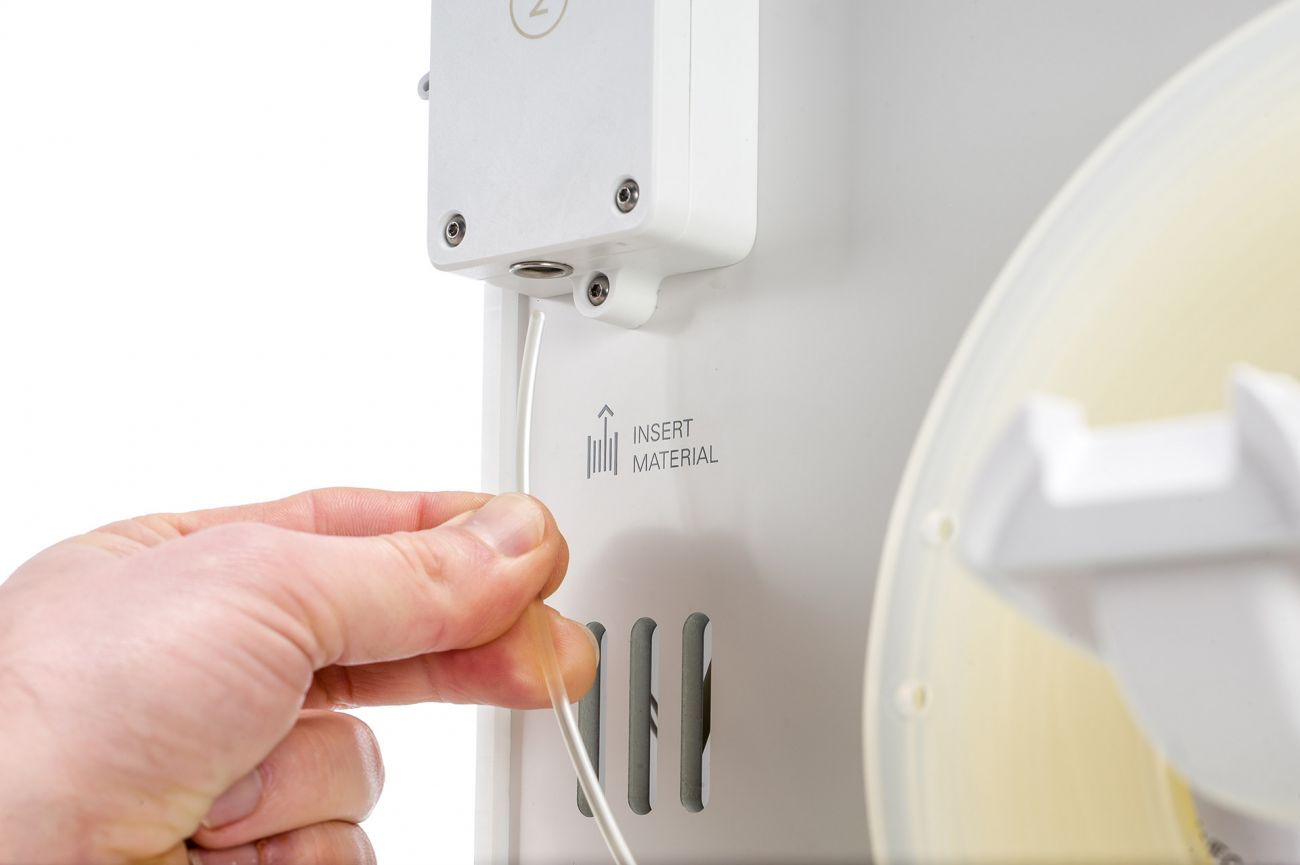

Insert material

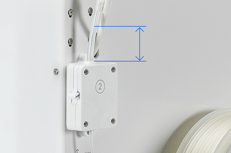

The feeder will start turning slowly. Insert the end of the filament into the bottom of feeder 2. Apply pressure until you feel that the feeder grips the material. The filament will now automatically slowly move upwards.
As soon as the filament is visible in the Bowden tube above the feeder, confirm this using the button on the display.
Note: Do not wait too long before pressing Continue. After this, the printer will automatically forward the filament to the print head. If the material is too far into the Bowden tube, the material will jam in the hot end, and the feeder will grind into the filament. The image below (right) shows the maximum length of the filament in the Bowden tube before it should be forwarded.

Like the other spool, cut off the end of the filament into a nice, sharp tip and straighten it a bit.

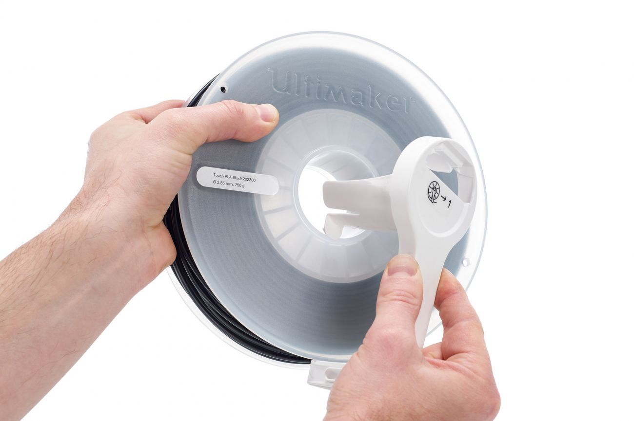

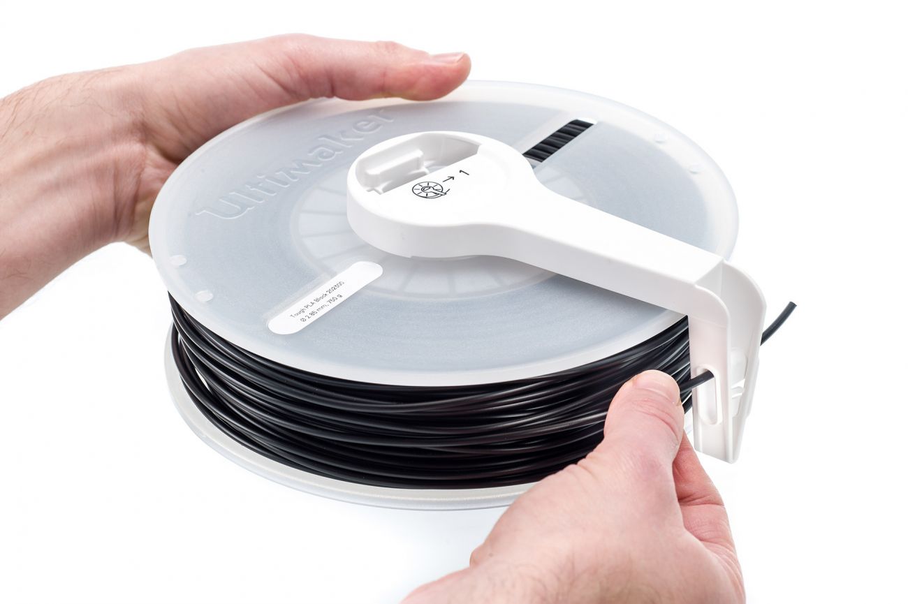

Now take the material guide and hold it with the outer part towards you. Place the material spool on the material guide with the material in counter-clockwise direction.
Guide the end of the material through the hole in the material guide. When you have done this, select Confirm.

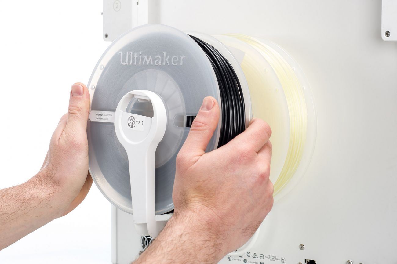

Place the material guide - with material 1 on it - on the spool holder, behind material 2, and wait until it is detected by the printer. Alternatively, manually select the material type in the menu.

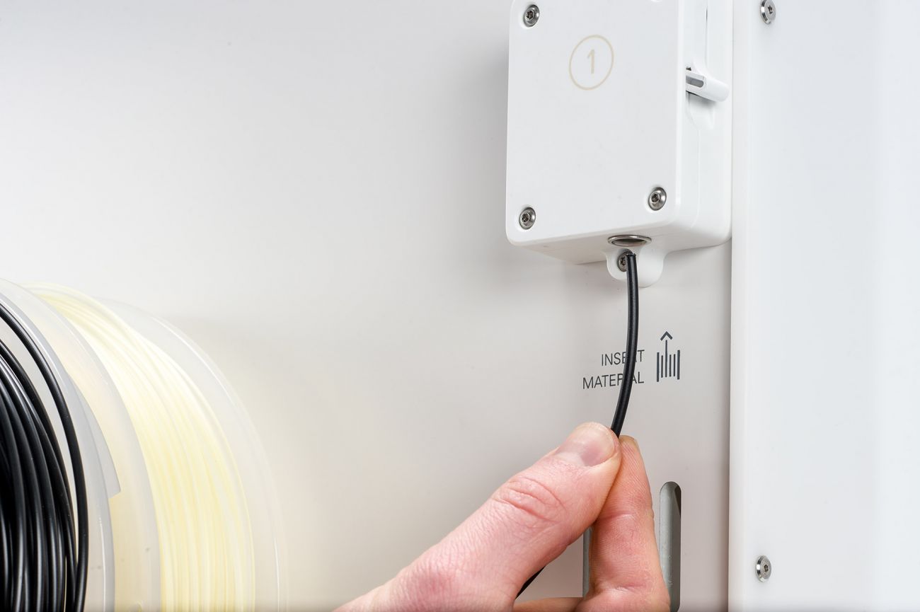

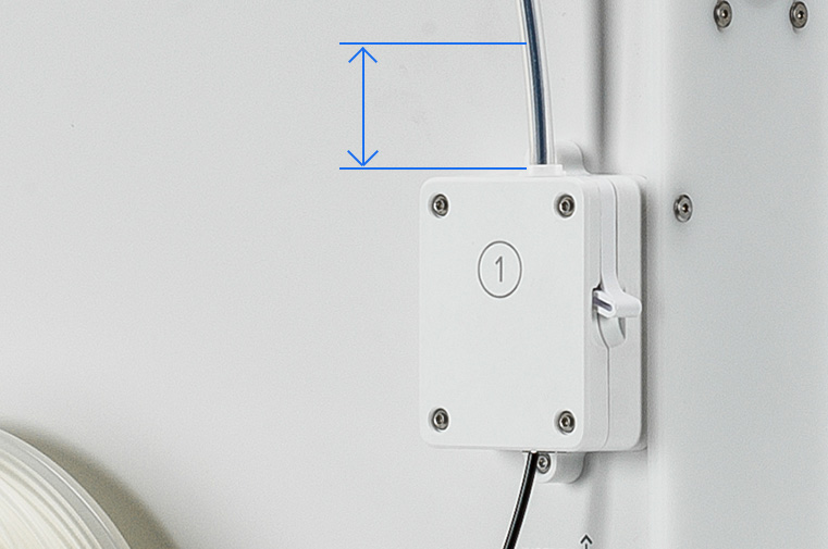

Feeder 1 will start spinning slowly. Insert the end of the filament into the bottom of feeder 1. Apply pressure until you feel that the feeder grips the material. The filament will now automatically slowly move upwards.
As soon as the filament is visible in the Bowden tube above the feeder, confirm this using the button. Again, ensure not to wait too long to prevent the material from getting stuck.
