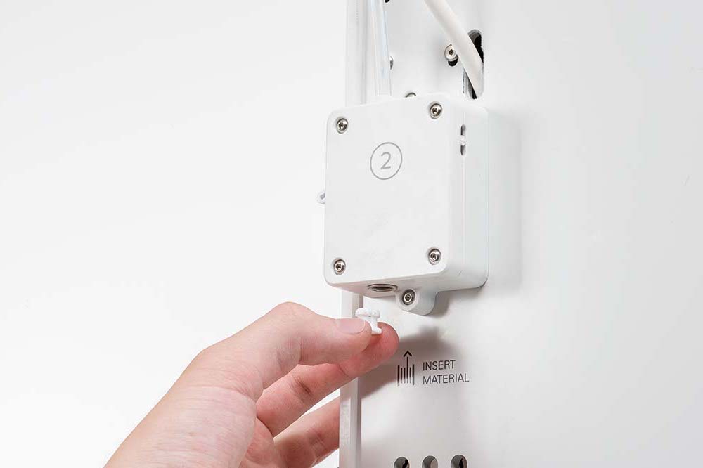

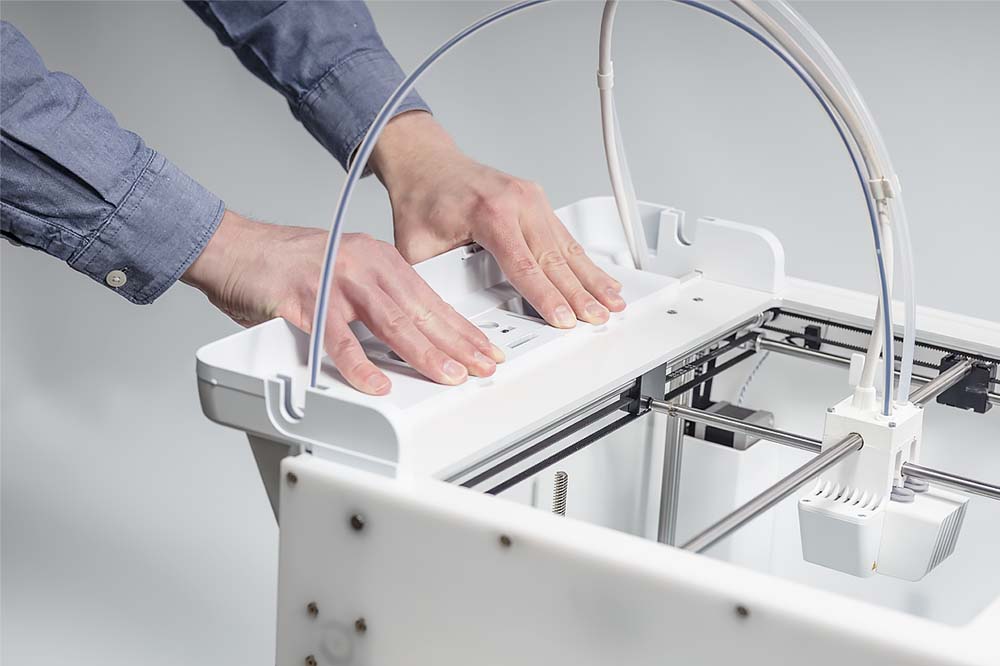

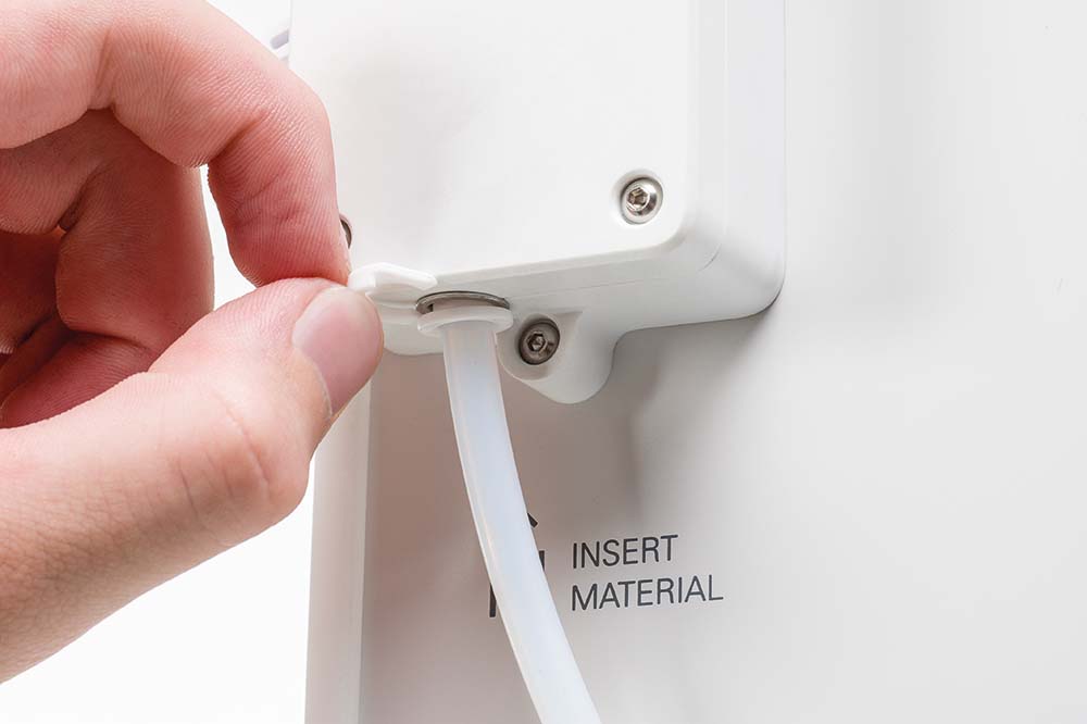

2. Tube coupling collets
Insert a tube coupling collet in the bottom of each of the two feeders.
3. Insert Bowden tubes
Insert the left Material Station Bowden tube into the left feeder, and the right Bowden tube into the right feeder.
MS-Installation-Step4.jpgSpool holder cap
Tip: The cable connections will be explained later, in the Connections section of this article.
Note: Ensure that the Bowden tubes are routed to the correct feeders, that they are fully inserted into the feeders, and that there is nothing restricting the movement of the tubes (the Bowden tubes must be able to move up and down during printing.
4. Clamp clips
Place a clamp clip around each collet in the bottom of the feeders to secure the Bowden tubes.

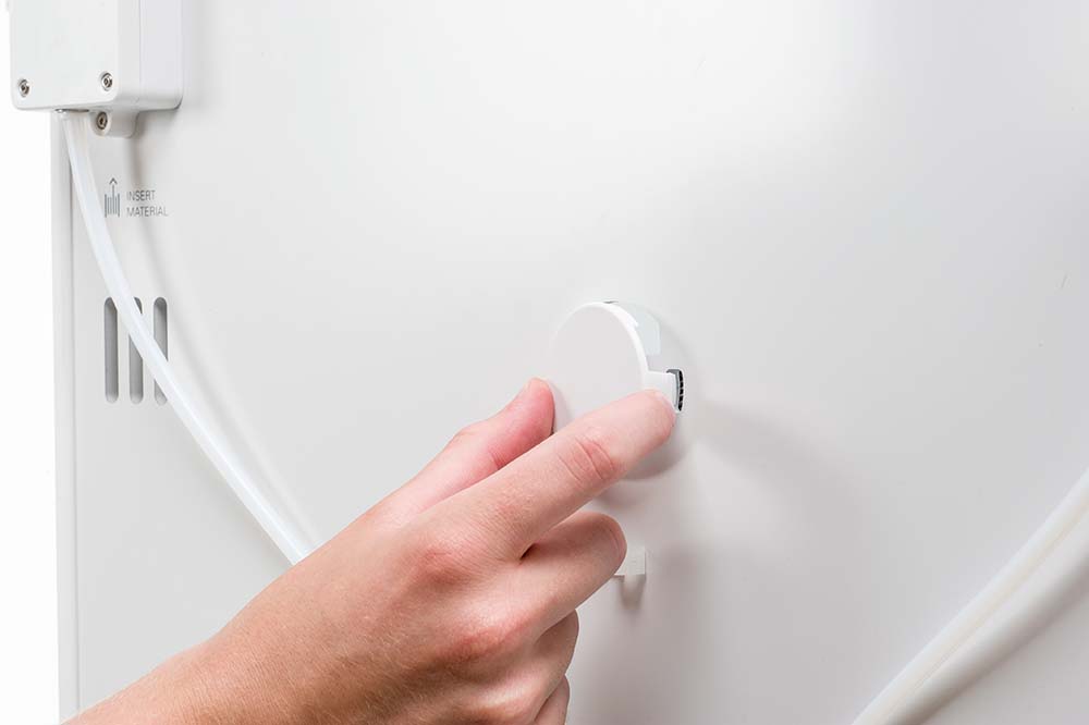

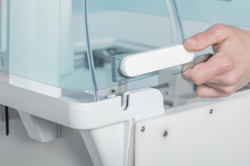

5. Spool holder cap
Place the spool holder cap into the hole for the spool holder in the printer's back panel.

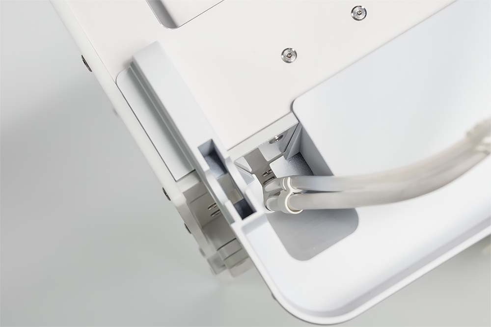

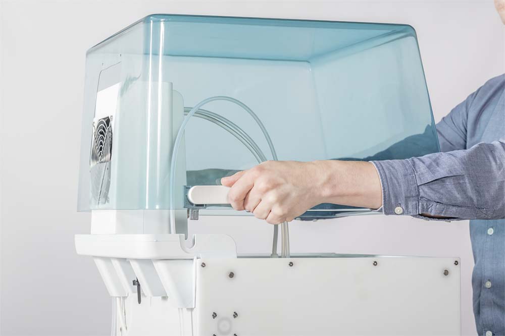

1. Mounting bracket
Align the mounting bracket with the back of the printer.

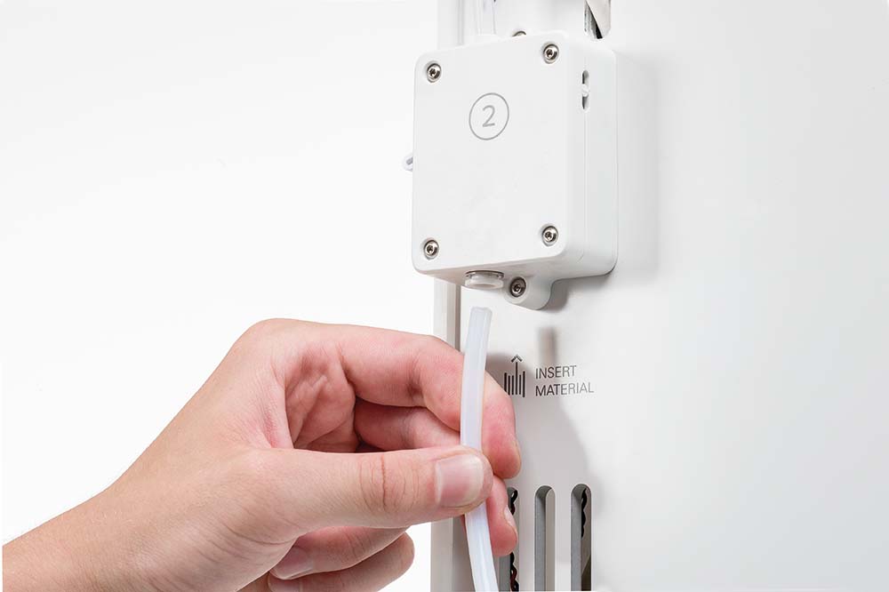

2. Bowden tubes
Guide the Bowden tubes into the mounting bracket slots. Ensure that Bowden tube 2 is placed in front of the print head cable.
3. Fix the mounting bracket
Gently push down on the mounting bracket until it clicks firmly into place.
S5-Air-Manager-QSG-4-Filter-housing.jpgS5-Air-Manager-QSG-5-Filter.jpgS5-Air-Manager-QSG-6-Cover.jpg

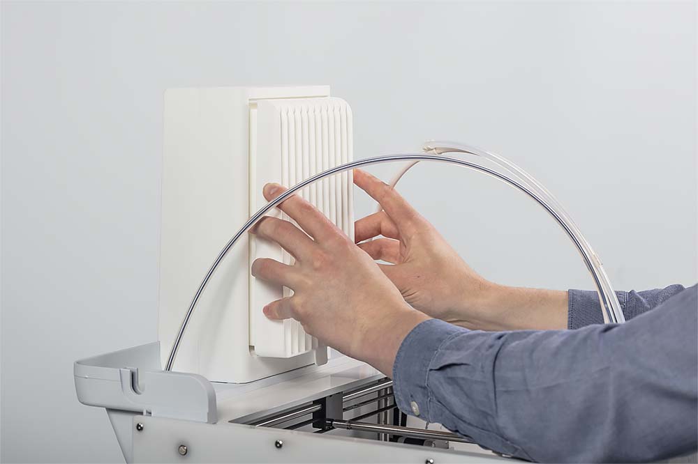

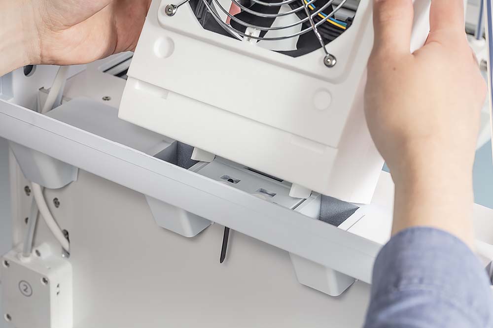

4. Filter housing
Align the bottom of the filter housing with the slots in the mounting bracket and push into place.
5. Filter
Align the filter with the housing, with the tab toward the bottom. Push it fully in place.

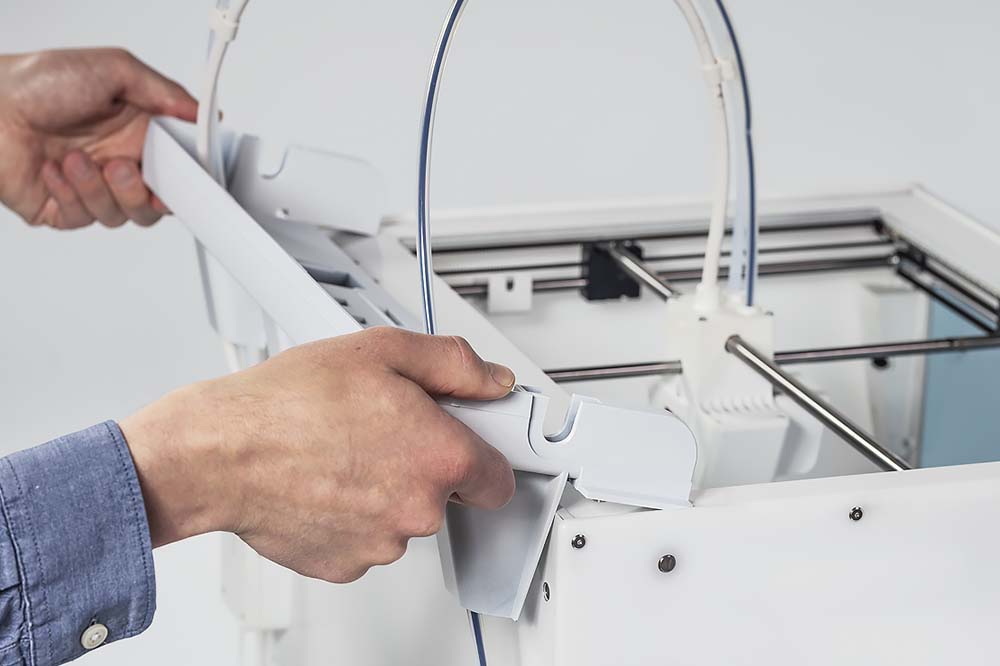

6. Cover
Lift the cover using the handles on each side, and place it over the filter housing.
Note: Ensure the hinges are fully inserted. If necessary, open the cover and push on each until you hear it click into place.
Note: When the Air Manager cover is closed, make sure that it is aligned well with the printer's frame and that there are no gaps.
7. Hinges
Align the hinges on the cover with the slots in the mounting bracket and drop the cover into place.

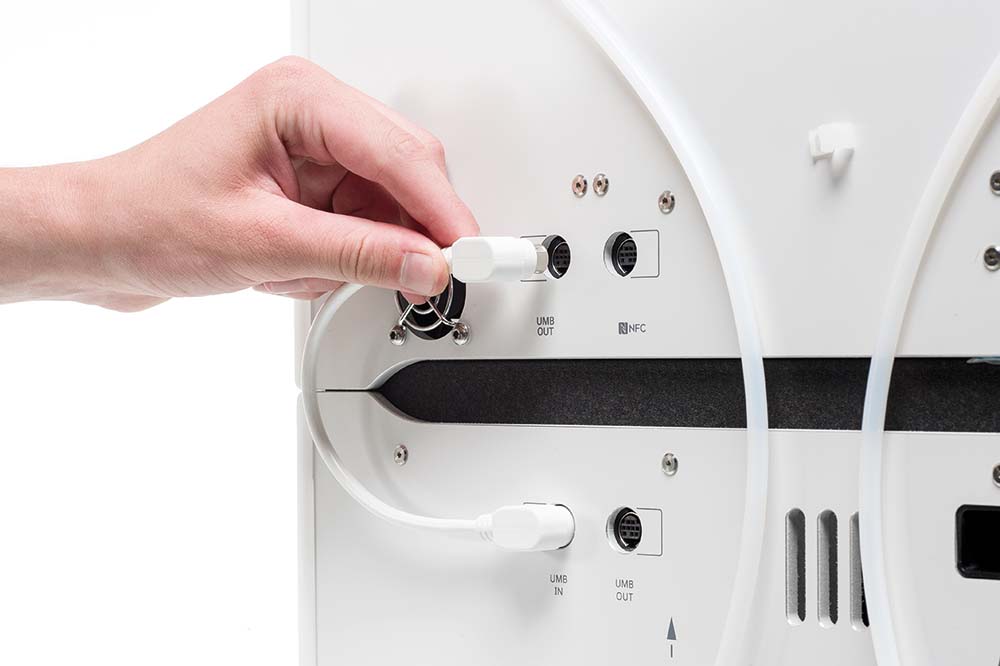

Connections
Finally, connect all the cables to complete the installation of the Pro Bundle. You will need the short white Material Station cable, the longer white Air Manager cable, the power extension cable, and the power cable.
Tip: For the UltiMaker S7 and S8, the Air Manager cable is already connected to the Air Manager electronics at the top of the printer frame and secured to the back panel. Some steps can be skipped; these are indicated as "add-on only".

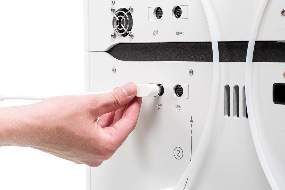

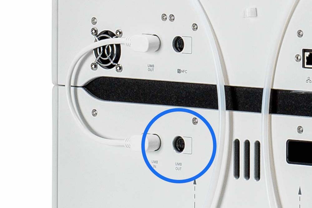

1. Material Station cable - UMB IN
Connect one side of the short Material Station cable to the UMB IN port at the back of the Material Station.
2. Material Station cable - UMB OUT
Plug the other end of the cable into the UMB OUT port at the back of the printer.

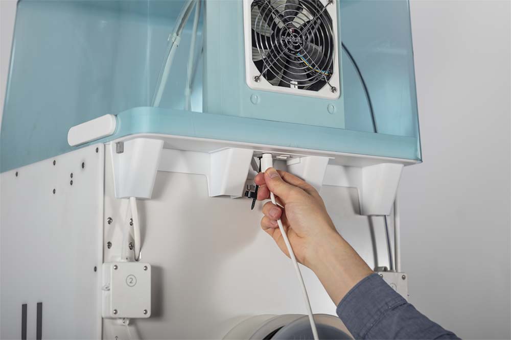

3. Air Manager cable (add-on only)
Connect the longer Air Manager cable to the port at the back of the Air Manager.
S5-Air-Manager-QSG-10-Strain-relief.jpgAir-Manager-cable-clips.jpgUMB-OUT-Material-Station.jpg

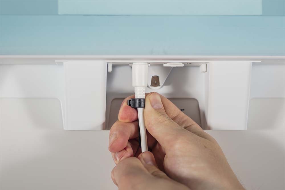

4. Air Manager cable (add-on only)
Secure the cable with the stress relief clip. Place the clip around the cable and slide it upwards.

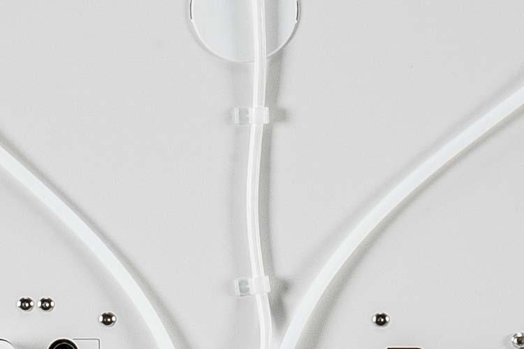

5. Air Manager cable (add-on only)
Place the Air Manager cable behind the plastic clips in the S5 or S6 back panel.
6. Air Manager cable - UMB OUT (both variants)
Connect the end of the Air Manager cable to the UMB OUT port at the back of the Material Station.

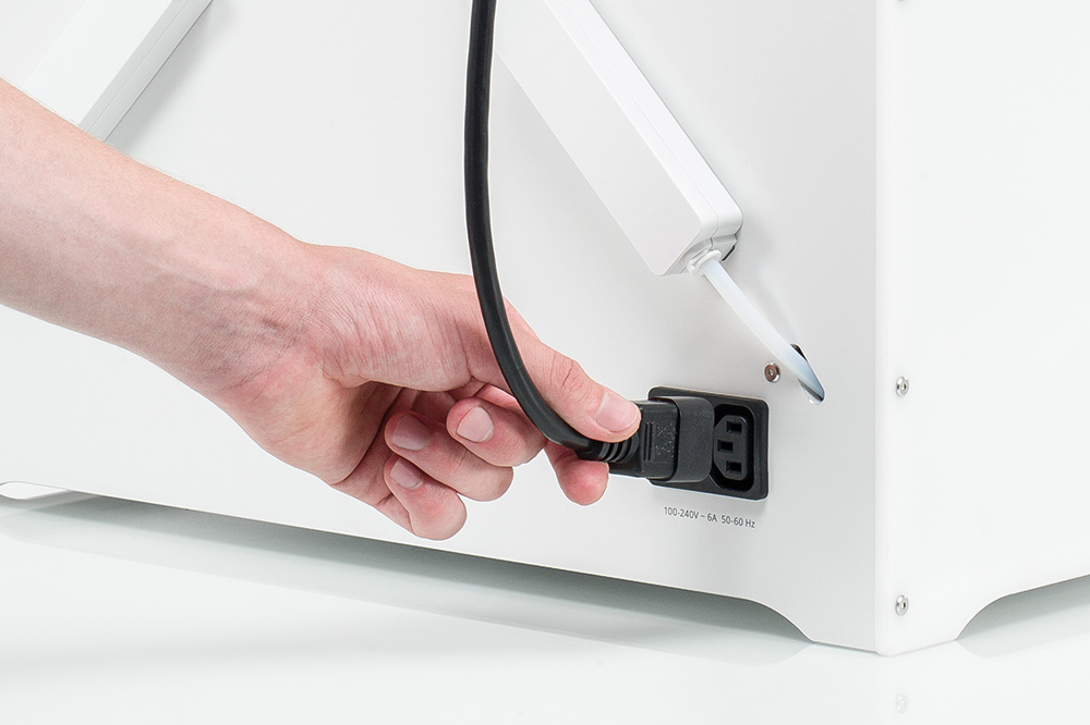

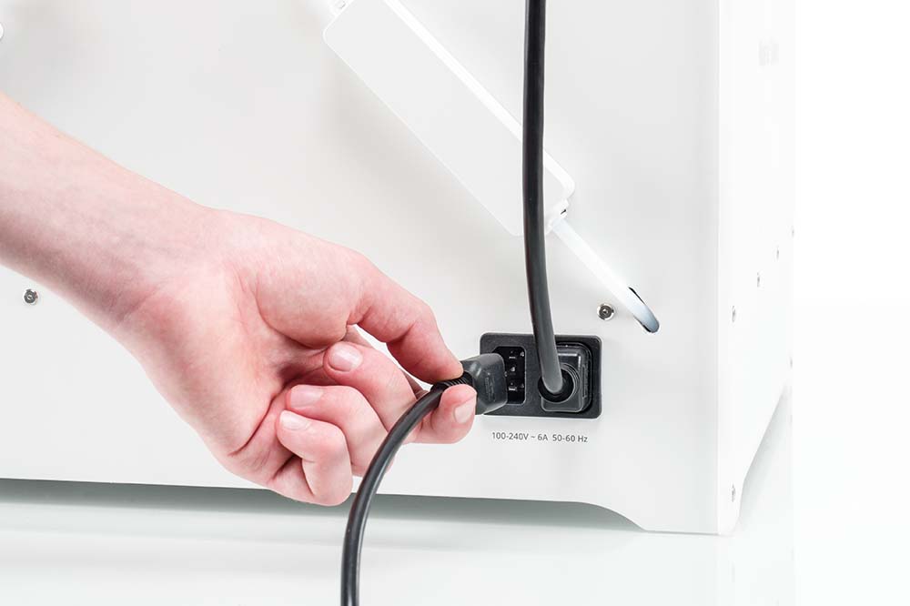

7. Power extension cable
Insert the male end of the power extension cable into the power entry of the printer.
8. Power extension cable
Connect the female end to the right side of the Material Station power entry (as seen from the back).

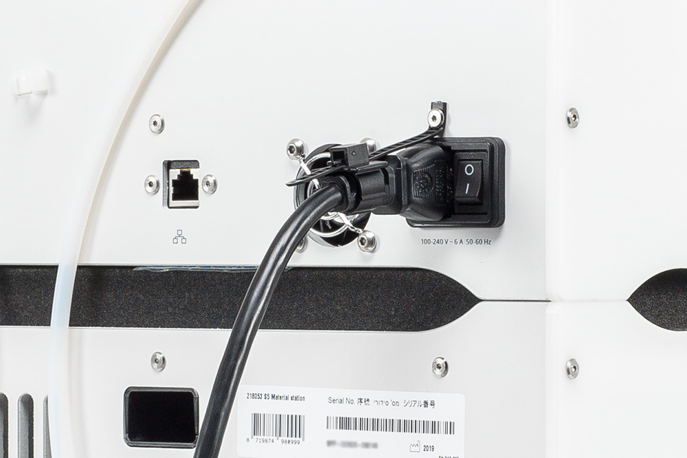

9. Power cable
Connect the power cable that came with the printer to the left side of the Material Station power entry, and the other end to a power outlet.
Caution: A mains socket with a protective earth/ground terminal must be used. Make sure that the building installation has dedicated means of overcurrent and short-circuit protection.

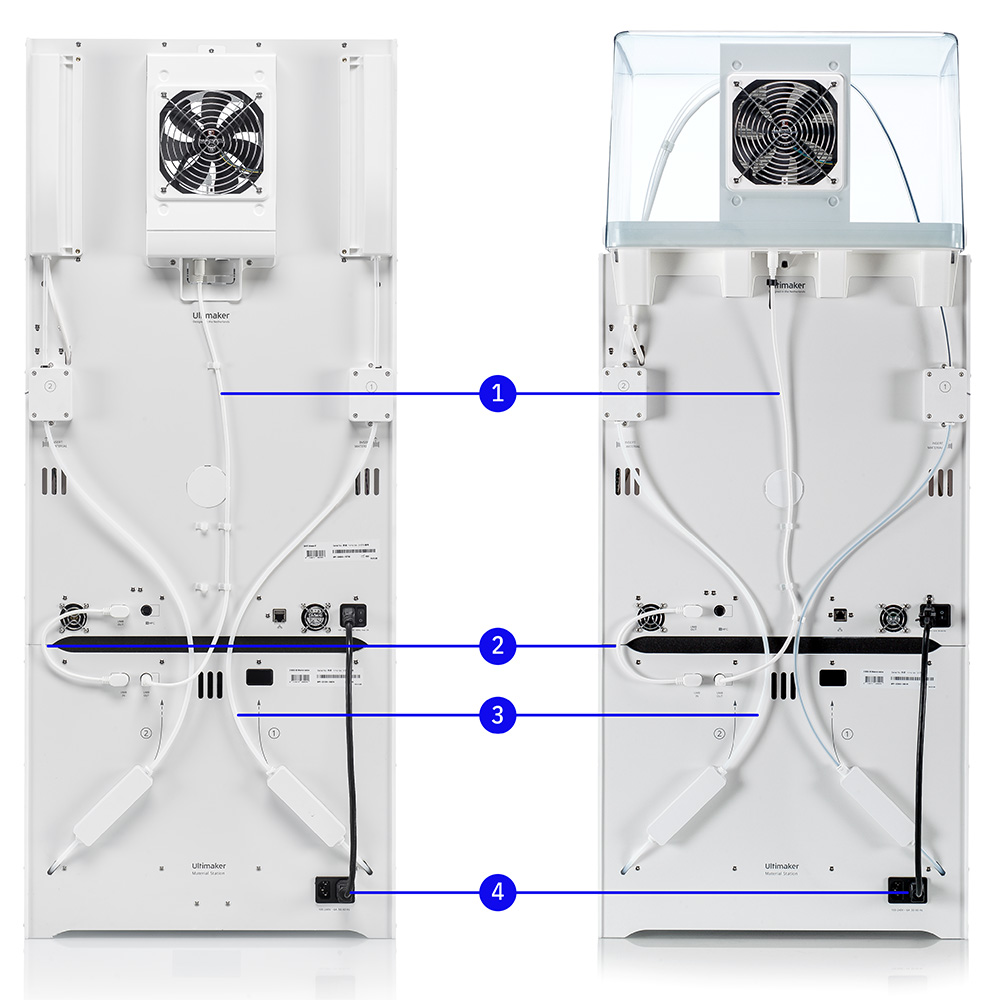

Connection overview
See the reference images below (left = S7 and S8, right = S5 and S6) to check if everything is set up and connected correctly.
1. Air Manager cable
The cable for the Air Manager must be securely connected to the bottom of the Air Manager and to the UMB OUT port of the Material Station. The cable can be secured behind the clips in the printer's back panel.
For the UltiMaker S5 and S6: The clips that were included with the Air Manager accessories are not used in the complete Pro Bundle setup.
For the UltiMaker S7 and S8: The cable is already secured behind the clips at the factory.
The short Material Station cable runs between the UMB IN port of the Material Station and the UMB OUT port of the printer.
3. Decoupler Bowden tubes
Ensure that the Bowden tubes are inserted into their respective feeders and secured with the clamp clip.
The Bowden tubes must not be secured to each other or any cables. They should be able to move freely.
4. Power cable
The power extension cable is connected between the Material Station and the printer. The power cable that was included with the printer is connected to the Material Station and a (wall) socket.
