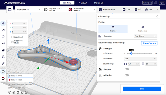

How to prepare a print in UltiMaker Cura desktop
UltiMaker Cura is a powerful and user-friendly desktop slicing application. It is free to download and use. Prepare your 3D model for print in minutes with recommended settings; simply choose speed and quality settings, and you can start printing. Or switch to the Custom mode, which gives over 400 settings for granular control.
Tip: For the best printing results, always use the latest version of UltiMaker Cura. For more information about using UltiMaker Cura and system requirements, please see the Cura section of the support pages.
1. Add your printer
When you use Cura for the first time, complete the first-run experience. If you sign in to your UltiMaker Account, you can add any printers already connected to your Digital Factory workspace. If your UltiMaker S series printer is not connected yet, set it up via the Digital Factory option on the printer, or add the printer manually from the list of non-networked printers.
If you're already working with Cura, but want to set up a new machine, click on the Printers panel in the interface, and select Add printer. If you are signed in with your UltiMaker account and have already connected your new printer to your Digital Factory workspace, it will be added to Cura automatically.

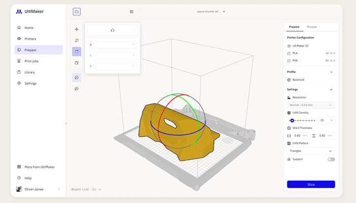

2. Prepare your print
Start by loading a 3D model (or several). You can click the folder icon to load a file from your computer or a Digital Factory project, or drag a file onto the build plate. Next, in the Configuration panel, select your print cores and materials. Use the Adjustment tools on the left side to position, scale, and rotate the model as desired. Select your intent profile, resolution, and desired settings in the Print settings panel on the right side. You can now press the Slice button in the action panel.
Tip: Always check the Preview mode to see how the model will be printed. This helps validate your printing strategy and prevent unexpected problems.
3. Start the print
After slicing, you can start the print via the action panel. Send your print job via cloud if the printer is connected to the Digital Factory, via network if the printer is connected via LAN, or save the file to a USB drive for printing with offline printers.
Note: When printing via USB, always ensure to safely eject the USB device to prevent corrupting print files.
How to prepare a print in Cura Cloud
Digital Factory's Cura-powered cloud slicer lets you prepare and optimize 3D models from anywhere. Slice files directly in the cloud and send them to your UltiMaker printers with ease — no installations needed. Enjoy the trusted precision of Cura with the flexibility of cloud access, streamlining your 3D printing workflow like never before.
Tip: First set up your workspace and printers in the Digital Factory for a fully cloud-based workflow. However, you can also use Cura Cloud without connecting any printers and save to USB instead.
In your workspace, select the Prepare section on the left side to open the Cura Cloud slicer. Click the folder icon in the top bar to import a 3D file (from your computer or a Digital Factory project). On the right side, select your printer and configuration. Underneath, you will find a profile selection and several basic settings that can be adjusted. If needed, you can move, rotate, or scale your model with the tools on the left side.
Click the Slice button to process the model. Afterward, the Preview mode will be opened to show a print visualization. If you're happy with the results, press Queue to send the print directly to a printer. Alternatively, save the print file to a Library project for later or download it for offline printing.
Tip: For a detailed, step-by-step explanation of preparing a model with Cura Cloud, please visit this article.

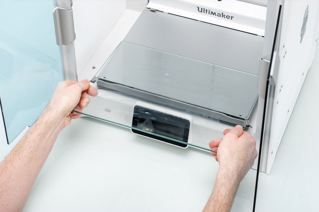

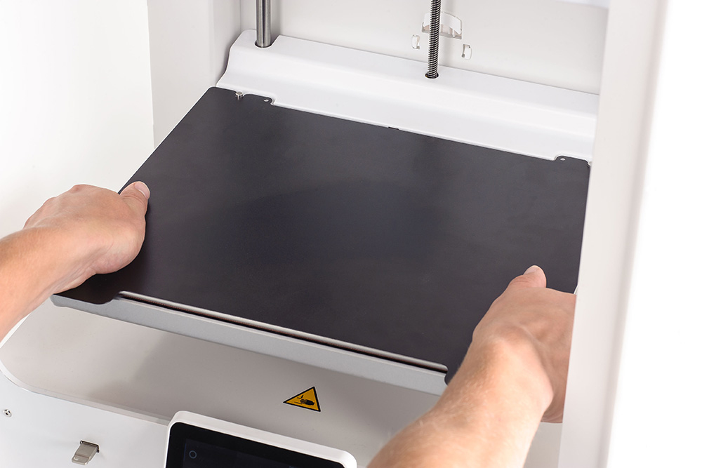

Ensure that the build plate is correctly installed. Printers with a flexible build plate (S6 Flex, S7, and S8) have a build plate detection sensor that prevents print jobs from starting if the build plate is not installed. However, always ensure it is properly aligned to prevent leveling issues. Printers with a glass build plate (S3, S5, and S6 Glass) do not have such a sensor. Never start a print without the glass build plate in place, as this will damage your printer.

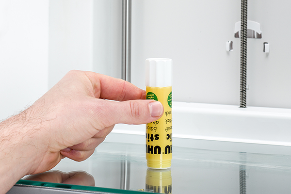

Additionally, ensure that the build plate is properly cleaned and, if necessary, that an adhesive is applied correctly.
Tip: See an overview of the recommended adhesion methods per material and build plate type here: What type of glue should I use for build plate adhesion?

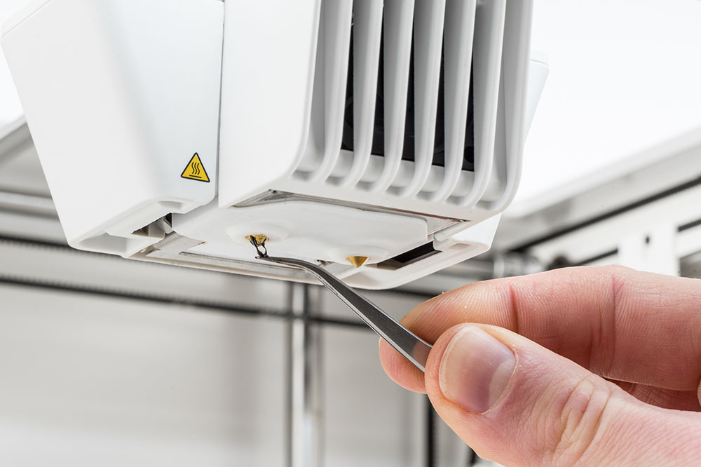

Print cores
Besides ensuring that the correct print core types are installed in the print head, also check that:
  • The nozzle tips are clean. Any blobs of material or bits of carbonized filament stuck to the nozzles may cause problems with the active leveling process or get stuck in your print.

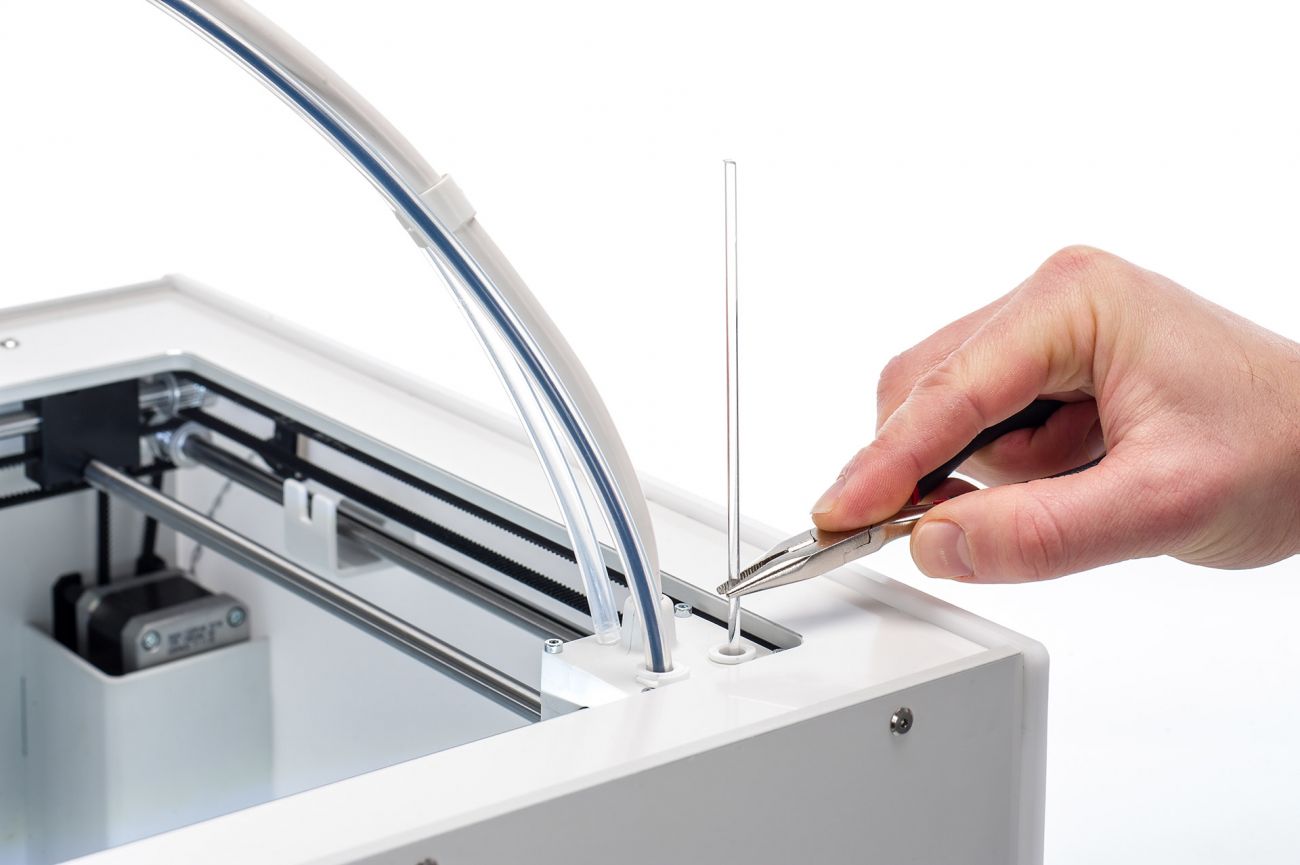

  • The print cores are not blocked. If your previous print showed signs of underextrusion or was interrupted by extrusion errors, this indicates that there might be a (partial) clog in the print core. Clean the core(s) using the hot and cold pull method. If the previous print used a very different material type, you may want to clean the core preventively.

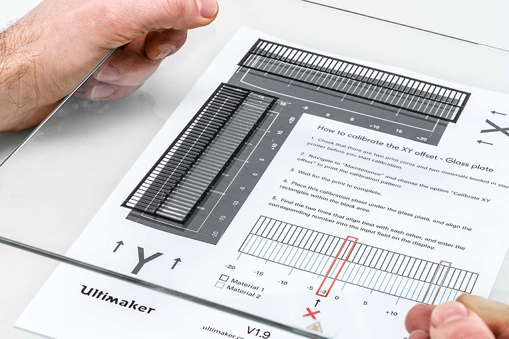

  • The print core combination is calibrated. For dual-extrusion prints, it is important that the two materials align well. Run an XY calibration if the printer indicates this is missing.
  • The nozzle cover is placed correctly and in good condition. The nozzle cover protects the print cores from cold airflow from the fans, and against backflow of material into the print head if something goes wrong. Regularly check the nozzle cover and never start a print if this part is missing.
Tip: Not all the points listed above have to be checked before every print. As a general recommendation, always follow the advised schedule for preventive maintenance.
