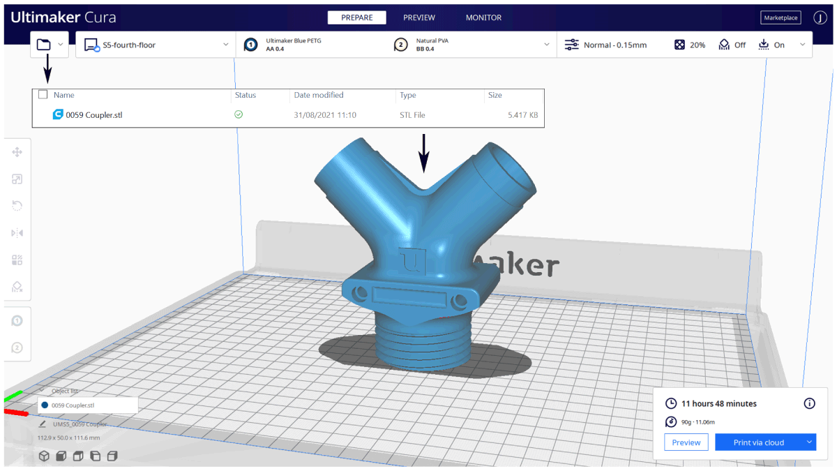

Open 3D files
The easiest way to open 3D models is by the ‘open file’ button. The button is in the top left corner and is the first button in the stage menu. Select the model you want to prepare for printing and open it. The model will now be loaded and shown on the 3D viewer.
