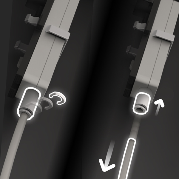

  1. Remove the clamp clips from the top and bottom of the feeder.
  2. While pressing down on the tube coupling collet, pull the Bowden tube out of the feeder. Do this for both the top and bottom of the feeder.

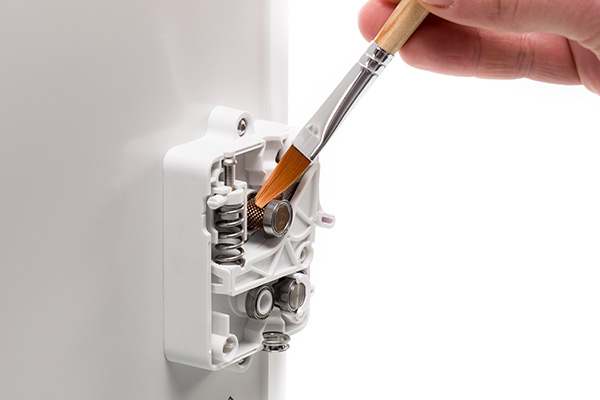

  1. Use tweezers to remove any pieces of filament that are stuck inside the feeder, and use a small brush to clean the knurled wheel and remove any debris from inside the feeder.

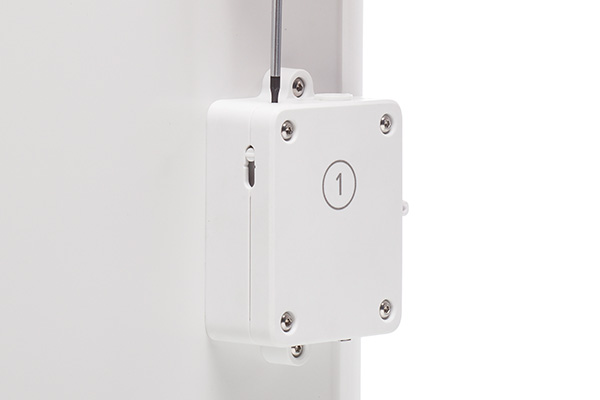

Adjust the feeder tension by turning the bolt in the top of the feeder housing using a 2 mm hex key or screwdriver. When the feeder tension is correct, select Confirm to proceed.

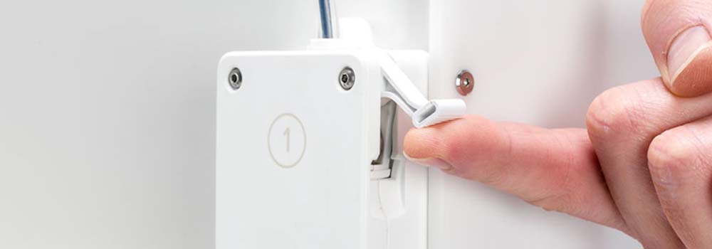

4. Open the feeder lever
After performing the checks on the feeder and Bowden tubes, the Material Station will rewind the spool retract the material back into the Material Station. Only the prefeeders will be engaged, not the feeder at the back of the printer. Make sure that the lever on the side of the feeder is in the open position (up). Select Confirm to continue.

6. Close the feeder lever
To ensure that the material can be successfully reloaded, make sure to close the feeder lever again (down). Select Confirm to continue once the feeder lever is fully closed.
Note: If you forget to close the lever, the loading will fail again.

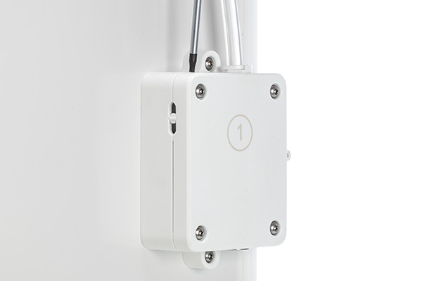

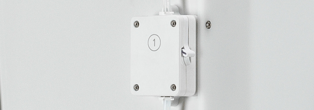

  1. The prefeeders for the affected extrusion paths have been disengaged; they will not grab material as you insert it. Pull out any preloaded materials from the affected ports (1 or 2).
  2. Locate the decoupler of the affected extruder path (1 or 2) at the back of the Material Station.

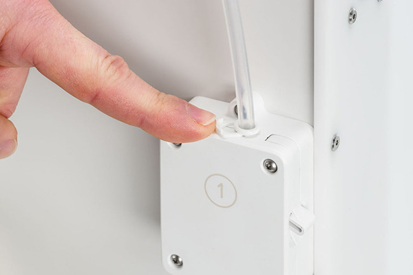

  3. Remove the clamp clip from the bottom of the decoupler.

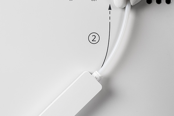

  4. Remove the Bowden tube from the bottom of the decoupler. Push on the collet while pulling the tube out.
Note: Removing the Bowden tube from the bottom prevents potentially pushing broken pieces of material into the decoupler. However, there is very little space below the decoupler. If this is too difficult to do, you can also remove the Bowden tube from either the top of the decoupler or the bottom of the feeder.

  4. Re-attach the Bowden tube to the bottom of the decoupler (or from where you removed it). Ensure to fully push it in, until it really cannot go any further.
  5. Secure the tube with the clamp clip.

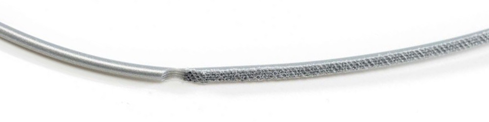

8. Inspect the filament
After the spool in the affected bay was unloaded, inspect the material for signs of grinding and damage. If you reload the material with a damaged section, the loading process will likely fail again. Look closely at the length of filament that was fed into the system, and cut off a section if it looks damaged.

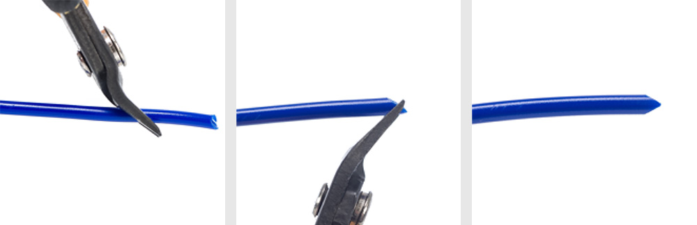

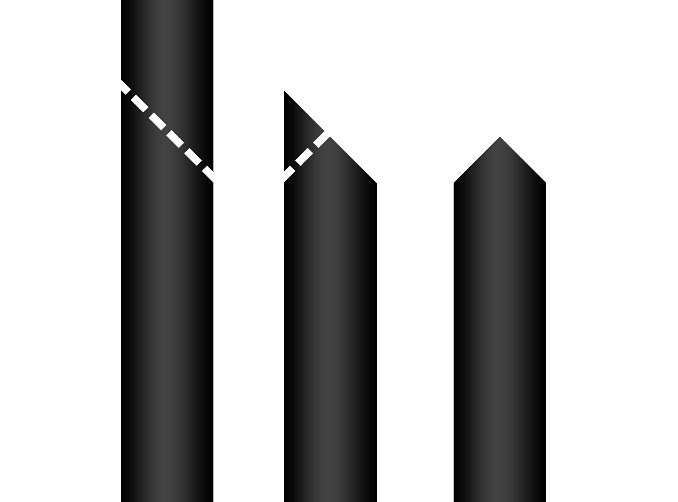

9. Prepare the material
A proper tip shape on the material is crucial to ensure successful loading. If the end of the material is flattened, widened, or has sharp edges, it may get caught on something as it travels through the system. For example, when it enters a new Bowden tube.
Use cutting pliers or wire cutters to cut the end of the filament into a nice sharp tip.
Tip: A double cut is recommended for the best results. Cut the filament at an angle, then cut it again from the other side, ensuring a conical tip shape. Select Learn how on the display for additional instructions.

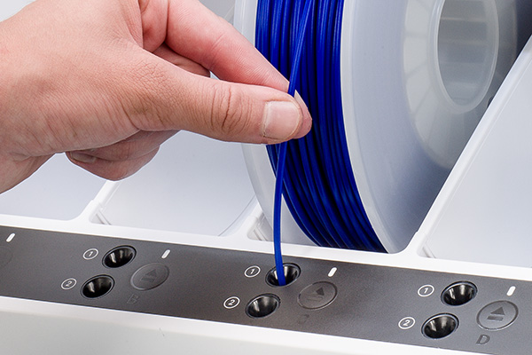

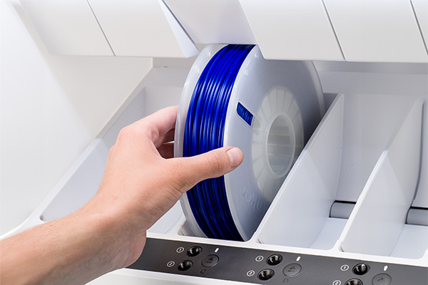

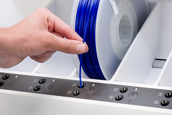

10. Reload the material
If you have removed the spool from the Material Station, place it back into the material bay. The printer will indicate which material bay was active. Place it back in the same one, as this material bay will be reactivated after this step. Insert the filament in the entry port. You can also reload any materials that you may have removed during the previous cleaning steps.

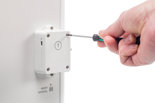

Factor 4
On Factor 4, the material loading failure recovery will show the following steps:
Tip: The recovery process will be done for just one of the extruders; the display will indicate which one. In this article, extruder 1 is used as an example. Replace the steps for extruder 2, if this is where your material failed to load.
Check if the filament reached the print head
This helps determine the filament's position and where the loading could have failed. If you can see the filament in the Bowden tube entering the print head, select Yes. If the material has not fully reached the print head, or you do not see the filament at all in the Bowden tube in the build chamber, select No.
Clean the feeder
If you pressed Yes (the filament has reached the print head and is visible in the Bowden tube), the procedure will instruct you to clean the feeder in the print head.
Tip: If you pressed No (the filament is not visible above the print head), this step will be skipped; the process will guide you to the next relevant step (removing the back cover panel), see below.
  1. Open the feeder: Loosen (but do not remove) the small screw at the top of the feeder lever. Pull the lever towards you to open the feeder.
  2. Detach the Bowden tube: Push down on the white Bowden release clip and pull the Bowden tube out of the print head. The left Bowden tube is for extruder 1.
  3. Check the filament in the feeder: If the material is visible in the feeder, press Yes to start the cleaning process. It is strongly advised to follow the cleaning step, even if you are not sure of you see the filament in the feeder.
  4. Clean the feeder wheels: Pull the filament out of the print head. Use a small brush to clean the wheels inside the feeder.
  5. Cut the filament: To ensure a more reliable loading process, use cutting pliers to cut the filament sticking out of the Bowden tube. Cut close to the end of the tube (about 5-6 mm, or ¼ in), but be careful not to damage the Bowden tube. Make a double cut on the filament to ensure a nice pointy tip.
  6. Close the feeder: Push the feeder lever closed again, ensure it is well aligned and fully closed, and turn the thumbscrew at the top of the lever to lock it in place.
  7. Reattach the Bowden tube: Firmly push the Bowden tube into the print head again.
The material will now retract back into the Material Station, and the recovery process is complete. You can now try loading the material to the print head again by pressing Continue.
Tip: You do not have to follow the rest of the steps listed below if cleaning the feeder has resolved the problem.
Filament has not reached the print head
If the filament is not visible in the Bowden tube above the print head, it is likely that the material got stuck earlier in the path between the Material Station and the print head. The other components (decoupler and merger) are hidden behind the printer's back cover panel.

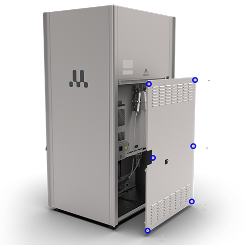

Remove the back cover panel
To further troubleshoot, the cover panel must be removed.
Note: The electronics and power supply are also located behind the panel. Do not touch these components with the panel removed and the printer still on. Always check local regulations before removing the back cover panel.
Tip: Ensure you have sufficient space to access and work behind the back of the printer. If the Factor 4 must be moved or rotated, do this safely.
Use a Hex 2 screwdriver to remove the six M4×10 bolts that secure the back cover panel. Carefully move the panel away from the printer and place it aside.

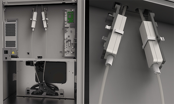

Check the decoupler
The next step is looking for the tip of the filament to see where the loading process got stuck. First, check if the material has reached the decoupler. The decouplers are the white rectangles at the top (decoupler 1 is on the right, as seen from the back). Can you see the filament enter the decoupler?
Check and clean the decoupler
Select Yes if the filament has entered the decoupler, but did not proceed past it toward the print head. In this case, there could be something stuck inside the decoupler mechanism, blocking the filament.
Tip: If you pressed No (the filament is not visible in the decoupler), the process will guide you to the next step (checking the merger), see below.

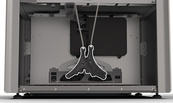

First, the filament will retract back into the Material Station; wait a moment until this process is finished. During the next steps, you will disconnect the decoupler Bowden tubes and manually feed through some filament.
  1. Disconnect the decoupler from the merger: Firmly push down on the collet at the top of the merger. The top one, with the exit on the right as seen from the back, is the merger for extruder 1. Note that pressing on the collet takes quite some force. While pressing down, pull the Bowden tube out of the merger.
  2. Remove the Bowden tube from the print head: Push down on the white Bowden release clip and pull the Bowden tube out of the print head. The left Bowden tube, as seen from the front, is for extruder 1.
  3. Feed material through: Insert a rigid, non-brittle filament* into the end of the Bowden tube you just removed from the print head. Push the filament all the way through, until it comes out of the decoupler. Keep pushing until the filament exits from the Bowden tube to push out any broken pieces of filament.
  4. Reattach the tubes: Pull the filament back out of the Bowden tubes. Reattach the Bowden tubes to the merger and the print head.
Press Confirm to proceed to the next and last step: reinstalling the back panel. See the instructions below.
*Note: Do not use flexible filaments, such as TPU, as these are hard to push through. Also, avoid using potentially brittle materials, such as PVA or old, improperly stored filaments, as these might break inside the tubes or decoupler, making the problem worse.

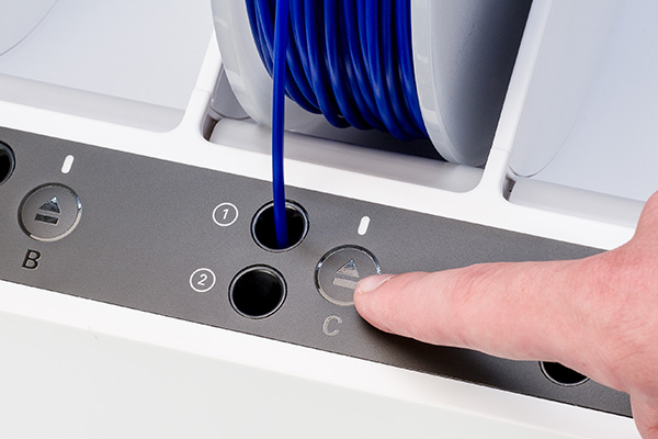

At the front of the printer, insert a rigid, non-brittle filament* into bay A, entry port 1. Push the filament all the way through, until you either feel too much resistance, or when the top of the filament comes out of the Bowden tube end. Pull back the material, and move on to bay B. Perform this for all material bays, and repeat the cycle if you encountered resistance somewhere earlier, until all lines are cleared.

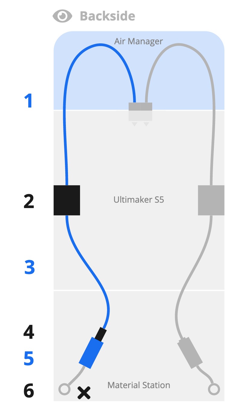

Identify why loading failed
The first thing to do is identify where in the extrusion train the loading failed. Identify whether the filament is:
1. Visible past the feeder
2. Visible in the feeder, but not past it
3. Visible past the decoupler, but before the feeder
4. Visible in the decoupler with the decoupler extended
5. Visible in the decoupler with the decoupler not extended
6. Not visible in the back of the Pro Bundle
Click the scenario below that applies to your situation for troubleshooting tips and advice to resolve the material loading problem:
In this scenario, the filament has gotten past the decoupler and is visible in the Bowden tube, but it has not yet reached the printer's feeder. Please check the following:
  • Check that the Bowden tube is securely inserted. If the Bowden tube has slipped out of the decoupler, the material will not reach the feeder. Fully push the tube into the decoupler's slider and secure it with the clamp clip. If the tube slips out easily when applying pressure, check this page for more information.
  • Check the Bowden tubes for damage. There may be internal damage or bend marks inside the Bowden tubes. This could lead to excessive friction on the filament or prevent correct loading. If that seems to be the case, please contact support for further assistance.

  • Check the material for damage. If part of the filament was ground down by the feeder or prefeeder, cut it off above the damaged part. Ensure it has a good pointy tip, according to the image in the general guidelines below.

4. Visible in the decoupler - Decoupler extended
Follow these steps when you can see that the material has entered the decoupler, and the slider is fully extended:
  • Ensure that there is no obstruction of the decoupler. Remove any external objects that may be interfering with the decoupler or cables that may be tangled to the Bowden tubes. The Bowden tubes from the decoupler must be able to move freely and should not be secured to each other or the Air Manager cable.
  • Check if the Bowden tube is fully inserted. If the Bowden on the upper side of the decoupler is not fully inserted, it can create a gap where the filament can get stuck. The filament can also get caught on the tube coupling collet if the Bowden tube has slipped out completely. Fully push the tube into the decoupler's slider and secure it with the clamp clip. If the tube slips out easily when applying pressure, check this page for more information.
To prevent this issue from happening in the future, please refer to our general printing guidelines.
5. Visible in the decoupler - Decoupler not extended
Follow these steps when you can see that the material has entered the decoupler, but the slider is not extended:
  • Check for broken pieces of filament. If there is broken filament somewhere in the system, clean the Bowden tubes by manually pushing a piece of filament through. Remove the Bowden tube from the bottom of the feeder, insert new material into the entry port, and push it all the way through.

6. Material is not visible at the back of the machine
If the filament is not visible at the back of the machine, then the filament is getting stuck at the bottom of the machine and not finding its way outside of the Material Station.
Note: Check carefully, as it may not be easy to see if the material has entered the decoupler or not (especially white and translucent materials). When in doubt, also follow the steps for 4. and 5. (Visible in the decoupler).
  • Manually push filament into the system. Push approximately 1 meter of filament into the entry port. The filament should be making its way to the back of the Pro Bundle. There are two possibilities how this can go wrong:
You hit an obstruction
If you feel you hit an obstruction before the filament exits out the back of the Material Station, there is something blocking the merger. In this case, you likely saw grinding marks from the prefeeder on the filament.
  • Obstruction, caused by broken filament in the merger. There is likely broken filament in the system which must be cleared out. Try pushing from a different bay if you cannot push the obstruction further.
  • Obstruction, caused by another bay still having filament in the merger. Check if other bays have filament fed in the merger. Pull all preloaded materials out of the Material Station.
If you are able to clear the obstruction, you can turn on the Pro Bundle again. Reload your materials and restart your print.
Filament never comes out
If you can keep pushing filament (more than 1 meter) into the Material Station, but it never comes out the back and you do not feel a blockage, there is probably an opening at the bottom of the Material Station. The following could be the case:
  • Disconnected prefeeder Bowden tube
  • Open merger
  • Disconnected merger Bowden tube
To resolve this, it is necessary to turn off and dismantle the Pro Bundle and open the bottom compartment of the Material Station.
Caution: The Material Station has a built-in power supply. Due to local laws and regulations, not everyone may be allowed to open the Material Station. Please contact support or your local reseller to receive further instructions.

  • Make sure that all Bowden tubes are fully inserted and secured with a clamp clip. If the tube slips out of the decoupler easily when applying pressure, check this page for more information.
Note: Removing the Bowden tubes from the decoupler when troubleshooting or removing broken filament can be difficult, and correctly reinserting them even more so. If you find this too hard, remove the Bowden tube connected to the feeder instead.

  • Correctly cut the filament tip before loading new material into the Material Station. Use the supplied cutters to pre-cut the filament tip into a pointy shape. This avoids material getting stuck. Make a double cut to create a conical shape for the best results and avoid sharp edges.
