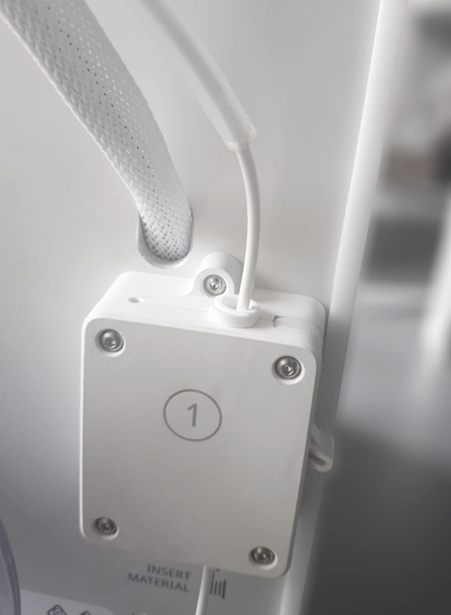

Under certain circumstances, it can happen that the Bowden tube slides out of the feeder during printing. When this happens, the material continues to feed but will no longer extrude properly. Unfortunately, the printers have no means to detect this failure mode.
If this happens and it is not detected early, the material will coil up behind or inside the printer. This results in a failed print and possibly a clogged print core or nozzle, as material degrades in the hot end due to lack of extrusion.

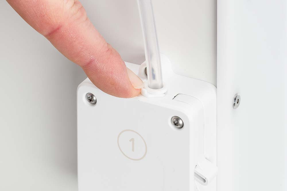

Clamp clip

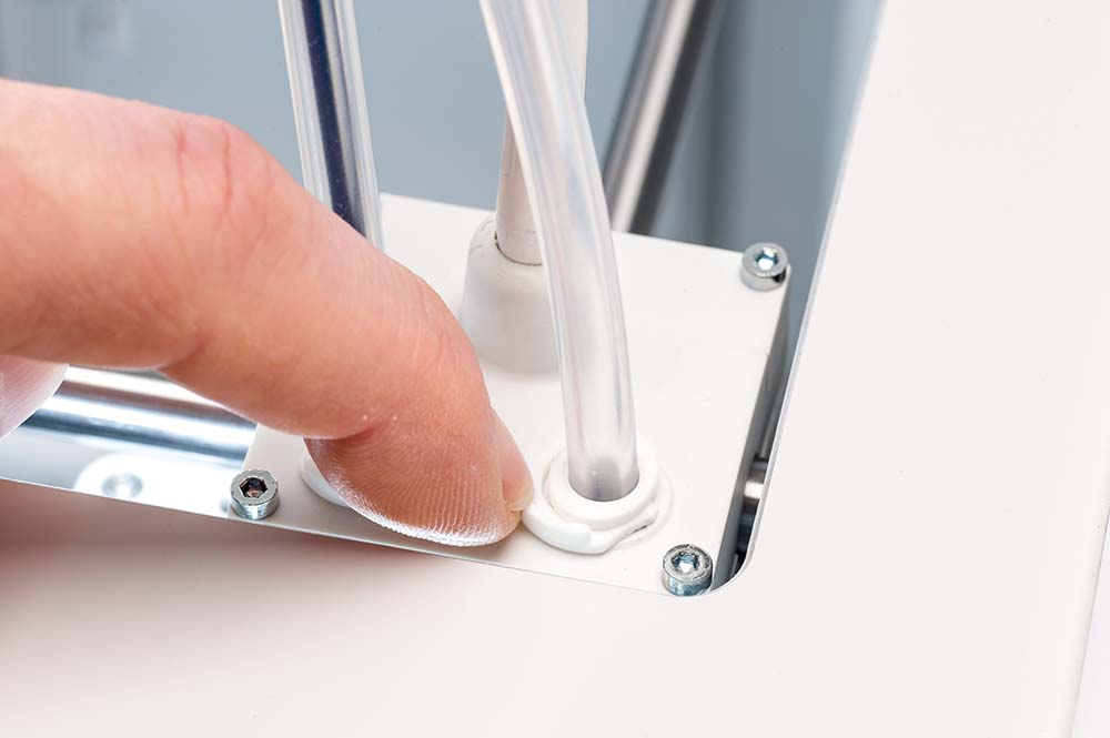

One of the hardware changes to resolve this issue is a thicker clamp clip.
The clamp clip locks the tube coupling collet in place; the collet’s legs are pressed slightly inwards by the inside conical surface of the feeder. The blades of the collet now grip into the Bowden tube’s outer surface.
The thicker clamp clip gives more pressure. By increasing the thickness of the clip, the collet is held in place a little higher in the feeder assembly. Due to the conical shape on the inside, the clamping force is increased.
This thicker clamp clip is now the new standard part on all feeder assemblies. It is also used on the top of the Material Station decoupler and is included in all Bowden packs. You can also print this clip yourself using the STL file, which can be downloaded here. See the section below for printing advice.

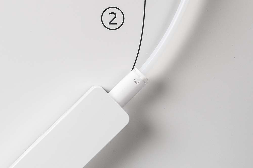

Note: These clips are recommended to be used on the top of the feeder for any UltiMaker 3D printer type. We have also seen some cases whereby the Bowden tube comes out of the print head, and (on the Pro Bundle) whereby the Bowden tube slides out of the decoupler. The thicker clamp clip can also be installed in the print head or decoupler when issues are encountered.
The thicker clamp clips can be used on several parts of the printer or Pro Bundle:
Feeder
Print head
Decoupler (Material Station)

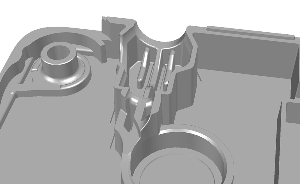

Feeder housing

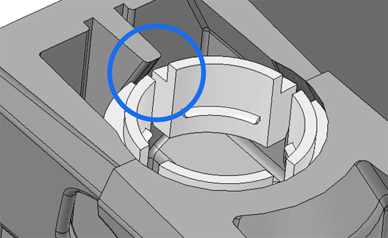

UltiMaker has also implemented a small change to the feeder housing. On one side (the back), the space where the tube coupling collet is inserted is a continuous conical surface. The front part of the feeder housing had a rib that keeps the collet in place.

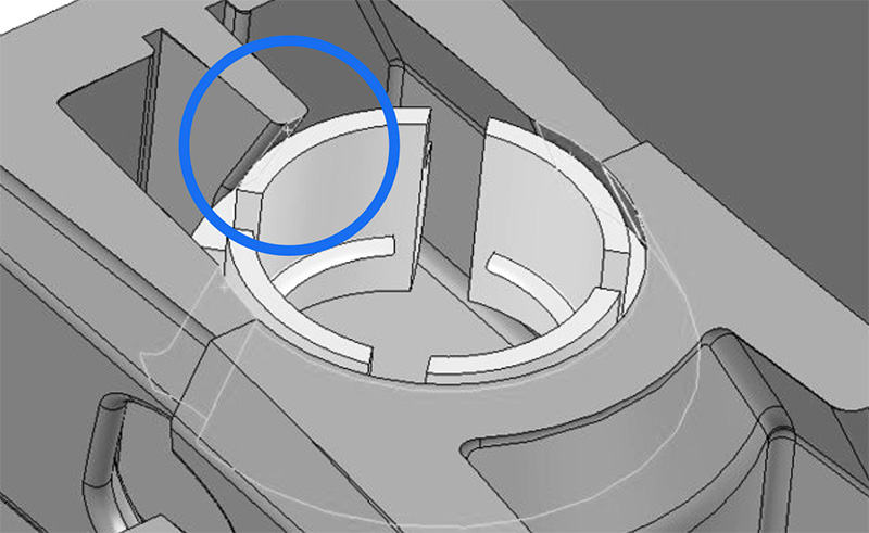

Previously, there was a single rib. In some cases, if the collet rotated, the rib aligned with the gap between the collet's prongs. This leads to insufficient pressure on the collet and tube.
Collet at 0° position, rib activates prong
With the tube coupling collet in this position, the fin in the feeder housing pushes against the tube coupling collet’s prong, correctly pushing it inwards and ensuring a good clamping force.
Collet at 45° rotation, rib does not activate prong
With the tube coupling collet rotated into this position, the rib in the feeder housing can be aligned with the gap between two of the collet’s prongs. This does not push the prongs against the tube properly.

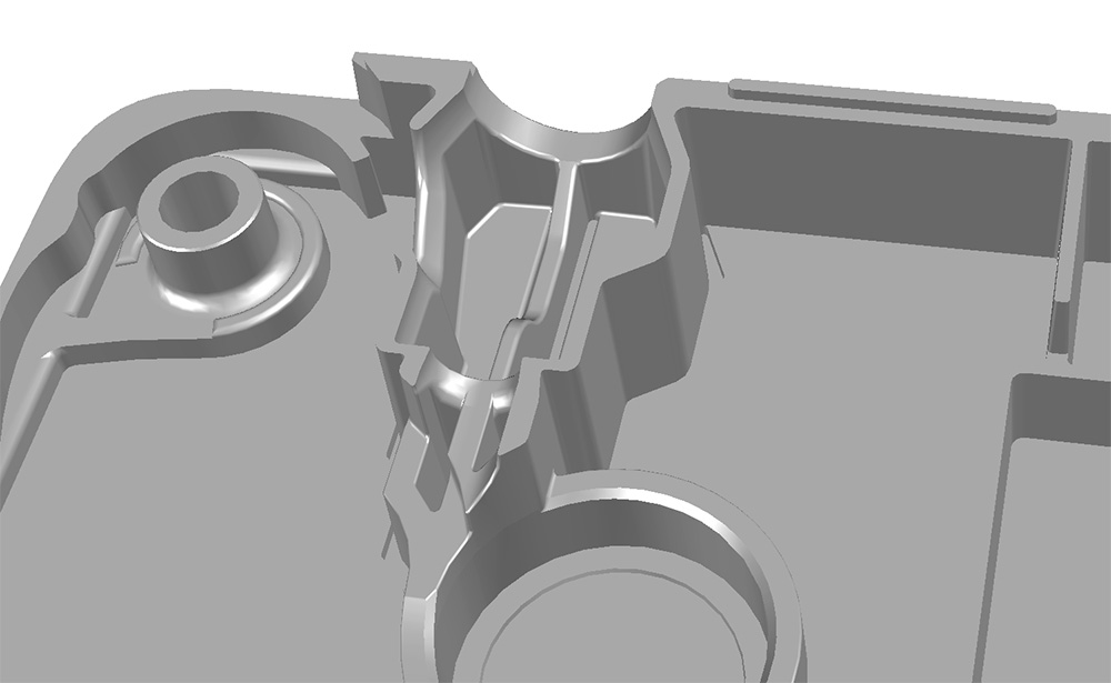

With a small update to the feeder hardware, two additional ribs were added. This increases the contact surface with the collet, and reduces the chance of a sudden loss of grip, even if the collet is rotated.
Old feeder housing part with 1 rib
New feeder housing part with 3 ribs
These parts are now the new default on the feeders for UltiMaker S series printers and the UltiMaker 2+ Connect.
Note that the thicker clamp clips have resolved the issues with the Bowden tubes in the majority of the reported cases. If you are experiencing persistent problems even with the new clamp clips installed, you can check the version of the feeder housing by removing the front part. If your feeder has the single rib, contact support or your local reseller about the new version.
