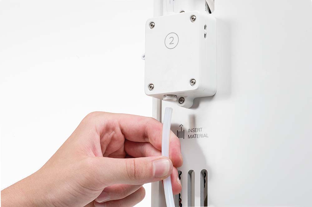

  2. Remove the clamp clips from the bottom of each feeder.
  3. Take the Material Station's Bowden tubes out of the bottom of each feeder.

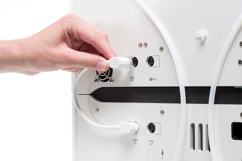

  7. Disconnect the Material Station cable from the UMB OUT port in the printer's back panel.
Note: If you have an Air Manager, ensure to reconnect the Air Manager cable. Disconnect the cable from the UMB OUT port of the Material Station and reconnect it to the UMB OUT port of the printer.
Remove the Bowden tubes

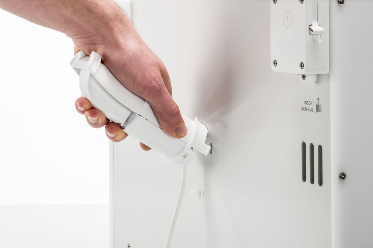

Disconnect the UMB cable

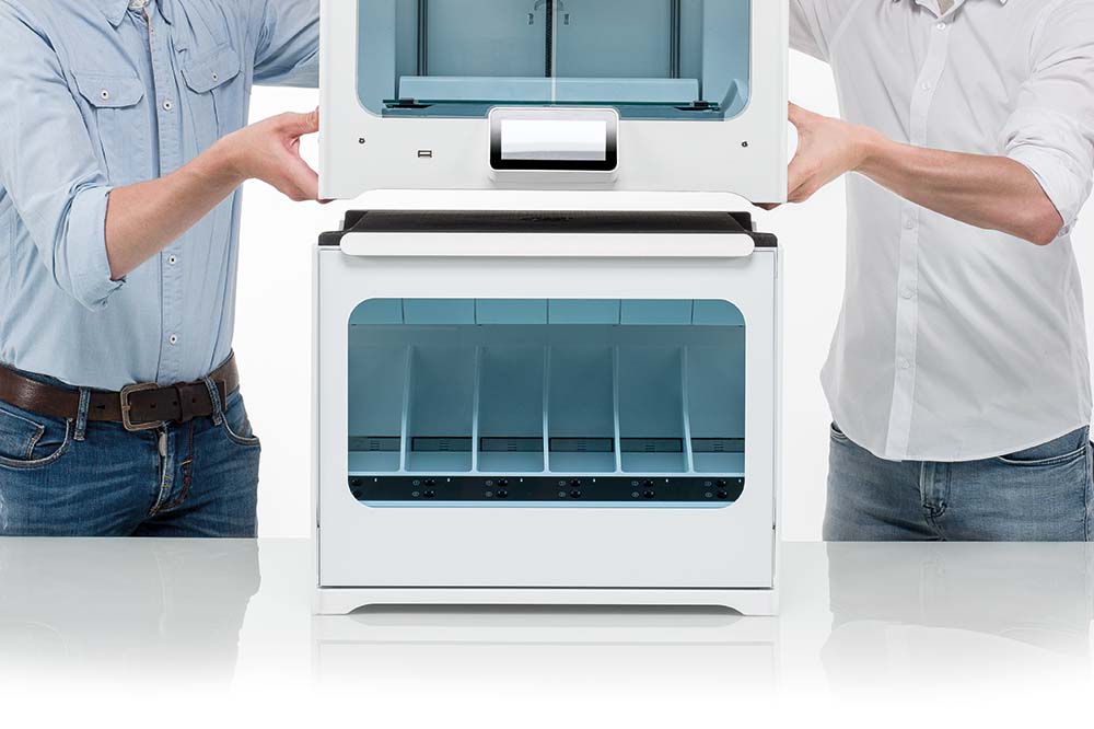

Carefully lift the printer off the Material Station and (temporarily) place it on a flat, level, and stable surface. Be careful, as the printer is heavy. The UltiMaker S series printer must be lifted by at least two people.

Lift the printer off the Material Station
