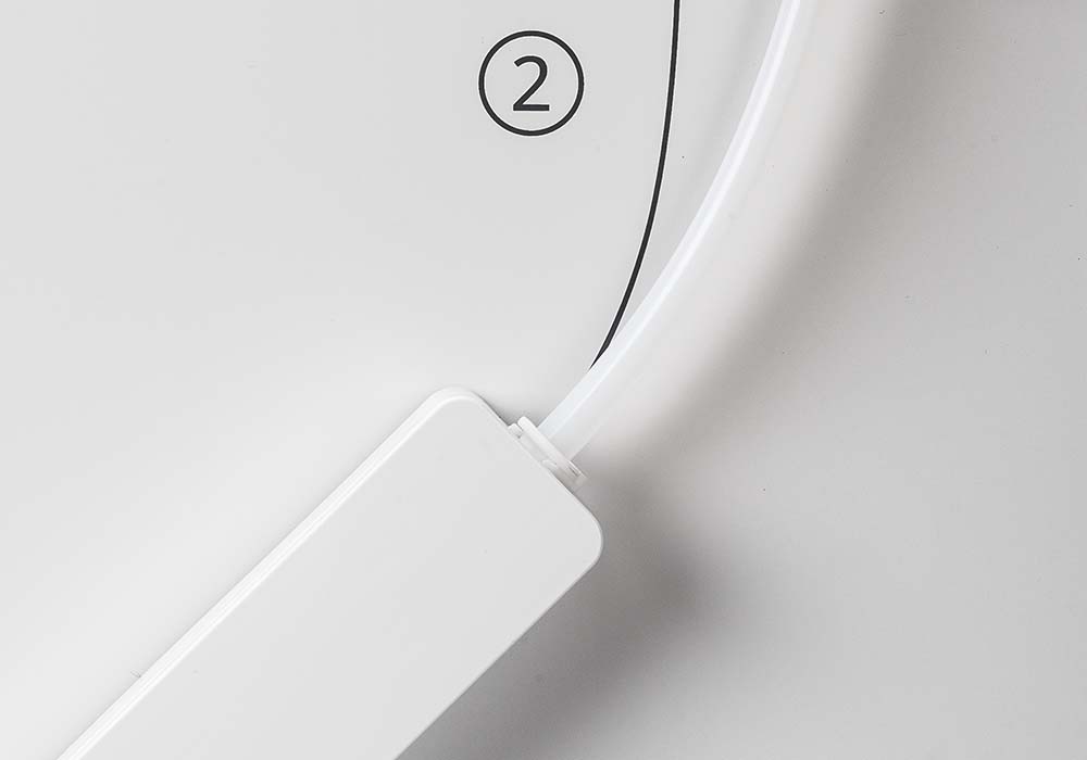

Position 1 – Tension IN
Push the slider of the decoupler all the way into the decoupler with the spring fully compressed. You will feel some resistance. This is the 0 mm position.
Press one of the eject buttons; the Material Station will flash two times.

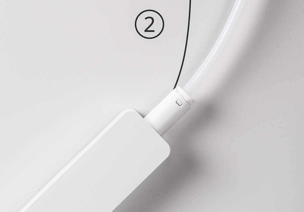

Position 2 – Free IN
Hold the slider in the decoupler, but without compressing the spring (relaxed). This is the 4 mm position.
Press one of the eject buttons; the Material Station will flash three times.

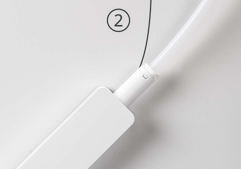

Position 3 – Free OUT
Pull the slider out of the decoupler, until you feel some resistance. Make sure the slider is relaxed; do not compress the spring. This is the 21 mm position.
Press one of the eject buttons; the Material Station will flash four times.

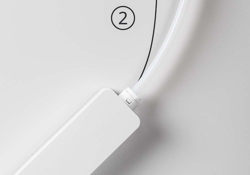

Position 4 – Tension OUT
Pull the slider out of the decoupler as far as possible. You will feel some resistance from the spring tension. This is the 25 mm position.
Press one of the eject buttons to confirm.
If the calibration was successful, the Material Frame lights will stay on.
