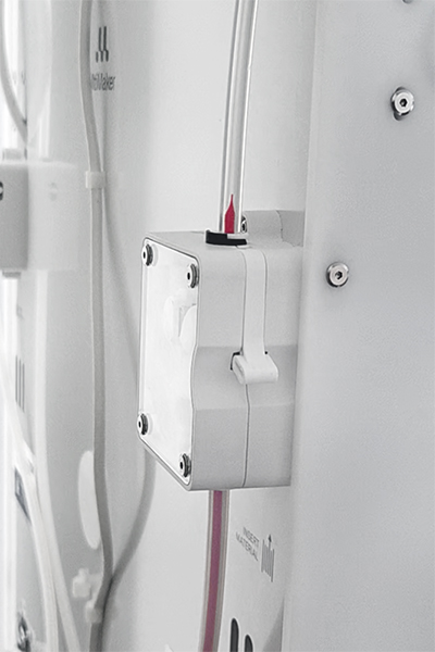

UltiMaker has received reports regarding a material loading inconsistency affecting the UltiMaker S6 and S8 in combination with the Material Station and running Firmware 11.2.0.
Users may experience a "hang" during the loading process where the feeder fails to engage as the filament approaches, typically resulting in the material stopping slightly above the feeder. In other instances, the filament may progress further but stops halfway through the Bowden tube toward the print head. In rare instances, the print process may start before the material reaches the print head, requiring a manual abort.

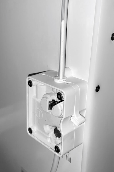

Note: In some cases, loading problems can also be caused by the flow sensor in the feeder. If the loading problem still occurs on firmware 11.2.1, carefully remove the feeder from the back by undoing the two bolts. Check if the flow sensor cable is connected securely. Try reconnecting it, if needed.
