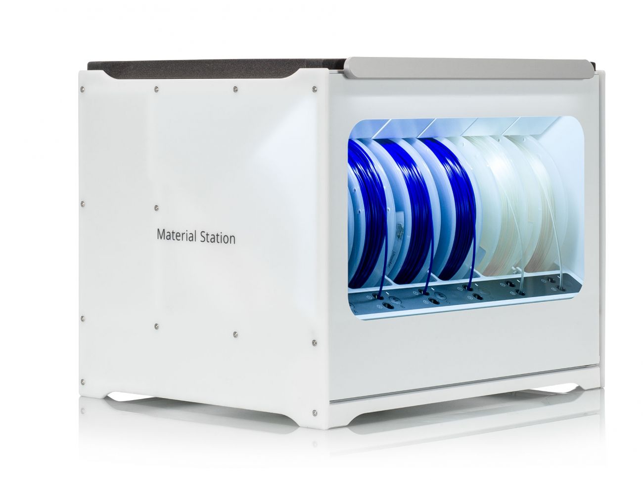

The Material Station is compatible with UltiMaker S series printers (S5, S6, S7, and S8). This combination of printer and Material Station is referred to as the Pro Bundle (for the UltiMaker S5 and S6, the Air Manager add-on is also part of the Pro Bundle).
Note: The Material Station is not compatible with the UltiMaker S3 or other printer models. Factor 4 features an integrated Material Station. Although many components and features are similar, this article only specifically applies to the UltiMaker S series Material Station, not the material handling module of the Factor 4.
It is designed to improve the 3D printing workflow and efficiency. With a connected Material Station, UltiMaker S series printers benefit from the following features:
Access to up to 6 material spools
Load up to 6 material spools from the front of the Pro Bundle. The 6 different material bays are shown on the display, and the configuration menu on the printer changes its user interface to reflect this. When an NFC material is loaded into any bay, the material will automatically be read and displayed. Furthermore, the user can easily see on the display for which extruder the material is loaded.
Automatic filament switching
When an end-of-filament situation is detected by the Material Station during printing, the Material Station will automatically switch to the next available material spool of the same type. For this reason, it is recommended to always load another spool of the same material into the same extruder.
Humidity-controlled material storage
A reliable humidity-controlled storage chamber maintains the loaded spools in optimal condition.
Loading materials
Loading material spools in the Material Station is quick and simple. This can conveniently be done from the front, and at any time, even during printing.
Simply place the material spool into one of the six bays and insert the filament tip into entry port 1 (for extruder 1) or entry port 2 (for extruder 2). For the best results and increased loading reliability, always cut the filament into a nice, sharp tip before inserting the material.
You will feel the filament getting pulled in slightly, then stop. The filament is now in the 'pre-loaded' state in the prefeeder. It will stay in this position until the filament is needed for a print job. When a print job is started, that material will automatically be loaded toward the print head. Manually loading the filament to the print head is not possible.
