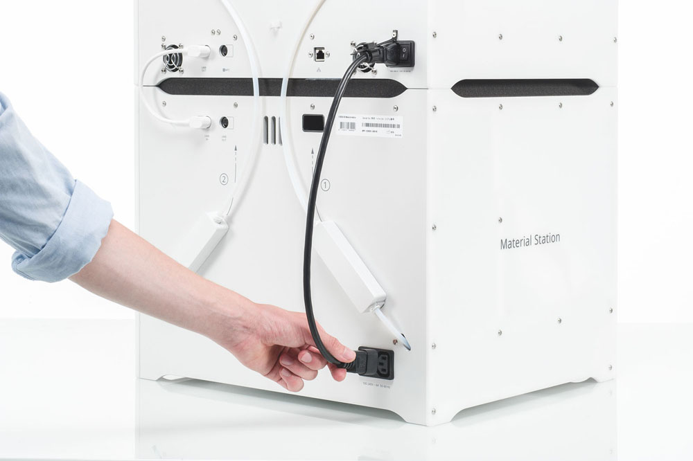

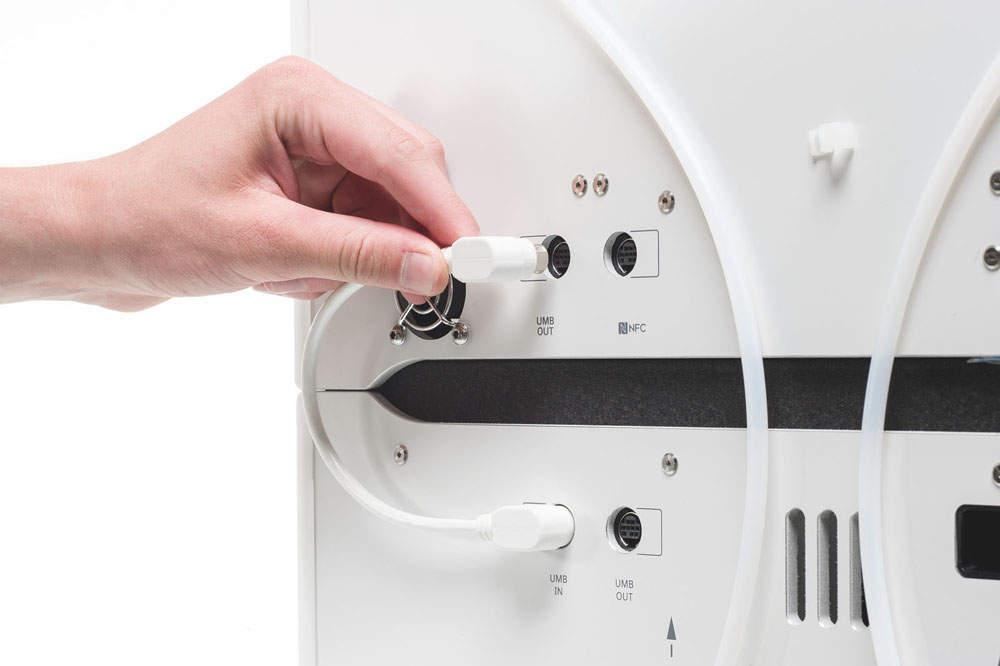

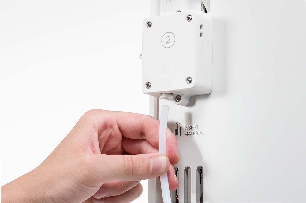

If you want to use the Metal Expansion Kit on an UltiMaker S5 or S7 that currently has a Material Station installed, the Material Station must be disconnected or uninstalled first. You can learn how to do this on this page: Uninstalling the Material Station
