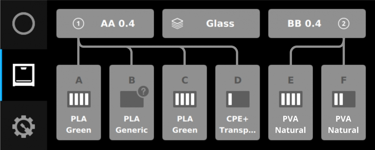

NFC materials store the amount of material left on the spool. During printing with NFC materials, the S series printers utilize the flow sensor to track material usage and write the new amount to the NFC chip. The amount of material spool is displayed on the user interface via a battery icon. The charge of the battery reflects the amount of material left on a spool. The battery icon is also visible in UltiMaker Digital Factory.
The battery shows 4 full bars when the spool is new, and the battery empties as the spool of filament depletes. For materials that lack an NFC chip, the battery contains a ‘?’ icon.
Note: Although material usage is tracked on the NFC chip, this information will never be used to determine end-of-filament. This data may be incorrect. For example, if the spool was also used on a printer without NFC functionality. The Pro Bundle contains various sensors to trigger end-of-filament without relying on NFC data.
