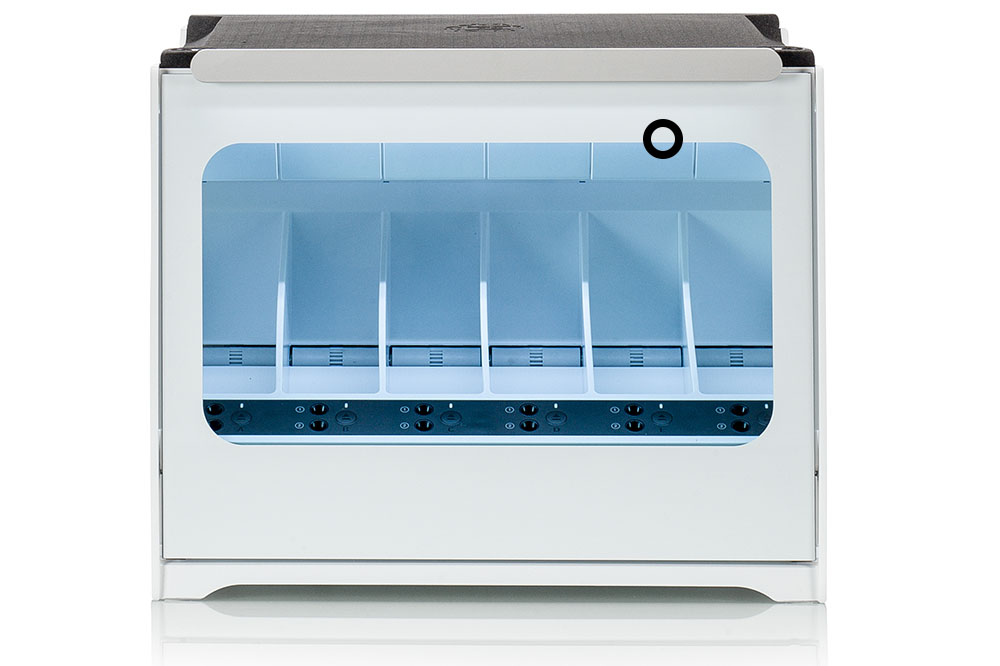

The Material Station has a built-in dehumidifier. The dehumidifier controls the humidity inside the Material Station. Silica beads absorb the moisture in the chamber to keep the material spools in a stable environment. The dehumidifier will regenerate the silica beads when the humidity becomes too high.
Tip: The information in this article applies to the S series Material Station (for the Pro Bundle setup) and Factor 4, which features an integrated Material Station. The dehumidifier is the same, although the humidity control can be different between the models; these are indicated where relevant.
The dehumidifier can only operate and regenerate if power is supplied to the Material Station. If the Material Station has been unplugged for a long period, the dehumidifier can take longer than usual to reach stable conditions.
Note: It is not recommended to store (moisture-sensitive) materials in the Material Station if the power cable is disconnected.
The S series Material Station will turn on as soon as the power cable is connected; it does not have a separate switch. On Factor 4, the Material Station module shares the power supply with the printer and will only be on if the printer is powered on.

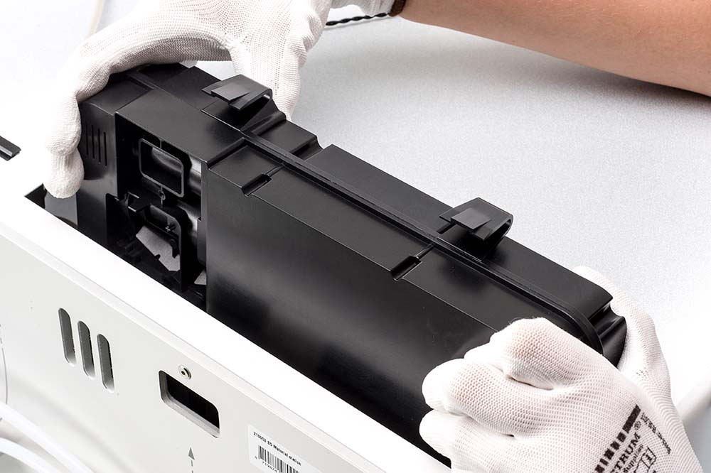

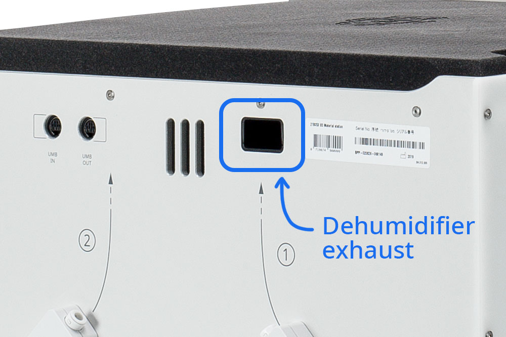

S series
The dehumidifier is hidden in the back compartment of the Material Station. It is not normally visible, except for the exhaust at the back. It is not normally necessary to access the dehumidifier, but if this is required, the top plate of the Material Station must be removed.
The dehumidifier is inside the Material Station at the backThe dehumidifier exhaust is at the back of the Material Station, next to the serial number sticker

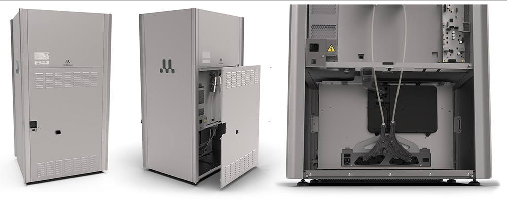

Factor 4
On Factor 4, the dehumidifier is at the back of the Material Station module. It is not normally visible, only if the back cover panel is removed. The exhaust opening is at the back, toward the middle of the back cover panel. Ensure to keep this exhaust opening free, with at least 10 cm behind it for unrestricted airflow.
When back cover panel is removed, you can see the dehumidifier in the bottom section, behind the mergers and Bowden tubes.

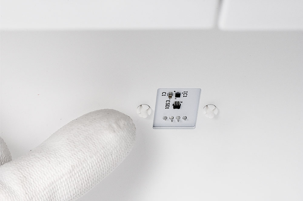

Where is the humidity sensor?
The humidity sensor measures the relative humidity inside the Material Station. It is located on the top panel. On the S series Material Station, the sensor is underneath the foam plate. On Factor 4, it is on top of the Material Station module housing; it is only accessible if the complete module is removed from the printer.
On the inside of the Material Station, the humidity sensor is on the right side, behind the top arms that keep the spools in place.
Caution: Do not touch the humidity sensor components on the inside of the Material Station as they are very sensitive and easily damaged.
This is the approximate location of the humidity sensorThe humidity sensor as seen from the inside of the Material Station
