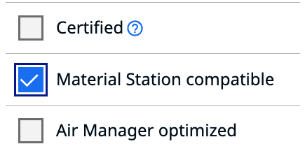

In the UltiMaker Marketplace, check if the material is compatible with the Material Station. In the filters on the left side, check the box for "Material Station compatible". If the material is not shown, it either really can't be used in the Material Station (for reliability reasons) or the profile has not yet been updated by the material manufacturer. In that case, you can reach out to the manufacturer to request an update.
