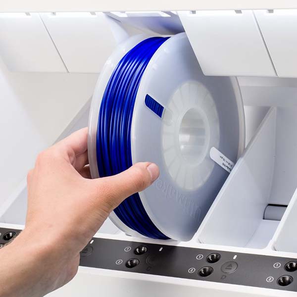

Place the spoolOpen the Material Station door. This will automatically open the Configuration menu on the printer's display. Place the spool into an available material bay with the NFC tag on the left side. If there are no available bays, unload a spool first.

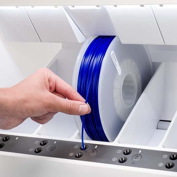

Insert into entry portTake the end of the filament and insert it into one of the entry ports. This will guide the material to extruder 1 or extruder 2. Push until you feel the prefeeder grip the filament.

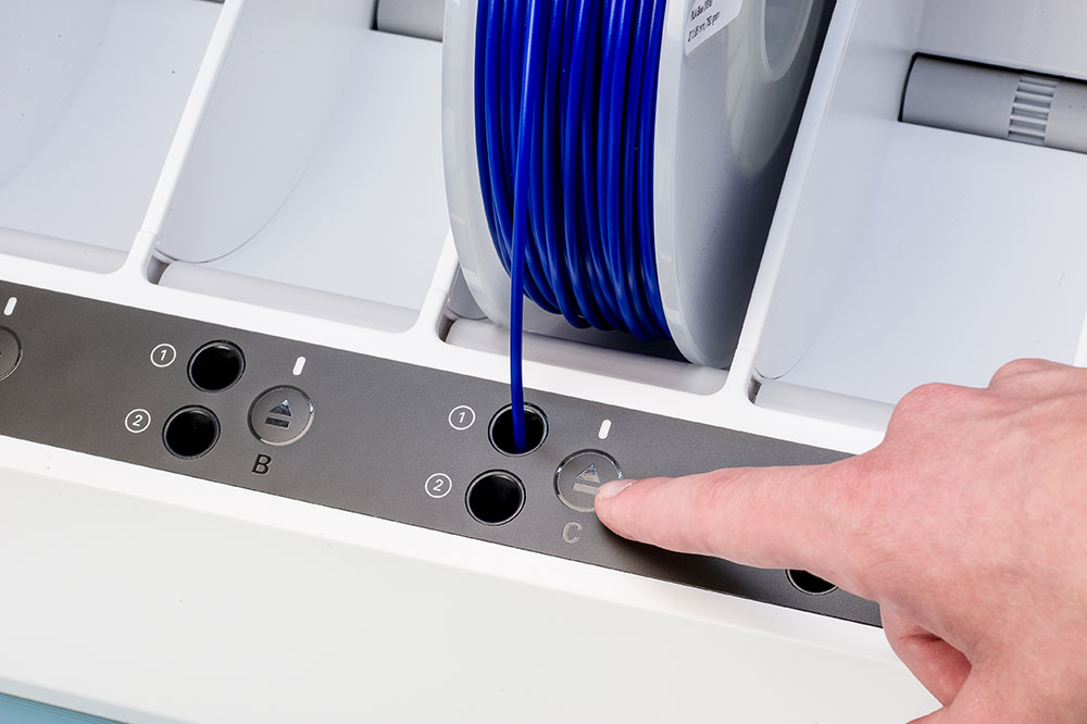

If you want to unload the spool that was used for the previous print job and the material is still parked above the print head, you must first remove the print and select Confirm removal on the display. You can now select the spool in the Configuration overview and press Unload. The spool will now rewind back into the Material Station.
Gently open the glass door of the Material Station. Press the eject button of the corresponding material bay to eject the pre-loaded filament. Remove the material spool from the material bay and store it according to the recommended storage conditions.
