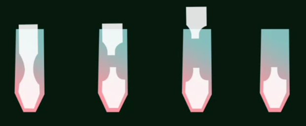

At the end of a print, or when an end-of-filament has been detected, the Pro Bundle or Factor 4 will initiate the deprime procedure. The goal of this process is to ensure that the material will unload back into the Material Station with a clean tip and no strings.
When a print is finished, or when switching automatically to a new spool, the print head will again move to the side of the printer and purge some material. This purge is to eliminate print job-specific influences, such as retractions, flow rates, or (user-set) temperatures. After this purge, which stabilizes the process, the deprime starts with a material-specific retract, followed by a cooldown period.
The first step, in which the filament is pulled back a short distance at a high temperature, creates a thin strand of material inside the hot end of the print core. The print core will then cool down to the 'break temperature'. The break temperature is a material-specific property. Upon reaching this temperature, the filament is retracted further, breaking off the solid filament from inside the print core.
For the end-of-print process: The material will then wait in this parked position above the print head for a certain amount of time (2 hours for most materials, but 60 hours for PVA), or until the next print job is started. When the timer runs out, or if the next print job requires different materials, the filament will be fully unloaded back to the Material Station.
For the end-of-filament process: The leftover material will fully unload and rewind back into the Material Station. The printer will automatically detect the next available spool with the same material, load the material to the print head, and continue printing. If no other spool of the same material is available, the printer will remain in a paused state until an operator loads a new compatible spool into one of the material bays.
