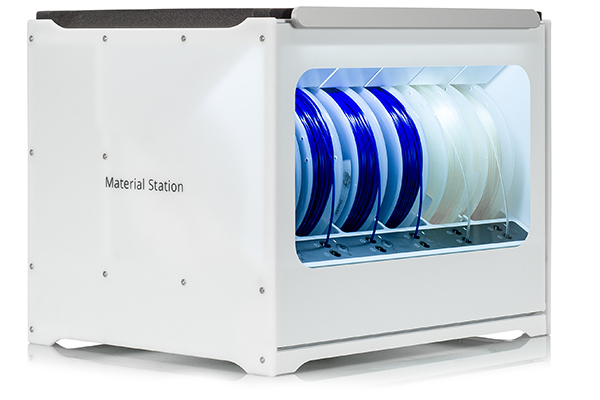

The Material Station delivers a flexible, efficient, and reliable solution for material handling and storage. The Material Station is an optional add-on for S series printers (S5, S6, S7, and S8), and it is an integrated part of the UltiMaker Factor 4.
Many different types of materials can be used in the Material Station; not just UltiMaker filaments, but a wide variety of third-party materials as well. Note that there are some limitations:

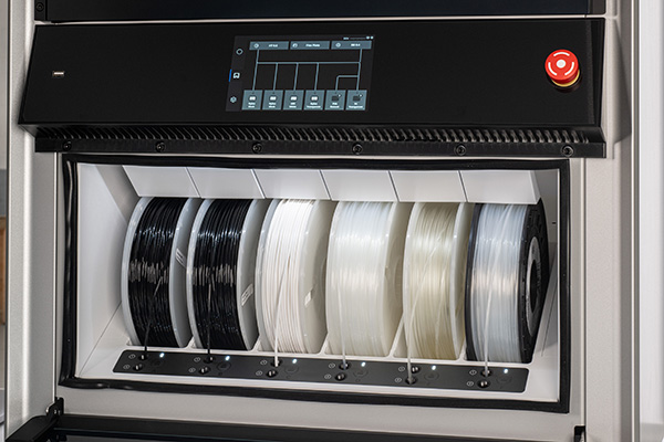

Physical spool size limit
The Material Station has six different material bays in which material spools can be loaded. These material bays have a physical limit for compatible spool sizes. Spools that can be used in the Material Station have the following maximum dimensions:
  • Maximum width of 70 mm (2.7 in)
  • Maximum diameter of 203 mm (8 in)
Spools larger than these dimensions will not fit in the Material Station.

Note: Do not use spools in the Material Station or Factor 4 that don't follow these specifications.
On S series printers, you can (temporarily) Disconnect the Material Station and reinstall the spool holder if you want to print with larger or smaller spools, or materials that are otherwise not supported for the Material Station.
The Material Station is an integrated part of the Factor 4; it cannot be bypassed. Select your materials and spool sizes for Factor 4 taking the limitations listed on this page into account.
Note: The bay dividers in the Material Station contain the NFC readers for UltiMaker materials. These are not intended to be removable to fit larger spools. Attempting to remove the bay dividers may damage your machine.
