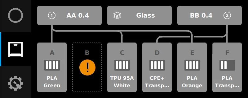

When placing a third-party material spool in the Material Station, the NFC reader will not be able to automatically detect the material type. This will then be indicated on the display by an exclamation mark for the corresponding material bay.
You can manually select the correct material type. Tap the ‘!’ to view the list of available materials. Scroll through the list and select your material type. After selecting, the material configuration menu will now show the material type. Note that non-UltiMaker materials will not have the battery indicator.

Converting to a generic profile
It is always possible to manually override the material type, even for NFC-detected materials. If you have prepared a print job for generic material, but you only have UltiMaker materials loaded in the Material Station, you can manually change the material type in the Configuration menu.
  1. Select the material that you want to manually override.
  2. Click Select type to open the list of available material profiles.
  3. Select the generic material of the same filament type.
  4. The Material Station will now treat it as a generic material.
Tip: You can easily reset the UltiMaker material type back to using the NFC tag by reloading the material spool, or by selecting the material type and waiting for the NFC to be recognized.
