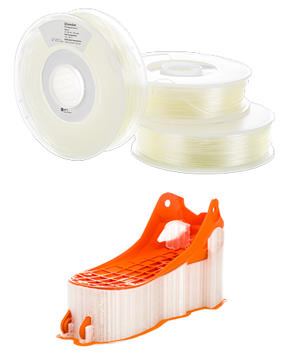

UltiMaker PVA (polyvinyl alcohol) is a 3D printing material commonly used to create water-soluble support structures to achieve complex geometries. PVA can be used on dual-extrusion UltiMaker printers; it gives you more design freedom and reduces post-processing efforts.
UltiMaker PVA comes in a 'natural' color, and is available in two spool sizes: 350 g and 750 g.

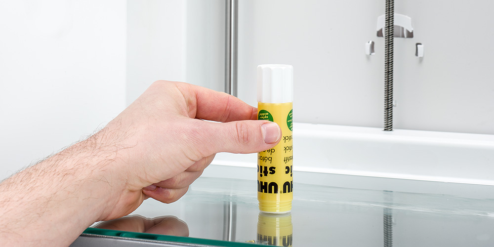

It is advised to apply a thin layer of glue (included in the accessory box of your UltiMaker) to the glass plate for the best adhesion when printing PVA. Glue is recommended for most materials on the glass build plate. The flexible build plate does not require any glue for most materials.

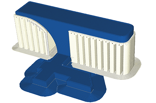

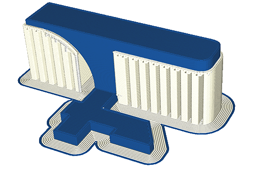

Adhesion extruder not overridden: The brim is printed with the build material around the object and with PVA around the support structure.
Adhesion extruder overridden: The brim is now printed with PVA. There is a line with the build material around the brim to properly prime the extruder (similar to a skirt).

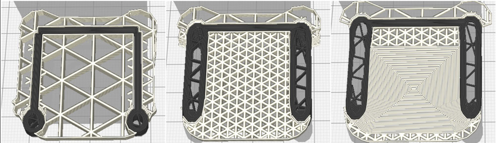

  • Horizontal expansion. The support horizontal expansion setting in UltiMaker Cura creates an offset of the support and makes the support area wider than the object. This ensures constant extrusion and makes the support sturdier, which is especially important in small areas of the model. Lowering the value of this setting decreases the amount of PVA and the printing time, but can also lower the print reliability.
  • Support pattern. The default support pattern for 'Normal' support is set to ZigZag to allow consistent and reliable extrusion, as well as quick dissolution. Alternatively, for less complicated models, the support setting can be changed to Gyroid to speed up dissolution even more. For a sturdier structure, you can select Triangles.
  • Gradual support and support density. The gradual support infill steps and the gradual support infill step height will stepwise increase the support density so that less support material is used near the build plate and more PVA is used near the supported object. This uses less material, although too many steps may cause unstable or unreliable support structures.
  • Support interface. The support interface creates a few solid layers of support below the supported model to ensure a smooth bottom surface. The support interface density and support interface thickness can be lowered to decrease material consumption and for faster dissolution.
UltiMaker PVA support structures from bottom to top layers, showing from left to right: horizontal expansion and low support density due to gradual infill, increased support density close to the object, and the support interface layer.
