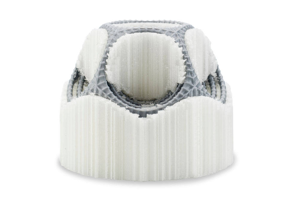

Prints using PVA as support material will require post-processing to remove the PVA. This can be achieved by dissolving the PVA in water, as described on this page, and takes several hours, leaving no trace afterwards.
Tip: The Ultimaker PVA Removal Station automates the process described below for you. It reduces the solving time and allows you to continue to work on different projects.
Print with PVA support before (left) and after dissolving (right)
How_to_dissolve_UltimakerPVA_Print_with_PVA_support.jpgHow_to_dissolve_UltimakerPVA_Print_after_removing_PVA_support.jpg

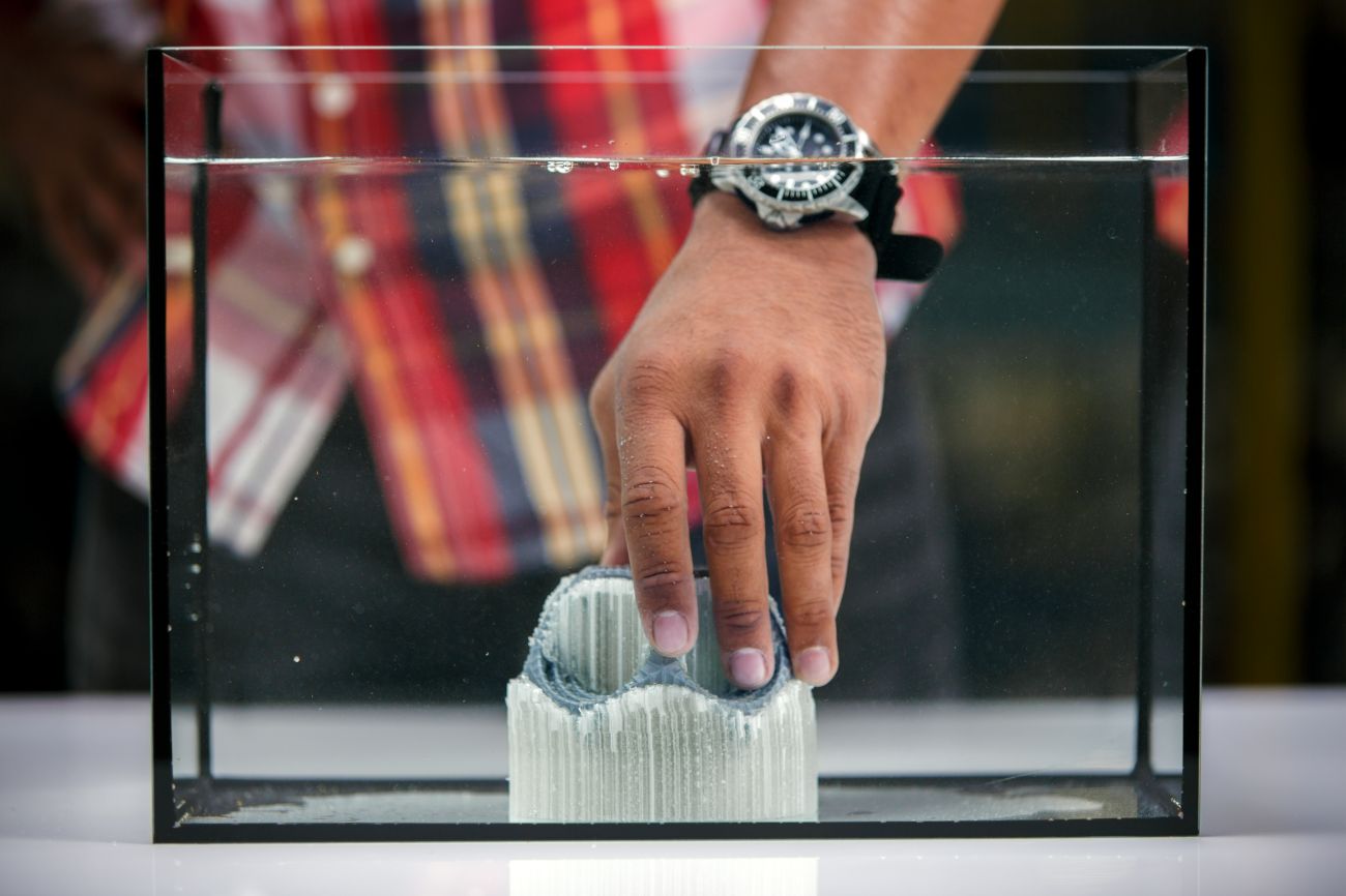

Submerge the print in water
When the print is placed in water the PVA will slowly dissolve. This process can be quickened by using the following techniques:
  • Warm water. Warm water will decrease the dissolving time. When using PLA for the build material, ensure that the water is no hotter than 35 °C, otherwise the PLA may be adversely effected. Never use water above 50 °C, as this increases risk of burning
  • Stirring. Use stirring/running water to decrease the dissolving time. Moving water enables the PVA to dissolve more quickly (in some cases under three hours, depending on the amount of support material used)
  • Pliers. You can also speed up PVA dissolution by placing the print in water for approximately 10 minutes, then removing most of the support with pliers. When the print is placed back in the water, only the remaining parts of PVA will need to be dissolved. After the PVA supports are totally dissolved, rinse the print with water to remove any excess

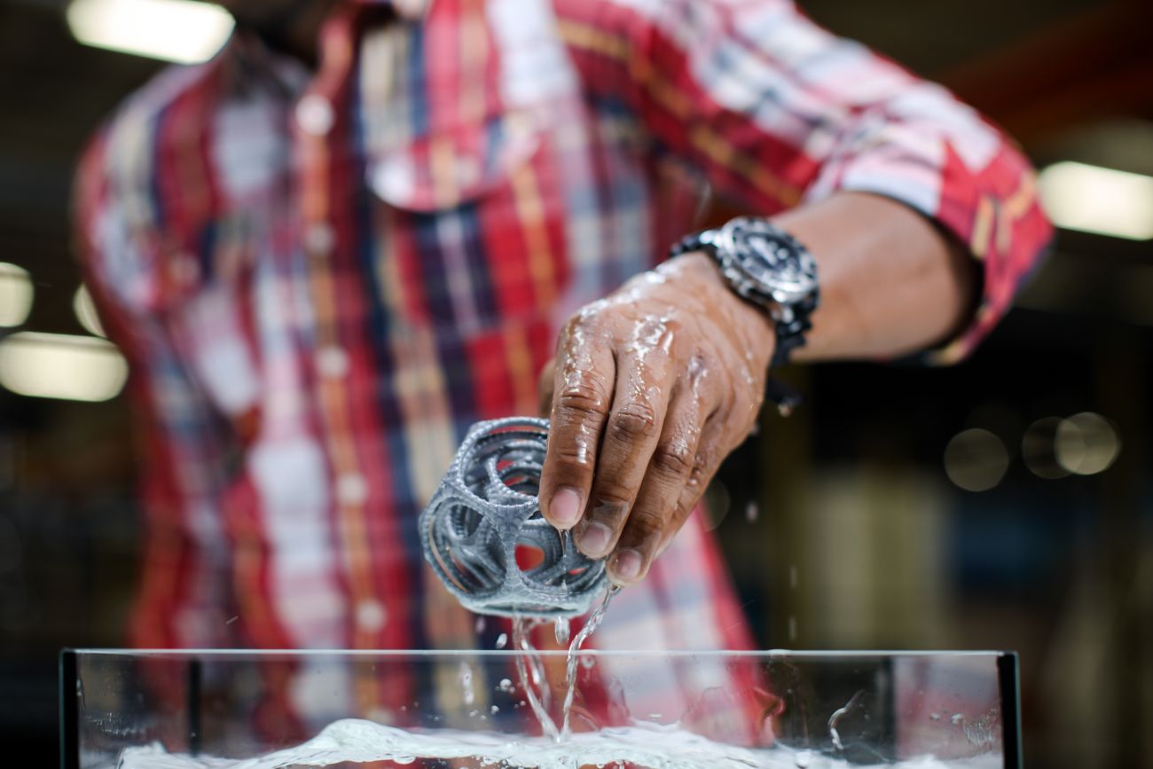

Rinse with water
After PVA supports are totally dissolved, rinse the print with water to remove any excess PVA.

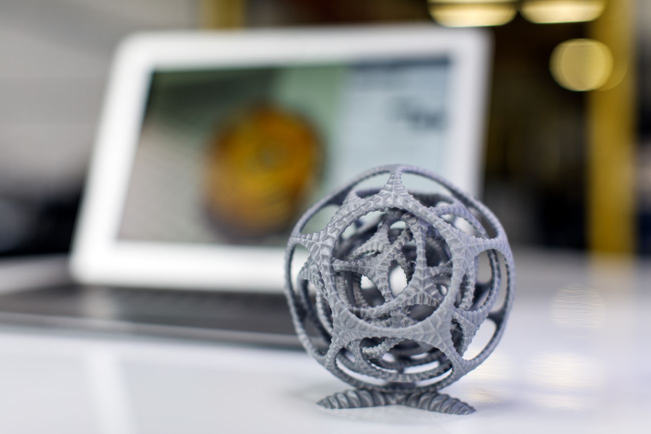

Let the print dry
Let the print dry completely and apply additional post-processing to the build material if necessary.
