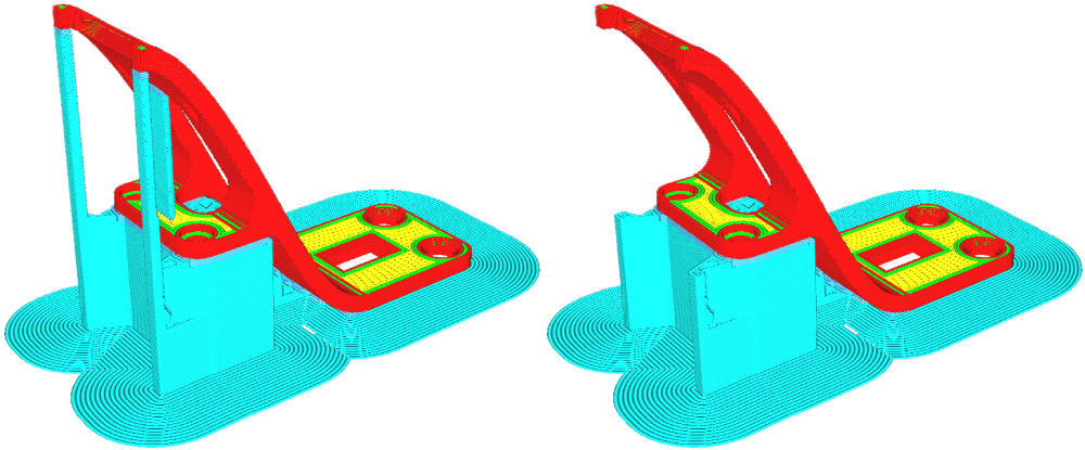

  • Touching build plate: Support material is only printed from the build plate up.
  • Everywhere: Support material is printed below every part that needs support, which means that it can also be placed on or inside a model.
This model has parts with overhangs. The model on the left has support everywhere, while the model on the right has support on the build plate only.

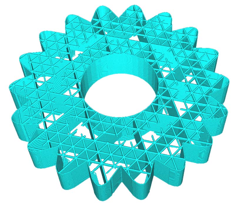

There are different patterns available for printing support structures, resulting in sturdy or easy-to-remove support. Different models, materials, or applications may benefit from different support patterns. You can choose from the patterns below:
  • Lines: Only straight lines, not perpendicular to the model. This is the easiest to remove but tends to be very unstable.
  • Grid: A pattern of straight lines, perpendicular to each other. This creates a very sturdy block, but it is quite difficult to remove.
  • Triangles: A pattern of straight lines at 60° angles. It is the sturdiest of support structures but does not give good overhang quality.

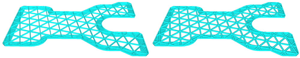

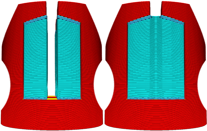

Support Join Distance
Very thin support structures are best avoided, as they can easily fall or cause extrusion issues. With this setting, you control the maximum distance between separate support structures in the X/Y directions. When supports are closer together than this value, they will merge. Using a high value for this setting will cause support structures to merge sooner.
Merging support structures leads to more stable support and, depending on the pattern, will often reduce printing time and material usage. However, increasing this value too much could create a big block of unnecessary support which uses more material and can be harder to remove.
The model on the left has separate supports, while the support join distance value of the right model causes the supports to merge.
