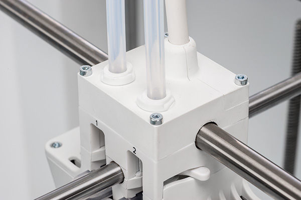

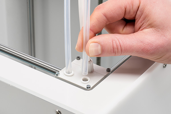

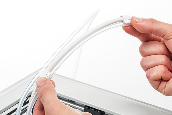

Connect the Bowden tubes
  1. Remove the clamp clips from the collets on the print head.
  2. Take the Bowden tube from feeder 1 and insert it into the left collet on the print head.
  3. Insert the Bowden tube from feeder 2 into the right collet on the print head.
  4. Secure the Bowden tubes with the clamp clips.
  5. Click the print head cable clips onto Bowden tube 2 (right) and divide them equally.

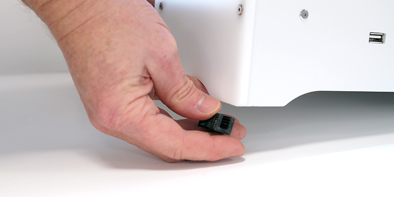

Anti-slip feet
Note: The anti-slip feet are not required in combination with the Material Station.
Carefully tilt the printer and place the anti-slip feet around the bottom of the frame panels. This keeps the printer securely placed, even when printing at high speeds.
The Starter Kit contains four small anti-slip feet. Place one on each corner of the printer.

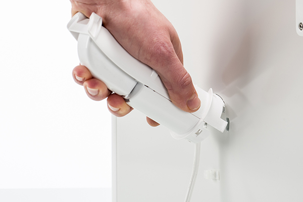

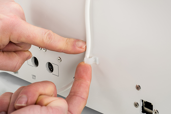

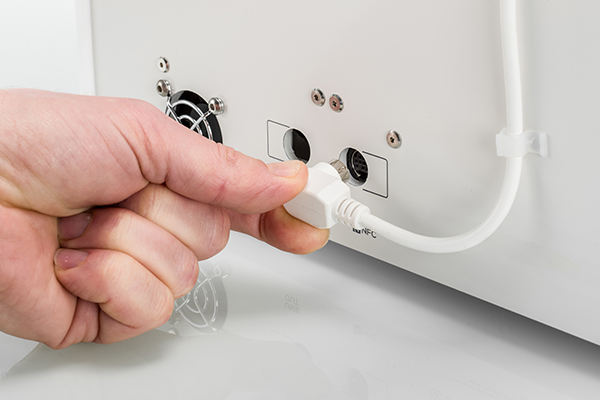

Spool holder
Note: The spool holder is not required in combination with the Material Station.
  1. Insert the spool holder into the back panel and push until it snaps into place.
  2. Secure the cable behind the clips in the UltiMaker S6 back panel.
  3. Connect the spool holder cable to the NFC socket in the back panel.
The spool holder in the Starter Kit also includes a filament guide. This will be placed later, during the loading of the materials in the welcome setup.

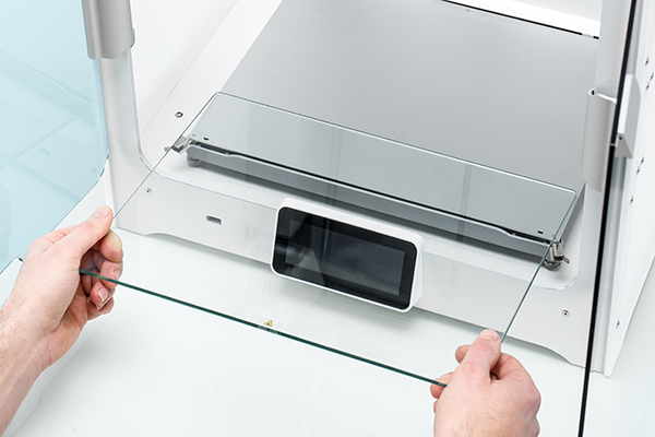

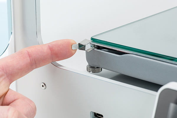

Glass build plate
Note: This step is only for the glass plate printer variant. The flexible build plate is already installed on the Z stage.
  1. Open the printer's glass doors.
  2. Push open the clamps at the front of the build plate.
  3. Slide the glass plate into the clamps at the back, while keeping the glass flat.
  4. Close the clamps at the front to secure the glass build plate.

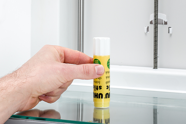

Tip: Most materials benefit from a thin layer of glue applied to the glass build plate. This improves adhesion and reduces the chance of glass chipping.

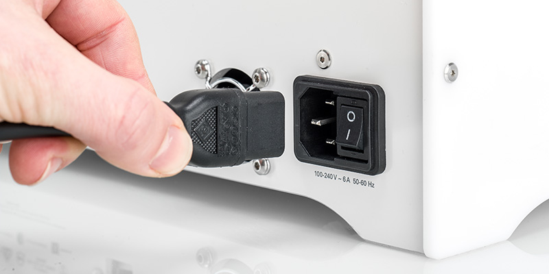

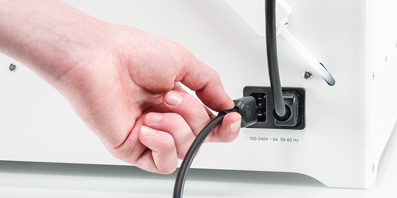

Power cable
Finally, connect the power cable. Firmly insert one end of the cable into the power socket at the back of the printer. Plug the other end into a wall outlet.
Note: If the UltiMaker S6 is installed with a Material Station, connect the power cable to the Material Station instead.
Caution: A mains socket with a protective earth/ground terminal must be used. Make sure that the building installation has dedicated means of overcurrent and short-circuit protection.

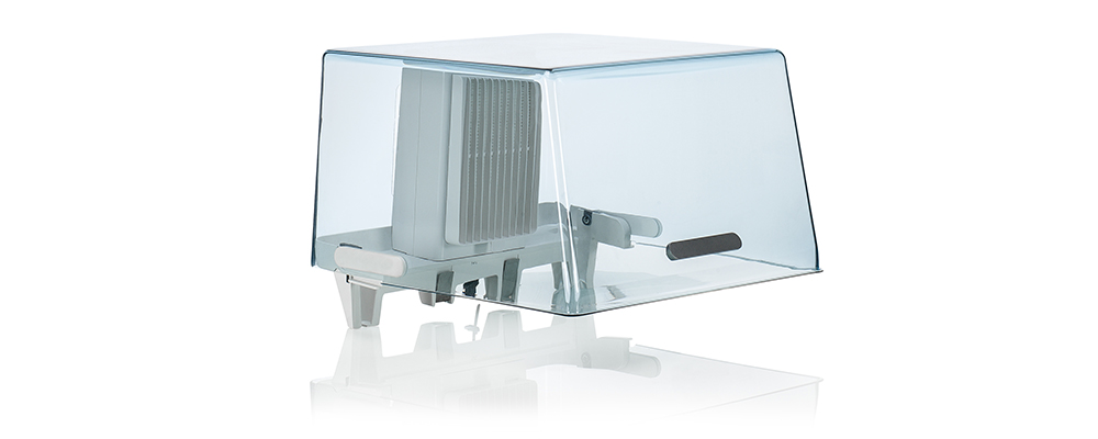

Accessories (optional)
The UltiMaker S5 is compatible with the S series Air Manager and Material Station. You can set up the UltiMaker S5 in any configuration; with one of these add-ons, both of them, or none, depending on your workflow needs.
Air Manager
The Air Manager enhances safety by filtering UFPs generated during the printing process and provides a physical barrier from hot and moving components. The Air Manager is delivered as separate components, which can be installed in a few easy steps. Find detailed information about installing the Air Manager in this article:
Installing the Air Manager

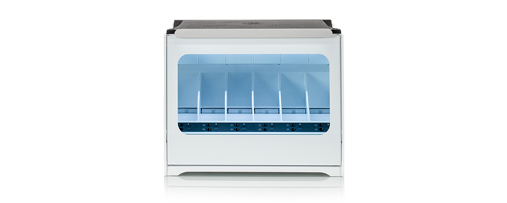

Material Station
The Material Station enables 24/7 uninterrupted printing by automatically managing up to six spools in a humidity-controlled chamber. Set up the Material Station and connect it to the UltiMaker S6 (and optionally the Air Manager) as described in this article:
Installing the Material Station
