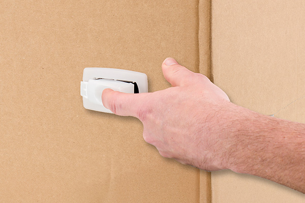

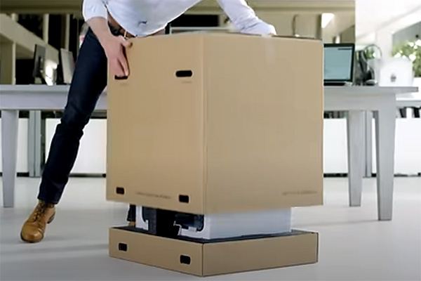

1. Clips
Remove the four plastic locking clips at the bottom of the box. Do not cut open the box at the top.
2. Outer sleeve
Slide the outer box straight upward off the printer and place it aside.

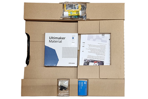

3. Accessories
Remove the cardboard tray with accessories and materials from the top of the printer.

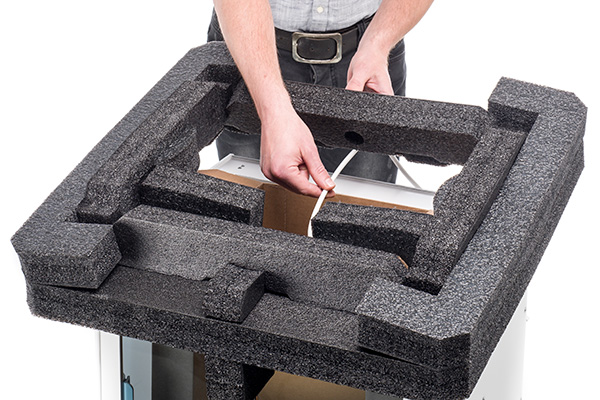

4. Foam
Remove the protective foam parts from the top of the printer.

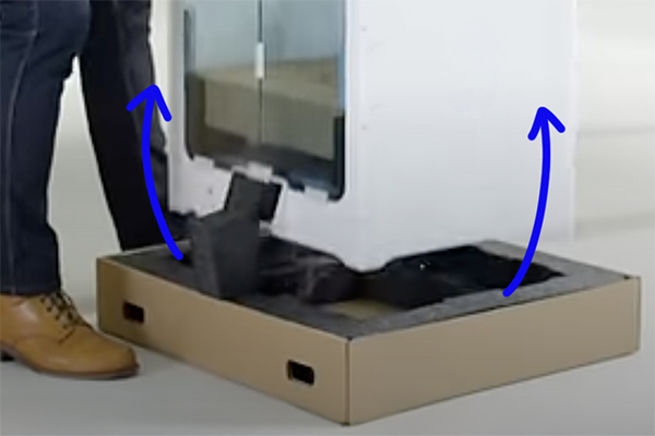

5. Bottom tray
Lift the printer out of the bottom tray. This must be done by at least two people.

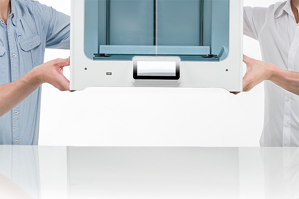

6. Installation surface
Temporarily place the printer on the floor, or directly onto its installation surface.
Note: The installation surface must be flat, level, stable, and capable of carrying the printer's weight. If the UltiMaker S6 will be used in combination with the Material Station, you can install the UltiMaker S6 directly on the Material Station, or temporarily place it on a desk first to remove the other packaging materials.

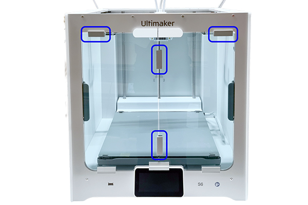

7. Door seals
Open the glass doors to remove the rubber door seals from the edges of the door panels.

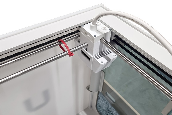

8. Cable tie
Use wire cutters to remove the cable tie that secures the print head in the front-right corner.

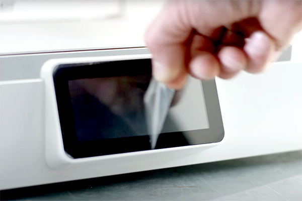

9. Display film
Remove the protective film from the touchscreen display.
