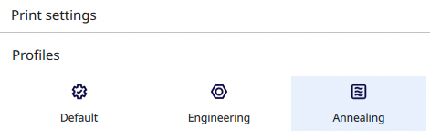

A downside of annealing is that your printed part will shrink slightly. In UltiMaker Cura, this shrinkage can be compensated for by slightly enlarging your part. This is done automatically when choosing the annealing intent profiles.

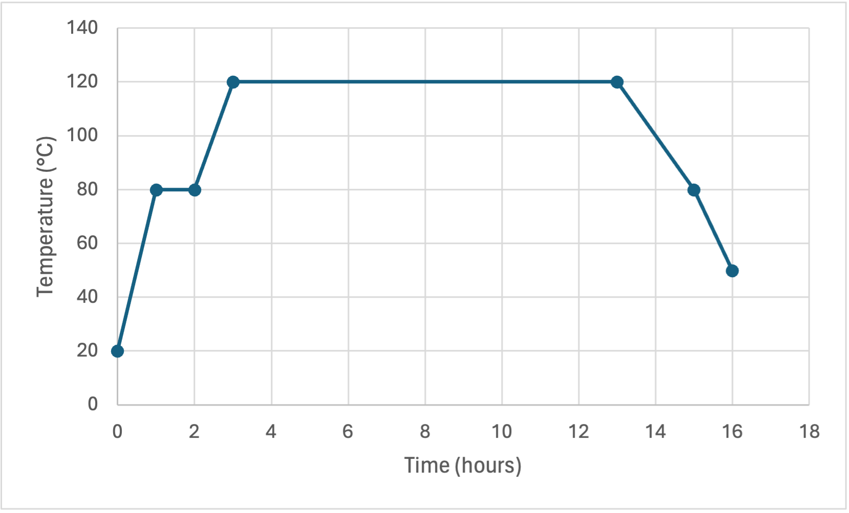

A verified annealing profile for a PPS CF sample of 4 mm thickness is depicted below. It is recommended to have a minimum of 10 hours at the maximum temperature (120 °C) to achieve increased crystallization of the printed parts. Different annealing temperatures (Tc) can be decided upon based on property preferences, but it is advised to maintain heating/cooling ramps for optimal results. High-temperature annealing will therefore result in longer annealing times.
ProcessDuration (h)Temp (°C)Ramp (°C/h)
Start(N/A)20(N/A)
Heat to Tg17555
Unstress1805
Heat to Tc112040
Anneal10120(N/A)
Cool to Tg280- 20
Cool to RT150- 30
Total16
