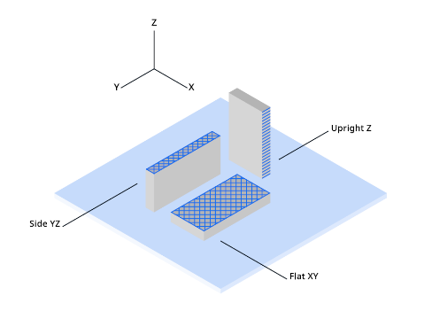

With composite materials, there is a very high anisotropy in part performance. It is therefore important to properly orient your part. Since the UltiMaker composite materials have multiple support options, it is recommended to think carefully about orienting your part.
It is important to make sure that the load is where the lines are deposited. Avoid also loading the part in the Z direction, as this typically has mechanical properties in the range of unreinforced polymers.
Tip: Avoid issues by orienting the model such that the highest mechanical forces are applied to the XY plane.
