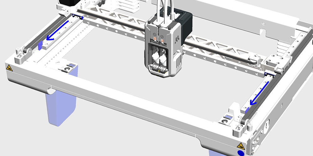

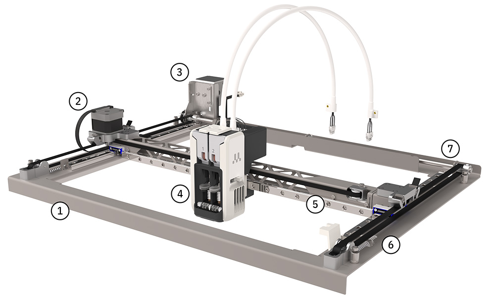

The XY motion system (also known as the gantry module) controls the movement of the print head in the Factor 4. The print head is mounted on the X beam; it moves left and right along the X axis. The X beam itself is mounted on linear guide rails on both sides of the gantry's base plate and moves back and forth along the Y axis during printing, as well as during other operation, calibration, or maintenance actions.
  1. Gantry base plate
  2. X motor
  3. Y motor
  4. Print head
  5. X beam
  6. Y tensioner and belt (right)
  7. Motion shaft with pulleys

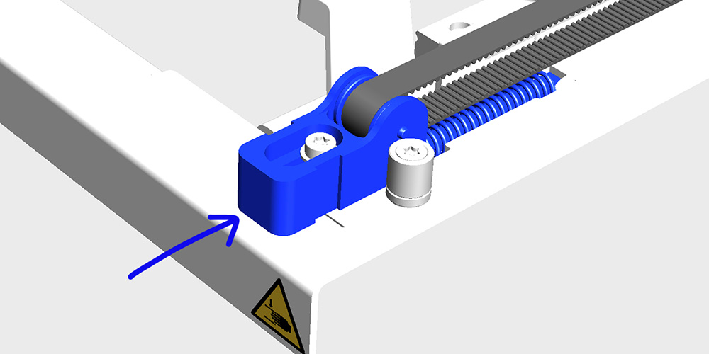

  • Loose belt wedges: This is related to the belt slack mentioned above. The belts in the XY motion system are open-ended, and each is secured with a small wedge. There are two wedges on each carriage (four in total for the Y belts). To prevent the Y belts from losing tension over time, the wedges should be firmly pressed down. First, loosen the screw in the Y tensioner to activate the spring. Then push down on each individual wedge to fully seat it. You can simply use your thumbs, or, if pressing with your thumbs is uncomfortable, you can use a blunt, non-damaging tool (such as the handle of a screwdriver) to assist. Do not use clamps, pliers, or any sharp or striking tools, as these may damage the component. A force of 80 N is recommended, but if a force gauge is not available, simply push down as hard as possible.
Note: This is only needed once (not a regular maintenance action), and is recommended for any Factor 4 printer in use since before August 2025, or after replacing the belts.

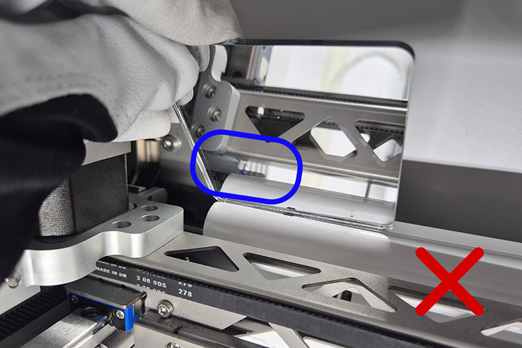

Checking whether the X beam is properly aligned is straightforward once you know what to look for. A slight skew may not be visible when looking at the printer from a distance, so a hands-on check is required. To assess alignment accurately, you will need to manually move the X beam to the back of the gantry and inspect its position relative to the mechanical end stops on both sides. You will need a small mirror for better visibility; one is included in the Factor 4 Maintenance Kit.

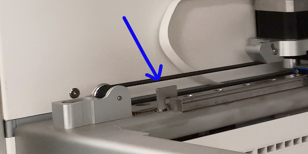

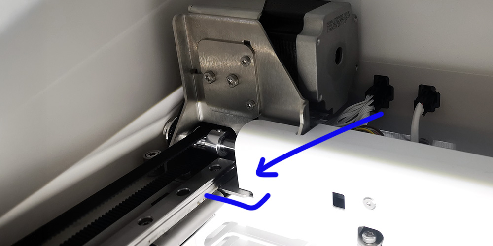

In addition to the optical limit switches used for homing the print head, the gantry system includes fixed mechanical ‘end stops’: physical features of the gantry's base plate that prevent the linear bearings from sliding off the Y guide rails.
  • Front end stops: On the front of the gantry's base plate, a small metal tab is located on each side, just before the end of the Y rails. The front tabs prevent the X beam from moving too far forward.
  • Back end stops: At the back of the base plate, on each side, there is a small corner just beyond the end of the Y rails. When the X beam is moved all the way back, its sheet metal frame should touch these corners to stop further movement.
Note: Only the back end stops should be used for checking for skew and for the recalibration (if necessary).

Note: You can check X beam alignment while the printer is powered on, as long as it is idle. Make sure that the print head and X beam can move freely (no motor tension), that all components have cooled down, and that no print jobs can start unexpectedly (e.g. remotely via Digital Factory).
  1. Manually slide the print head to the left or right along the X beam, so that it is placed roughly in the middle of the X beam.

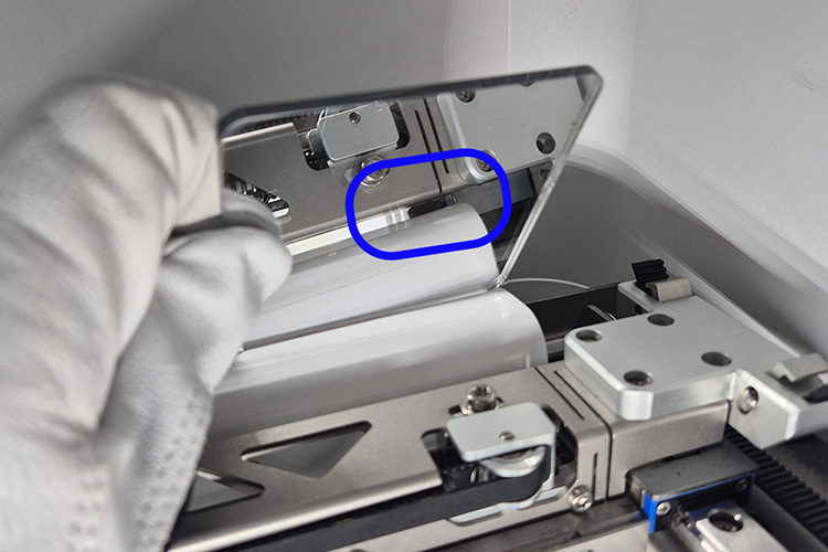

  2. With one hand on each side of the X beam, gently slide it towards the back until it can go no further and touches the back end stops.
Note: Do not apply force to only one side of the X beam. It is not recommended to push the print head; instead, push the carriages on either side above the Y belts.

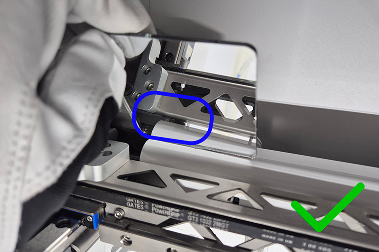

  1. Hold a small mirror at a ± 45° angle above the right side of the gantry cover and X beam, so that you can see the small tab. Check whether the X beam is fully touching it.
  2. Next, hold the mirror above the left of the X beam to check that side.
If both sides of the X beam are making contact with their respective tabs, the beam appears well-aligned. If there is a gap on one side and a noticeable difference between left and right, the X beam is skewed. Proceed to the recalibration steps.
Tip: If you are unsure if the beam is skewed or require additional assistance with this process, please contact UltiMaker Support. Please share images of the X beam position.
    Right side: The X beam is fully touching the corner at the back.Left side: The X beam is fully touching the corner at the back.Left side: There is a significant gap between the X beam and the corner at the back. Recalibration is needed.

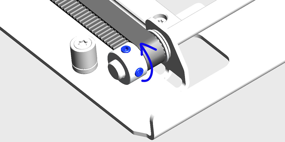

    How to manually recalibrate the X beam
    To adjust the X beam position, you will need a Hex 2 mm screwdriver and a Torx 20 screwdriver. Both are included in the Factor 4 Maintenance Kit. You will have to loosen and retighten the Y tensioners (that hold the Y belts), and the pulley on the motion shaft in the back-right corner of the motion system.
    Tip: It is possible to perform this calibration with the gantry system still inside the printer, although it can be easier to reach certain components (mainly the pulley at the back) if the XY motion module is removed from the printer first. You can find instructions on removing the gantry module here.
    1. Loosen the Y belts. Use the Torx 20 screwdriver to loosen the screws in the Y tensioners at the front of the gantry system. Firmly push each tensioner towards the back of the gantry to relieve the tension on the belts, and tighten the screws to keep the Y tensioners in place.
    2. Loosen the back-right pulley. This pulley has two set screws. Adjust the pulley's position so you can loosen each set screw, using the Hex 2 screwdriver.
    3. Move the X beam. With one hand on either side of the X beam, slowly push it all the way to the back of the gantry, making sure to apply equal pressure on both sides. Ensure the X beam is fully pressed against the corners at the back of the gantry system on both sides. A mirror can be used to check the alignment at the back, as described above.
    4. Reset the belt tension. While keeping the X beam firmly pushed against the back of the gantry, loosen and retighten the screws in the Y tensioners again to reset the belt tension.
    5. Secure the back-right pulley. Still keeping the X beam firmly in position, tighten one of the set screws of the pulley in the back right corner. Ensure that the pulley is pressed towards the left (against the spacer ring) before tightening it. If both set screws are accessible, tighten both. If only one can be reached, you can now move the X beam to the front (with one hand on either side) until the second set screw is accessible.
    6. Check the alignment again. Slowly move the X beam forward, then against the back again. Use the mirror to check that the X beam is now touching the corners on both sides. If there is still a gap or a noticeable difference between left and right, the calibration was not done successfully; please repeat the steps above.
