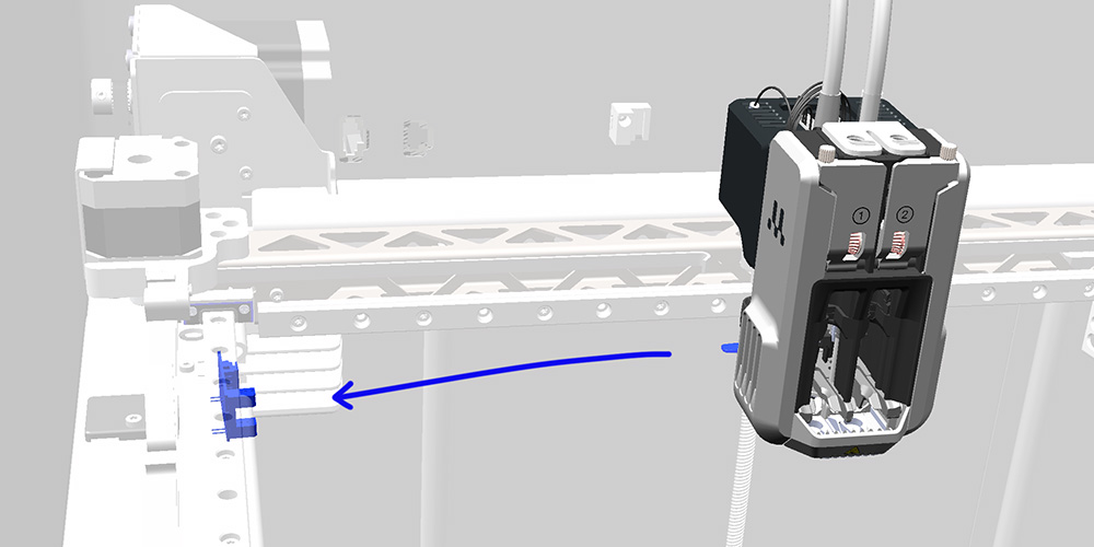

X switch
The X switch is located on the left side of the gantry. It is activated by a small tab ('flag') on the left side of the print head housing.

Broken flag
Check the left side of the print head housing. Ensure that the small tab at the side is still present and undamaged. When this part is damaged or broken off, the print head will reach the switch as expected, but it will not be activated.
If any defects are detected, this part of the print head housing may have to be replaced. If this is the case, please contact support or your local reseller for more information about spare parts and services.

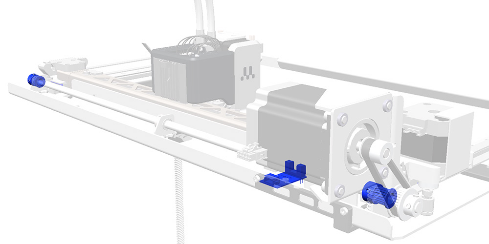

Loose pulleys
If one or more of the pulleys in the gantry system are loose, the movement of the print head may not be accurate. The print head may not reach the X switch in the expected timeframe, or it may not move at all.
For the X switch error, particularly check the pulley connected to the X motor. This is located on the left side of the X beam. Tighten the set screw if this is loose.

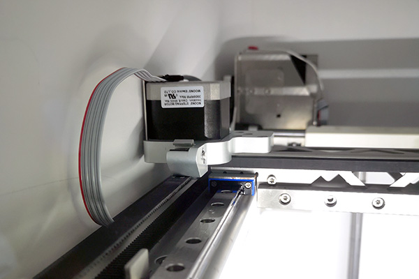

Motor cable damaged
The motor cable on the gantry system is the grey flatwire on the left side. This cable connects both the X and Y motors to the main electronics, via the socket in the back left corner of the build chamber. If this cable is damaged or defective, one or both of the motors will not work at all or not as expected.
Check the cable for damage, particularly near the X motor (connector, and where it is secured under the bracket) and the connector at the back (that plugs into socket). Please notify support if any damage is detected.
Note: For further inspection of the cable, the gantry must be removed from the printer. Please contact support for advice and further instructions if the cable is the suspected root cause.

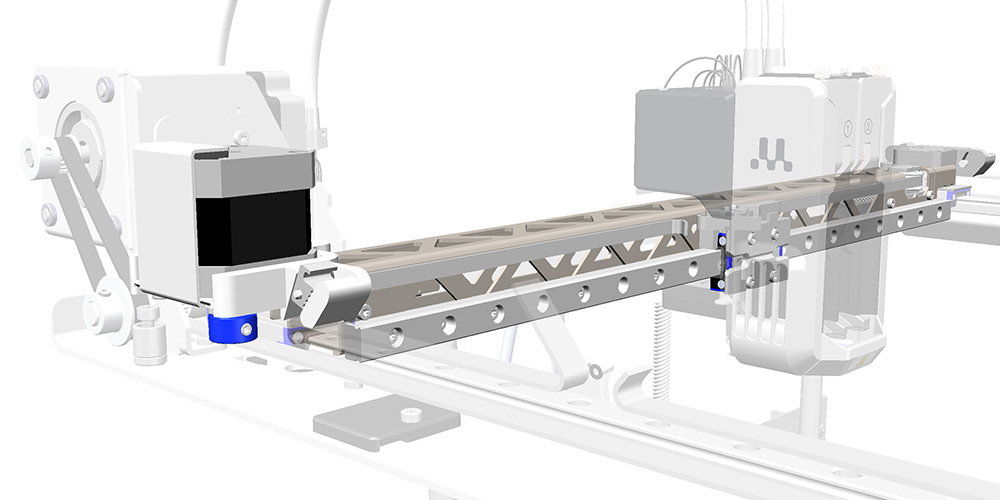

Y switch
The Y switch is located at the back of the gantry, on the left side of the cover. It is activated by a small tab ('flag') at the back of the X beam.

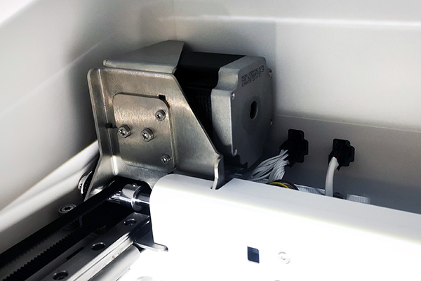

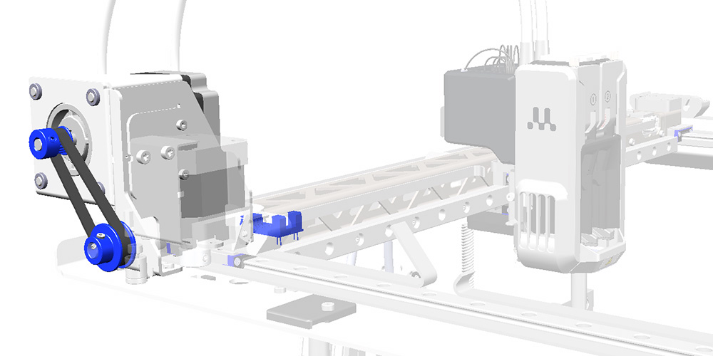

Loose pulleys
If one or more of the pulleys in the gantry system are loose, the movement of the print head may not be accurate. The print head may not reach the Y switch in the expected timeframe, or it may not move at all.
For the Y switch error, particularly check the pulleys connected to the Y motor and the motion shaft. If any of the pulleys are loose, tighten the set screw.
The Y motor is in the back left corner. There is a pulley on the motor, and a short belt connects this to the gear ratio pulley on the motion shaft. The pulleys on the motion shaft are harder to reach. The one on the right side is accessible, but the one on the right is located under the Y motor. You will have to remove the gantry module to access it. Visit this page for instructions or contact support or your local reseller for more information.

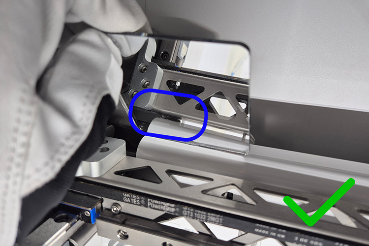

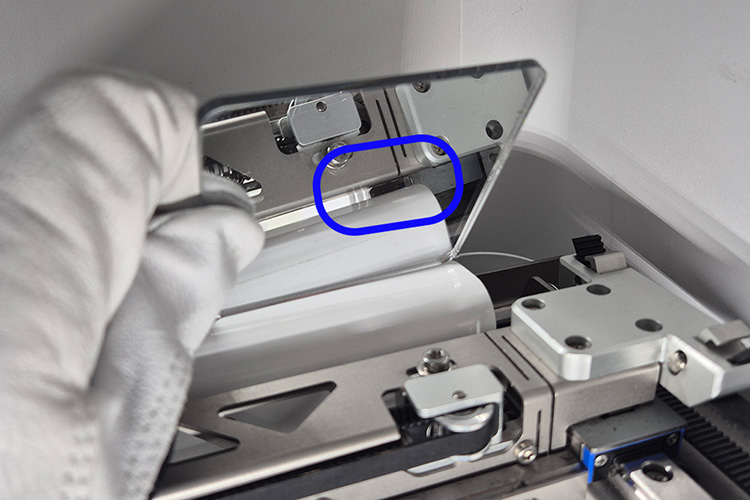

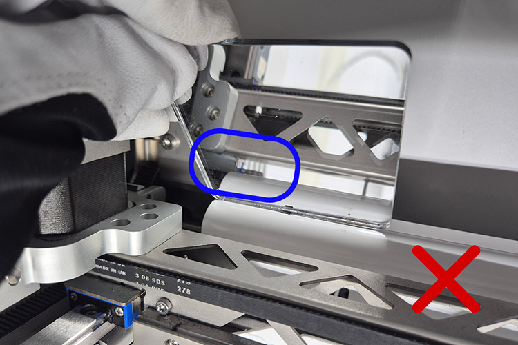

Skewed X beam
If the X beam in the gantry system is skewed, the movements will not be accurate. This may cause the X beam flag to miss the Y optical switch. This may have occurred after a print failure, such as a collision of the print head and layer shifts.
To check this, manually move the X beam to the back of the gantry system. There is a small metal corner protruding through the white plastic back cover. These corners function as mechanical end stops. With the X beam all the way to the back, check that the beam touches this corner on both sides. If there is a gap on one side, the beam is skewed and must be manually recalibrated. Learn more about X beam skew and how to correct it in this article: Factor 4 - Skewed X beam
Note: Please always notify UltiMaker support or your reseller before starting repair processes.

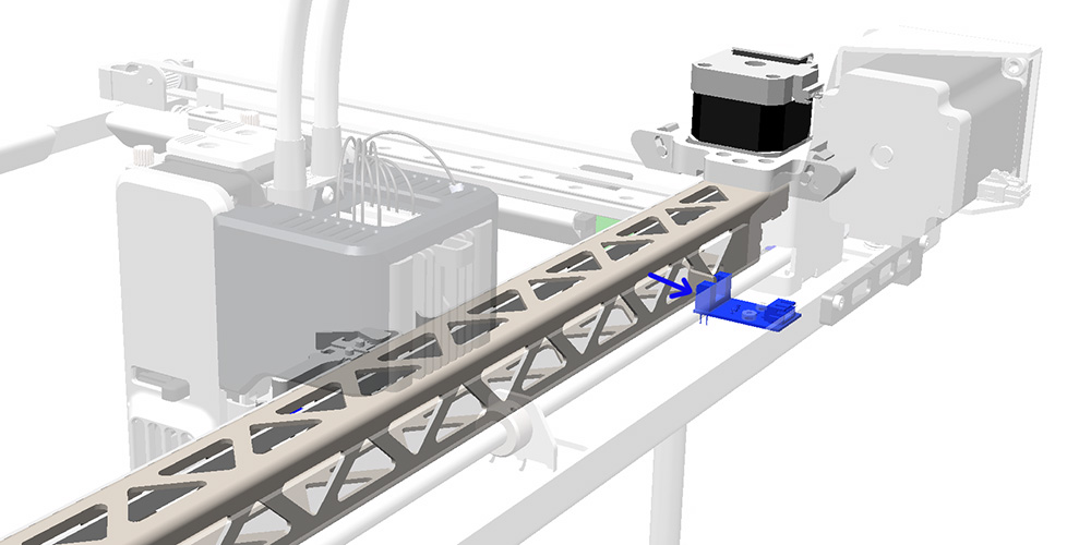

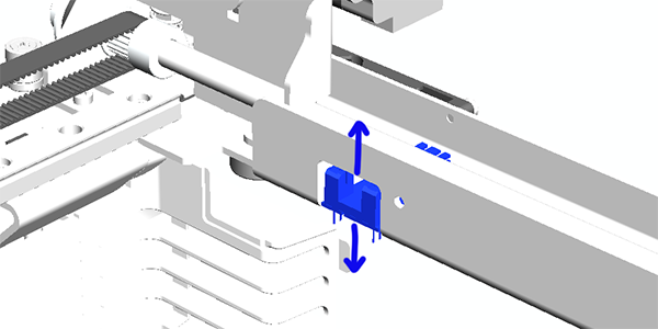

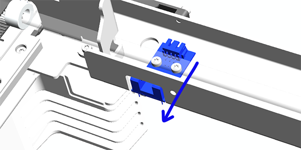

Loose / moved switch PCB
If the switch is not secured properly, it can shift a little to the back of the gantry. This means that the flag on the X beam may not be able to activate the switch properly. Carefully feel if the switch PCB is loose. You might feel it move up and down somewhat; this means that it is not properly secured. In this case, or in case of doubt, remove the gantry from the printer to correct this.
Loosen (but do not remove) the two screws that secure the Y switch PCB. Move it as far as possible to the front of the gantry, and fully retighten the screws. Reinstall the gantry module in the Factor 4.
