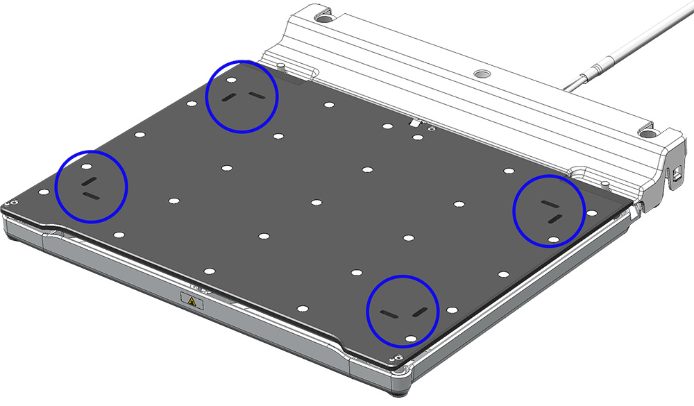

  • Magnetic build plate: Ensure that the four sets of grooves in the black magnetic build plate (see image below) are clear from debris. If there is any dirt or filament residue in the grooves, clean them with tweezers, a cotton swab, or a (handheld) vacuum.

The printer will perform some measurements during this calibration. The print head and build plate start to move and the nozzle will follow the grooves in the build plate (see image). The process takes about 5 minutes.
